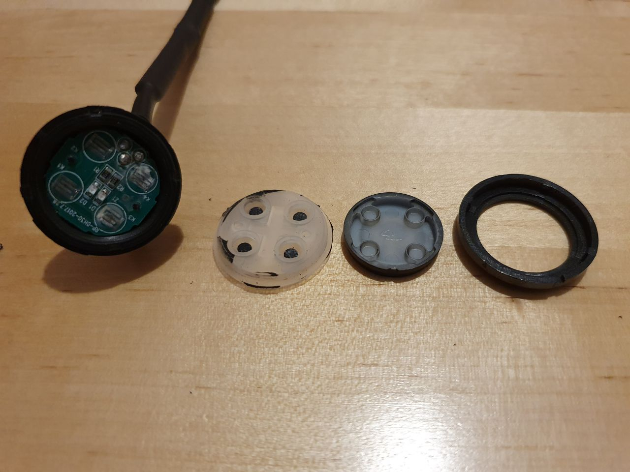

My "Start" button is not waterproof.
vlad_vy
- Beiträge: 130
- Registriert: Fr 30. Sep 2022, 15:53
- Roller: Tromox Mino
- PLZ: 1
Re: Tromox Mino
Tromox MIno "Start" button.
