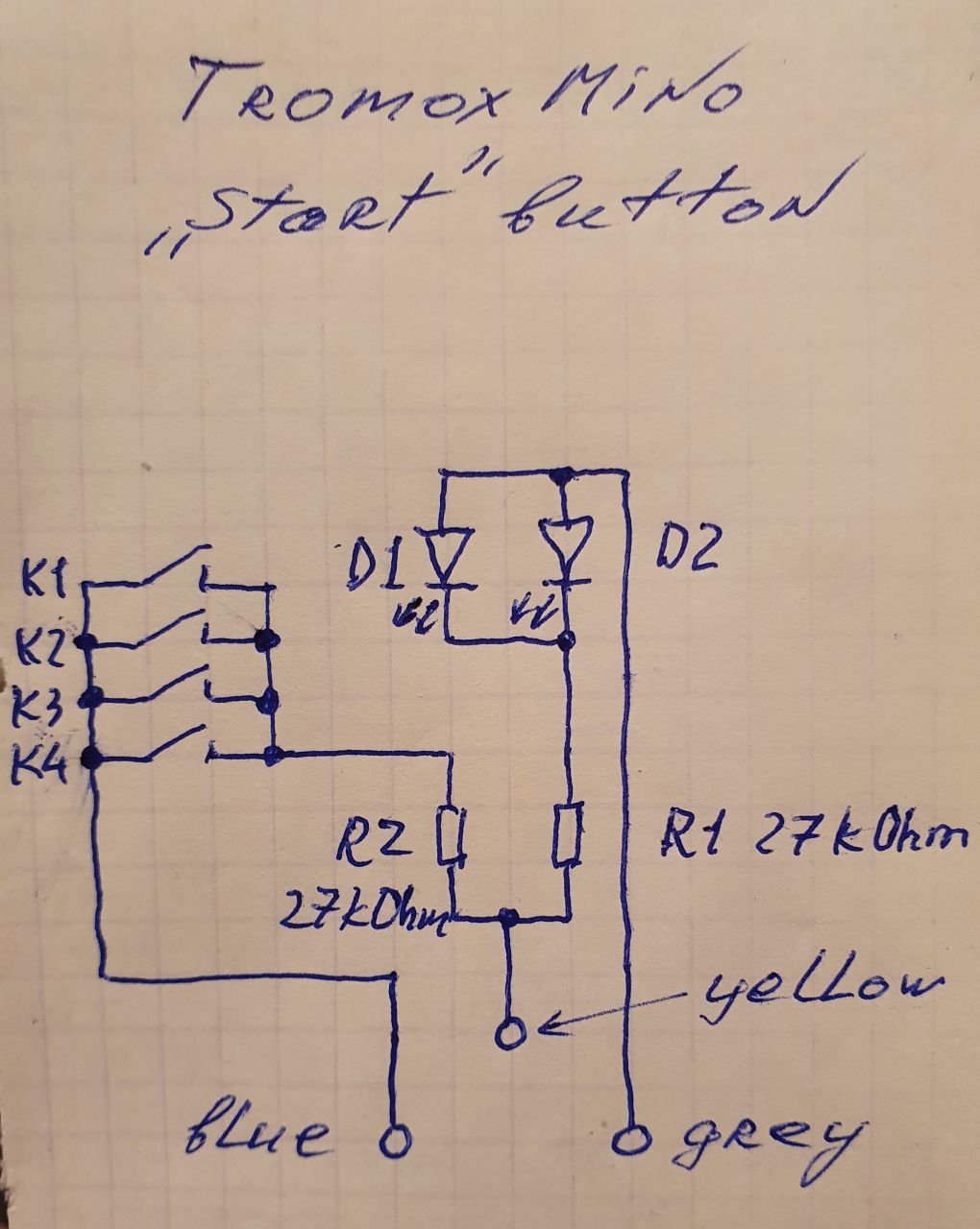

My "Start" button is not waterproof. :(

Tromox MIno "Start" button.
