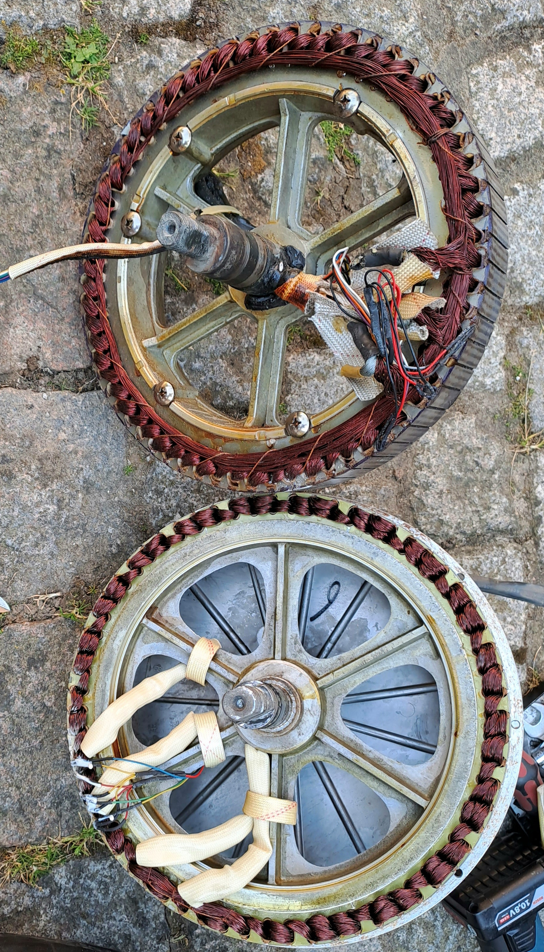

Thank you, I suppose it is 'reassuring' to see this happens and the motor lives!
It makes me wonder more if there is a bearing tolerance issue, and the axle has sagged a bit, and is running tilted. Or may be it is some of that, and also the rust under that magnet has lifted it.
I will figure this out. I think those things are manageable, but I have some anomalies with the windings too.
Before I dive into that, I'll take off the other cover plate and inspect both sides of the windings.
If you have any tips on how to remove the other cover plate off its bearing, I'd be grateful, thanks.

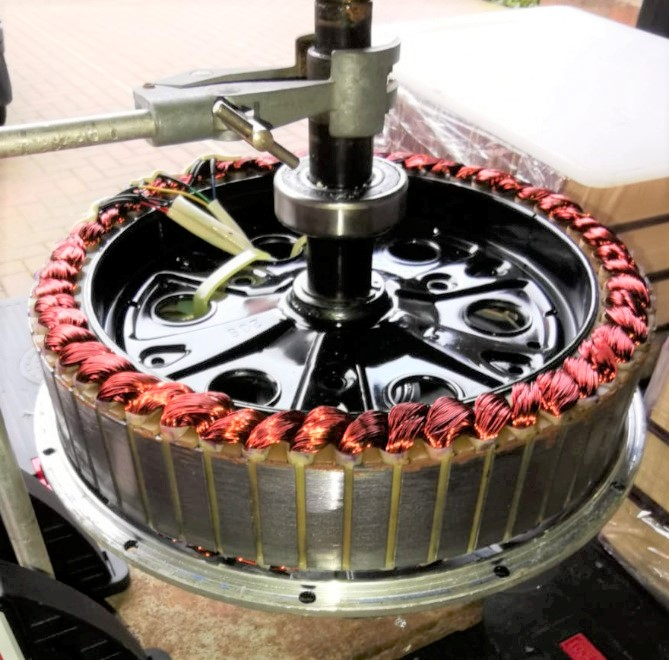

Worn-out bearings made one of my 5kW erider Motors go zingzing ever stronger, so I replaced it with my second motor and took it apart. I took the stator to a friend with a big lathe in his shed, and stuck the stator in there, gripping the axle. And lo and behold, the stator itself was off-center by about 1 mm, and who would have believed it, the highest point had the scratches from the hitting magnets!
We turned away the excentric shape, turning it into a true centric stator. After that came the coating with clear coat to inhibit corrosion, a set of new bearings and seals, and I put the motor back together. The now even, though slightly larger airgap gave the motor audibly and feelably more grunt, so that was a 100% successful endeavor :D

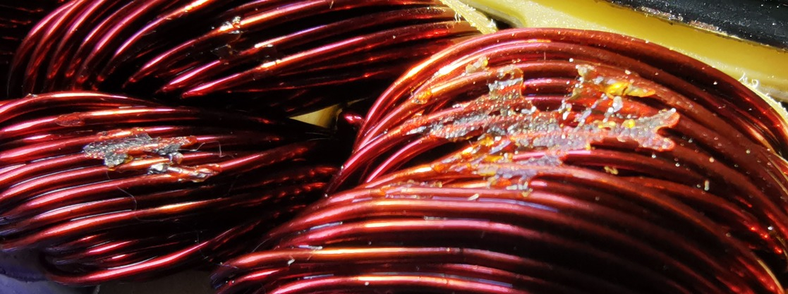

I now mention the 3rd anomaly I have seen in my motor.
I notice now, on the photograph close up at the bottom of page 3 of this thread, these details;
WhatsApp Image 2025-01-27 at 21.32.03.jpeg (54.72 KiB) 394 mal betrachtet
WhatsApp Image 2025-01-27 at 21.32.31.jpeg (102.77 KiB) 394 mal betrachtet

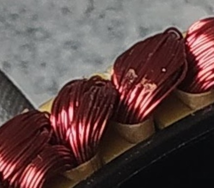

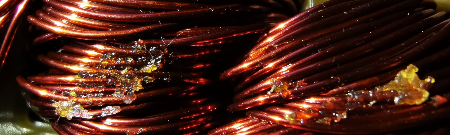

I looked again because I also have these features, and I wonder if they are a short, and where the enamel has melted? These photographs are from my motor;
Are these shorts, or another problem? Or, normal?

Can you turn it easily, without the laminations bending and twisting? I guess you did!
I will measure both the magnet radial position and the rotor.
I think there will always be both, neither magnets nor rotor can be perfect radius. Then the largest part of the inner may touch the smallest part of the outer.
(Perhaps it is easier to make an accurate air gap with axial flux motors?)
A bigger gap will mean faster? But only a little extra gap. It is field weakening without the waste of current?
Beiträge: 19292
Re: Dismantling and repairing the motor :o
We were VERY careful with the turning, only taking 1/10th of mm off at a time, then a little more. Only the most outward lamination loosened slightly.
The slightly bigger gap caused more torque, not more speed. Possibly because it increased the "hunger" of the magnetic field, more than was lost in field strength.
