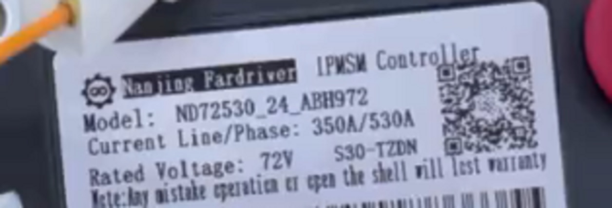

Am I likely to get a 'Chinese fake' Fardriver controller, or are the Fardriver controllers already Chinese copies of something else? :? Does this look 'real' -

Fardriver IS a Chinese Company ;)

I was trying to figure out if the Chinese are now copying the Chinese? :D
A lot of Chinese companies have now figured out how to make quality products, but other companies might try to imitate those better products without doing the job well.
