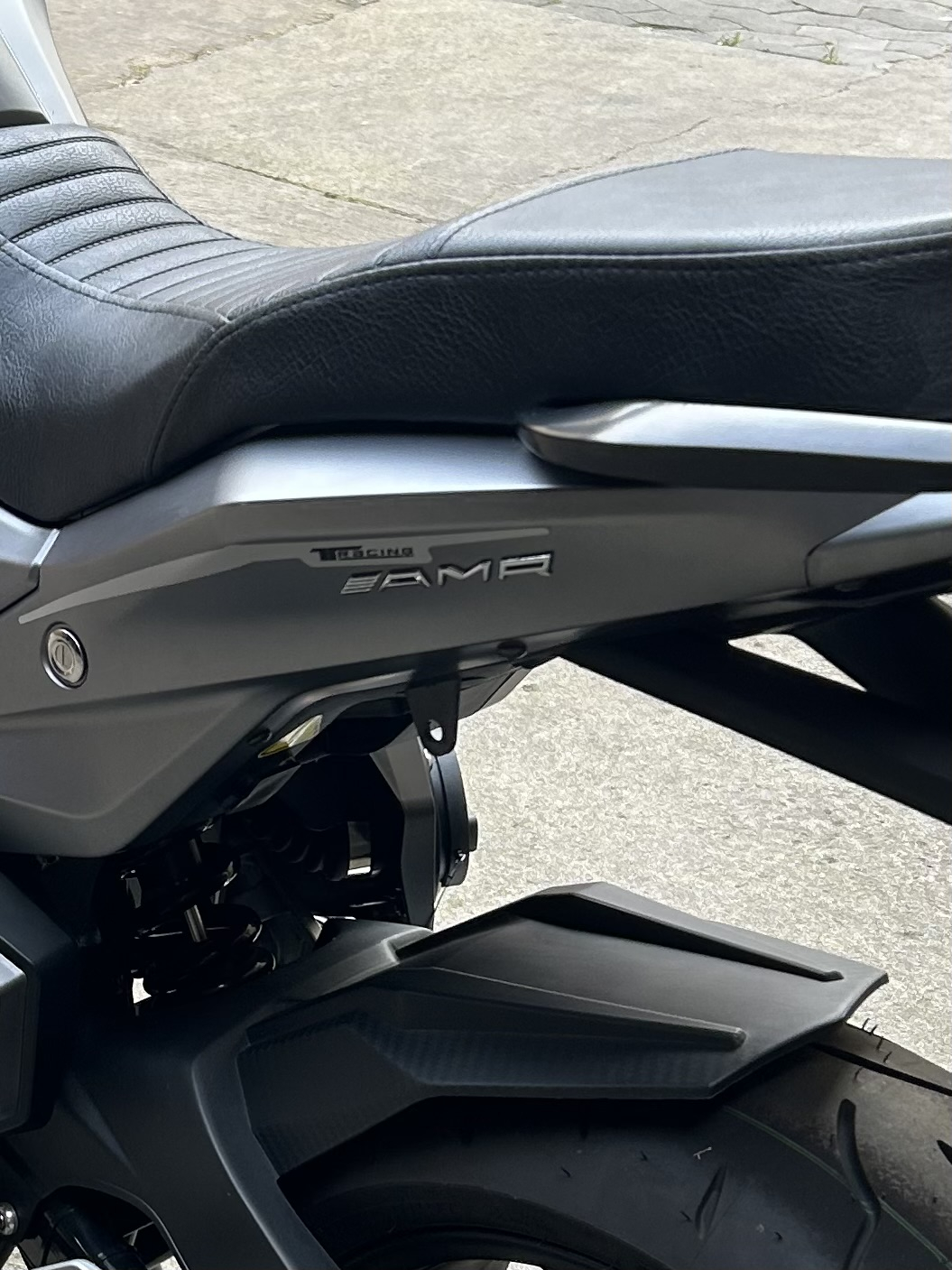

Re: Rekuperation (EABS) einstellen
Das hätte ich jetzt nicht erwartet....
Sieht aber schon etwas anders aus:

QS motor used in Odin has hall sensors inside, AMR motor has encoder (8192) inside.
72530 is hall version, 72680b is encoder version. That "b" means encoder. Seller (www.far-driver.com) wrote "Generally, the factory controller is the controller of Hall version. If you need the encoder version, please tell me when you place an order. This is not common with the ordinary version"
So all models you can buy as hall version (72490b was made for QS165), maybe you can buy 72530 as encoder version but I did not see that anywhere and it will not work with QS motor used in Odin.
I tried 72330 but it did not work with my AMR motor.
So yes, controller and motor has to match (hall - hall / encoder - encoder).
