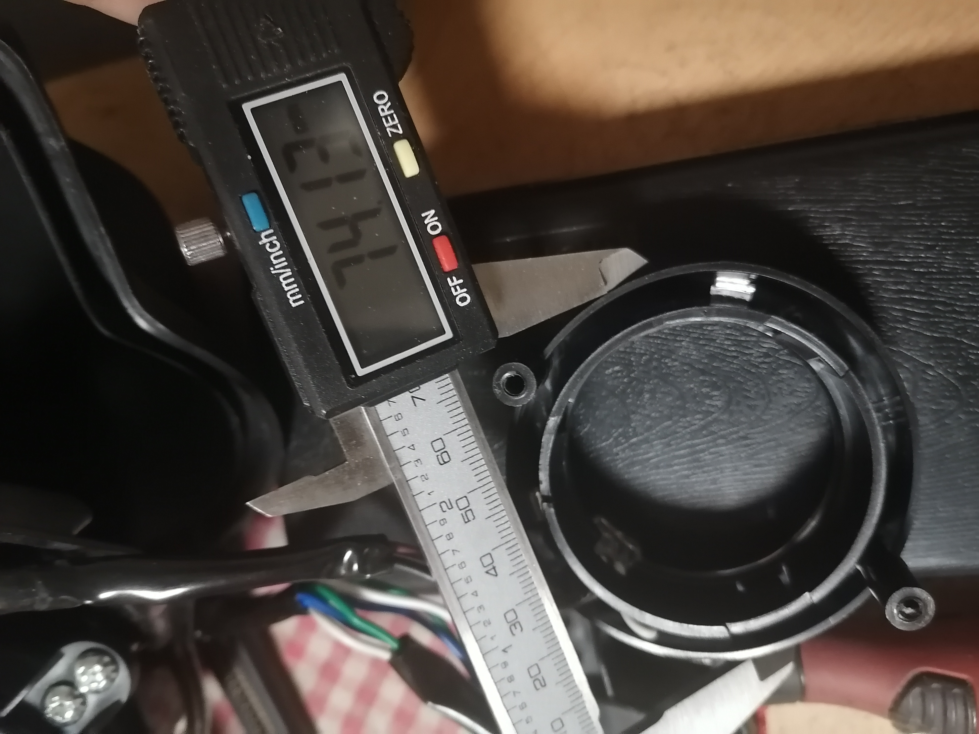

Headlights. Has anyone upgraded it yet ?
I did some photos, it may help somebody.
Sorry for quality, I was in a hurry.
Bulb is pretty small and also there is not much space behind it (about 70 mm) and smallest 2,5" bi-led projector are about 135 mm so it depend how much space is behind back plastic cover where are all wires. It could be a not so easy job to fit bi-led projector in so I rather measure twice before I spend lot of money.
I have found some LED boards but nothing specificaly for motorcycle/car high beam/low beam headlight but that factory lights works as "L1 and L2 connected to switch wires" (+ angel eyes) so I will look for anything with similar PCB.
