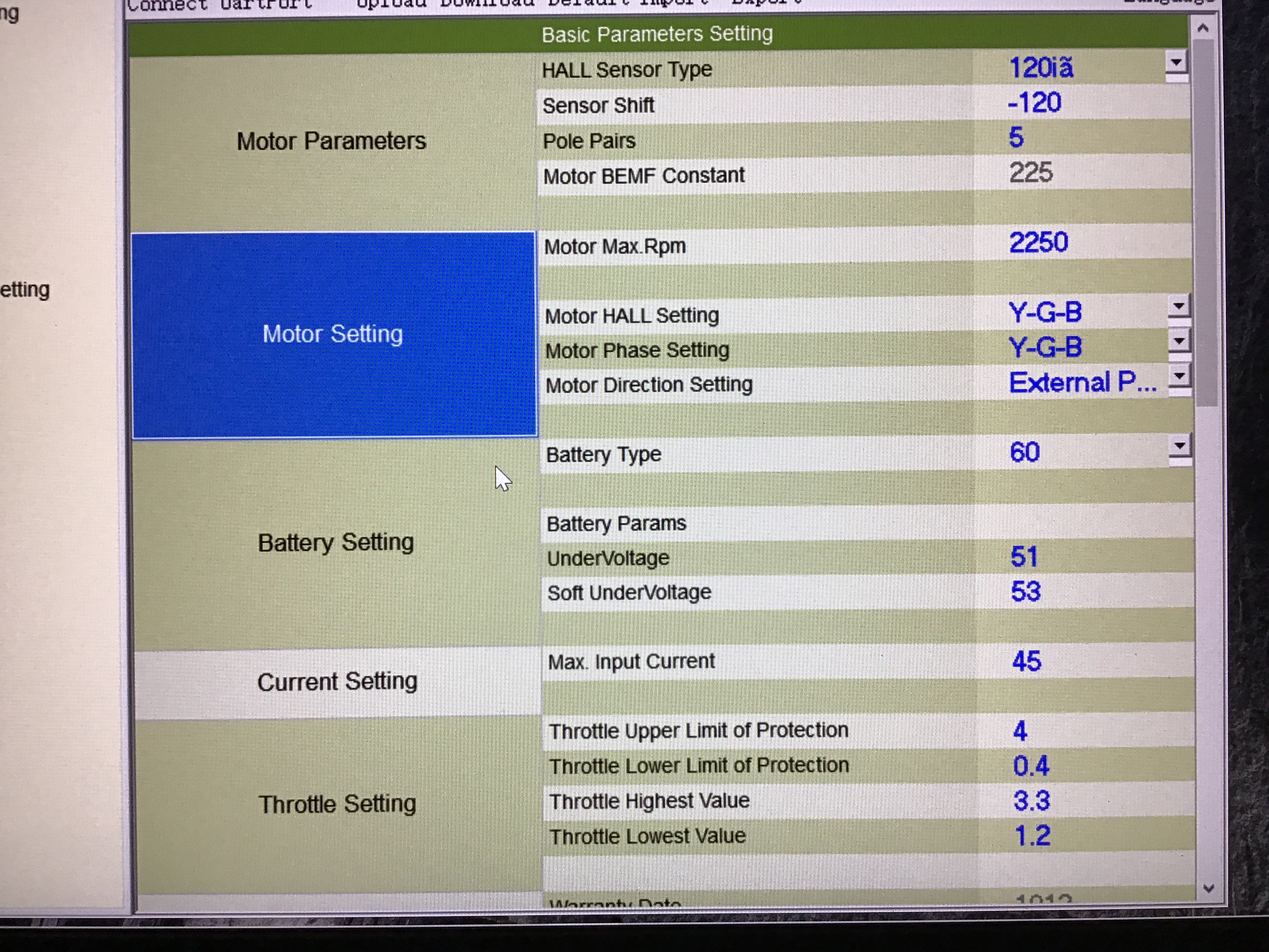

Can you also post pictures of all parameters?

I am a little confused. The parameter motor design rpm does not exist if I download the data from the standard controller 60122. Is it the Motor Max RPM you changed to 1890???

You have different controller. The OEM controller LBMC060122HK3AEU-M6 (LBC136.001D) has "Motor Design RPM" (rated motor speed, at rated voltage 63V, 3.7V * 17 = 62.9V). "Motor Max. RPM" is motor speed witout load, at rated voltage 63V. It's all with "High-Speed Percent" = 100, "Flux Max.Peak Current" = 0.
Some controllers have "Motor BEMF Contstant", and others have "Motor Design RPM".
Controller FOC file, offset 001Dh: A0
: (bit 6 = 0, Motor BEMF Constant)
: (bit 6 = 1, Motor Design RPM)
This value can't be changed.
You can see my settings for Tromox Mino with controller LBMC072122SHK3AP-M29 (LBC100.029D).
viewtopic.php?f=163&t=22468&start=230
Max. possible speed for "Tromox Mino" = 58km/h, for "Tromox Mino B" = 58km/h*449mm/410mm=63.5km/h.

I have the OEM controller LMBC060122HK3AEU-M6 (LMBC 136.001D)!

With original controller I have the same setting as with LBMC072122SHK3AP-M29 (LBC100.029D). Right now checked old screenshots and FOC file. LB GUI v121.20.2300.
0206h: 08 CA : Motor Design RPM (2250)
0208h: 08 CA : Motor Max. RPM (2250)
The speed determining parameters are the high percentage (130 %) value and the flux max peak current (30).
High-Speed Percent = 110, Flux Max. Peak Current = 10 (original Tromox Mino settings, 10% acceleration, 46*1.1=50.6km/h)
High-Speed Percent = 120, Flux Max. Peak Current = 20
High-Speed Percent = 130, Flux Max. Peak Current = 30
Anyway, acceleration enabled only if High-Speed Percent > 100.
"Motor Design RPM" / "Motor Max. RPM" define torque that controller use for maintain speed. Optimal value for Tromox Mino = 0.84, or 16% of the speed slip (69 km/h without load and 58 km/h with rated load). I determined this by experimental measurements. Any deviation from this value does not give positive results.
