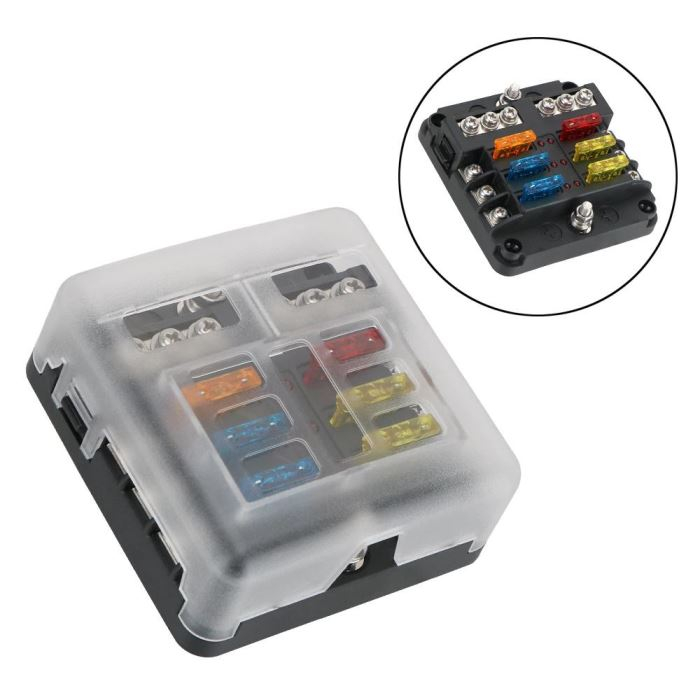

Pinky hat geschrieben:
Mo 3. Jul 2023, 08:20
Der 12V Wandler ist draußen. Ich verzichte drauf.
If you have this DC changer, you can take 12V from black wire and ground from green wire (yellow is batt+ from controller, but measure it by yourself). I added a fuse box next to the breaker and it powers 2 dashcams with display and USB charging socket without problem.
