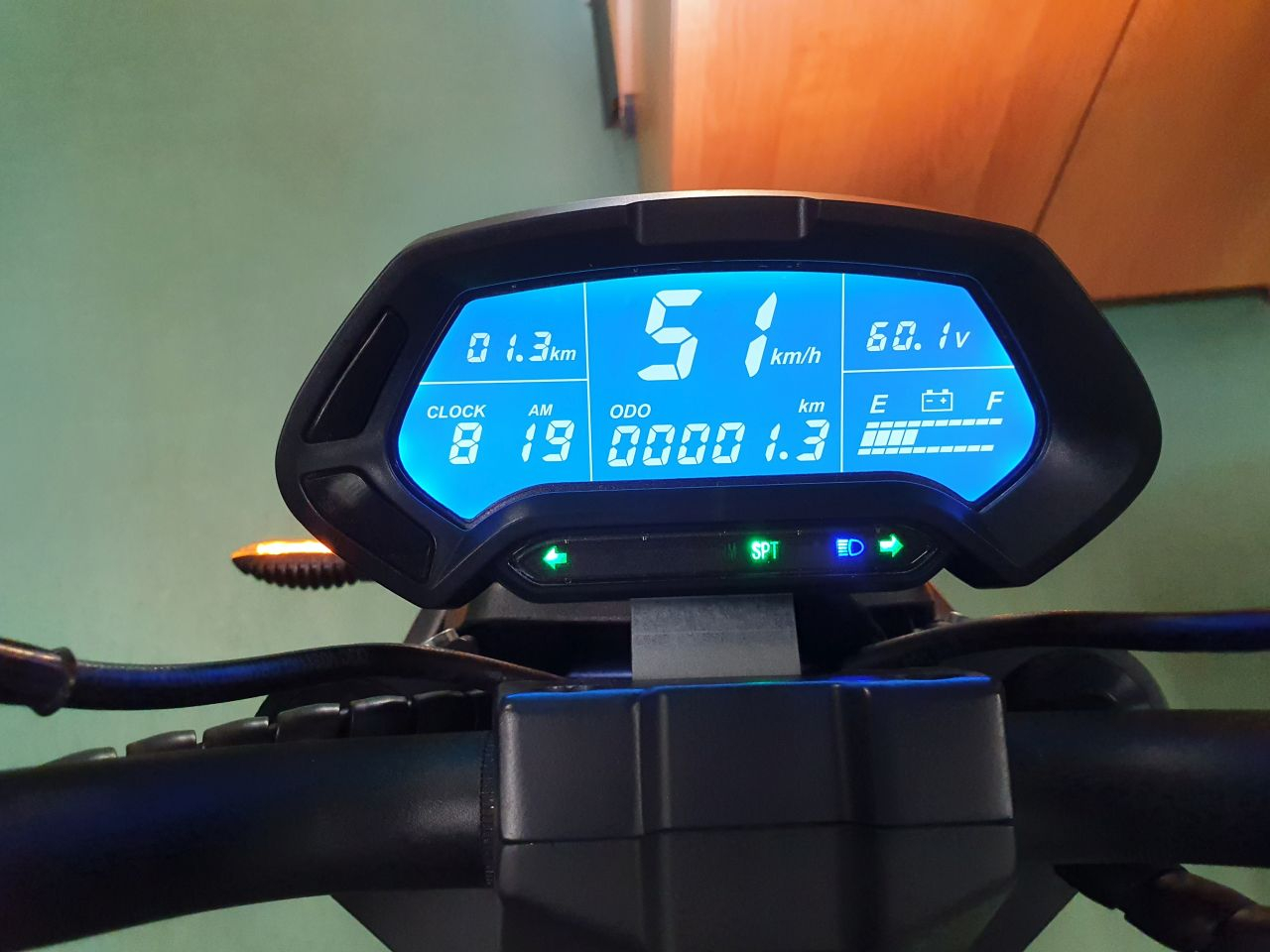

In the process of connecting the CT-22 speedometer, I found some errors in the pinout of the dashboard connector. All mentions of the connector on the forum and related documents have been corrected.
The CT-22 speedometer is fully operational (speed, odometer, clock, battery voltage, battery state of charge, turn signals, high beam). Now I need to remove the original dashboard and figure out how to mount the CT-22.

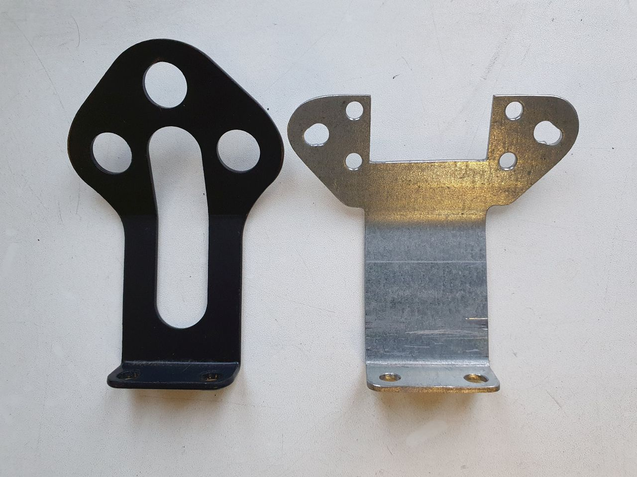

The original dashboard has been removed and disassembled. The mounting bracket from the Tromox Mino dashboard is not suitable for the CT-22 speedometer.

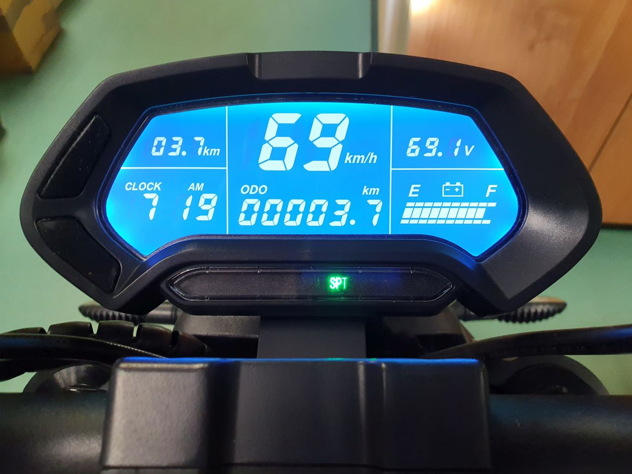

Manufactured the CT-22 speedometer mounting bracket. All speedometer indicators work, except Eco and Park indicators. The real-time clock is still running on a backup battery, the time is accurate.
By the way, the on-board computer (VCU) is no longer needed, it is dismantled and lies on the shelf.

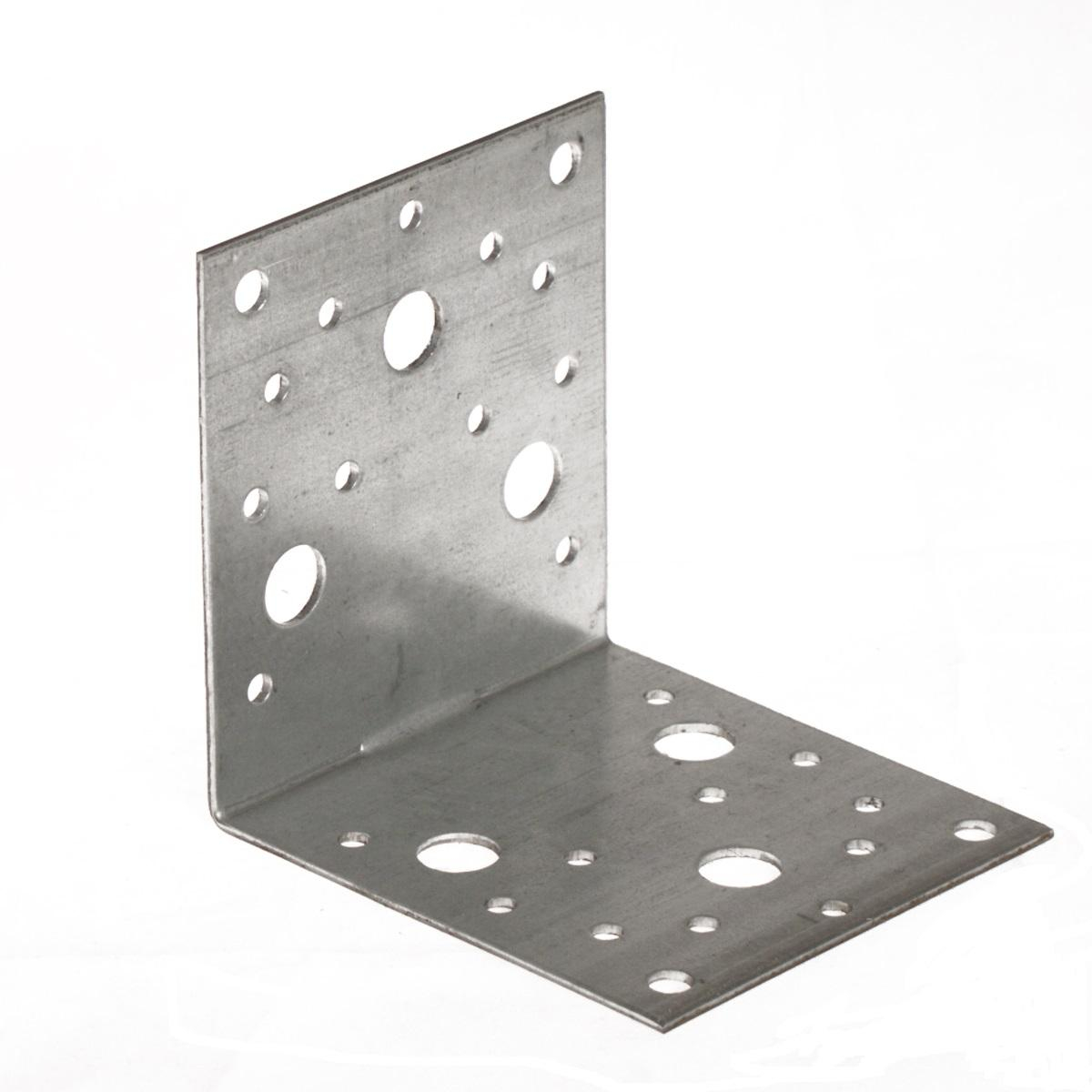

The CT-22 speedometer mounting bracket was cut out of such hardware: A perforated angular plate 105x105x90x2mm.

Speedometer mounting brackets, original and custom.

I painted the mounting bracket with black paint and finally installed the CT-22 speedometer in place.
