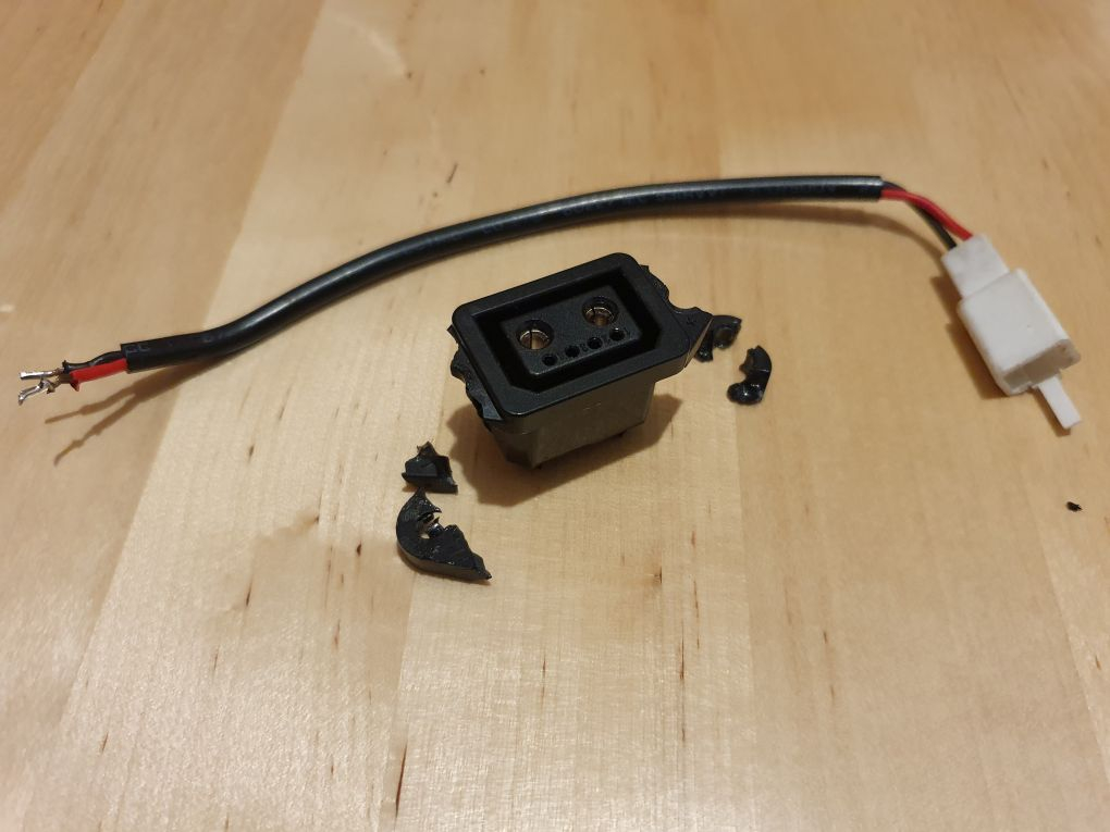

The charge connector under the seat fell apart for no apparent reason:
New connector:
