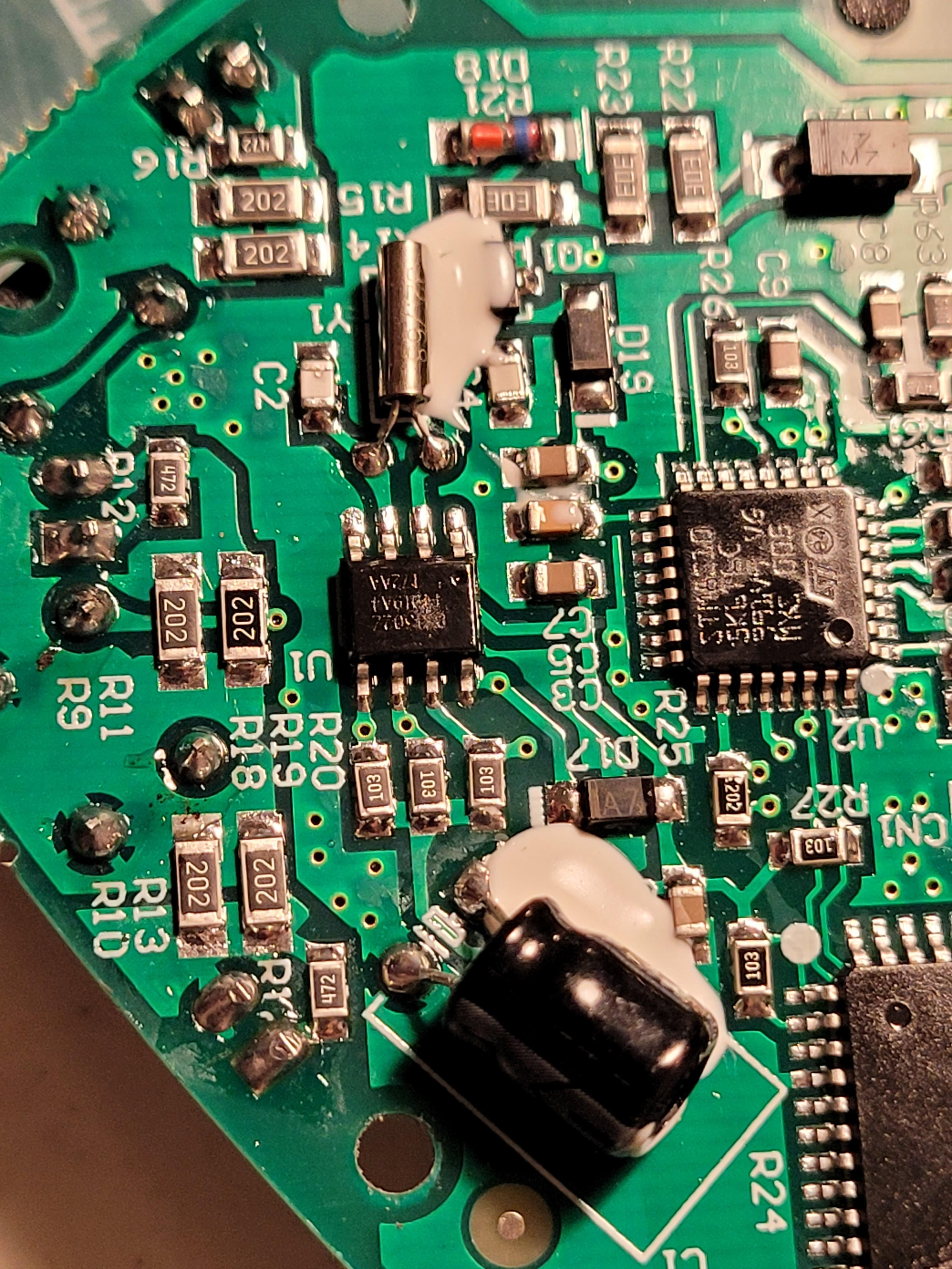

I will not use backup power wire for RTC clock (yellow wire), so I added backup battery (CP2032) to RTC chip (DS1302). I unsolder pin 8 and solder two thin wires to pin 8 (red) and GND (black). Other wire ends solder to battery holder (from old PC motherboard). The speedometer PCB has not space for battery holder, so I wraped the battery holder with foam rubber and place it in bottom part of the speedometer body, under speedometer PCB.

By the way, the RTC clock in the speedometer works without the main power supply for two days. The time is accurate. So the added backup battery (CP2032) works fine.
