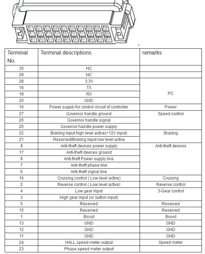

Hi everyone
I have a problem with programming this driver - HK2X or lingbo
do you know which pins are suitable for connection? in one of the instructions I get out of 13 and 23 from my factory plug which is connected and used for programming that 18tx and 19rx pin and 28 3.3V and 20 ground. lingbo software in each version gives "timeout". I have such a converter: https://botland.com.pl/pl/konwertery-us ... k-usb.html

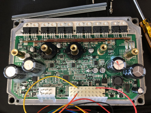

Hello sperzu,
I tried 2 USB/TTL adapters. Only the one with the chip set CH340g worked (see ebay-link) It costs only 3 €. It ist importent that the adapter use 3,3 V and not 5V.
This ist the connection plug arrangement from the Controller. I think you have to invert Rx an Tx. (18=Rx, 19=Tx) This is wrong in this template.
Michael
Michael

Re: eGrace Controller programmieren
Yes, I just bought it today and it worked TX and RX are the other way around. It works. Now the question I always wanted to ask

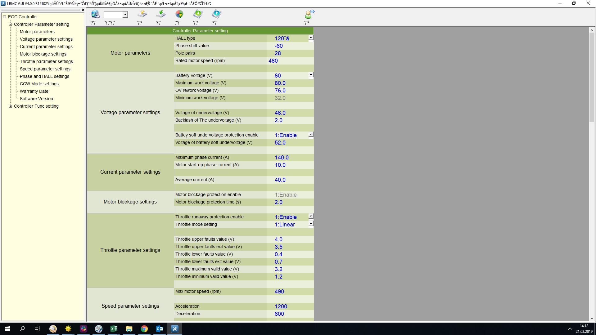

How to speed it up;) the speed limiter is turned off. can any of the parameters still change?
I have a ZNEN 60V300W 60V 35aH li-ion battery. which parameter is responsible for the max speed is there any guide to lingbo parameters? I am currently driving 50km / h my settings below.
- Beiträge: 19391
A strange question... What about fiddling with the parameters that have "motor speed" in them?
Yes in deed
Aaaaaand , I think it is useful, when you give us a picture of the whole menu. I Think the last rows are missing?!??!!
Maybe there is something important, like "max. speed" ( in km/h or m/ph ) or something else. If not, than the last row in your picture should be major.
Try to change the parameters an see if and how it works.
Please show the community your success or, unfortunately, the failure. We want to learn
Greetings, Dirk
Greetings, Dirk

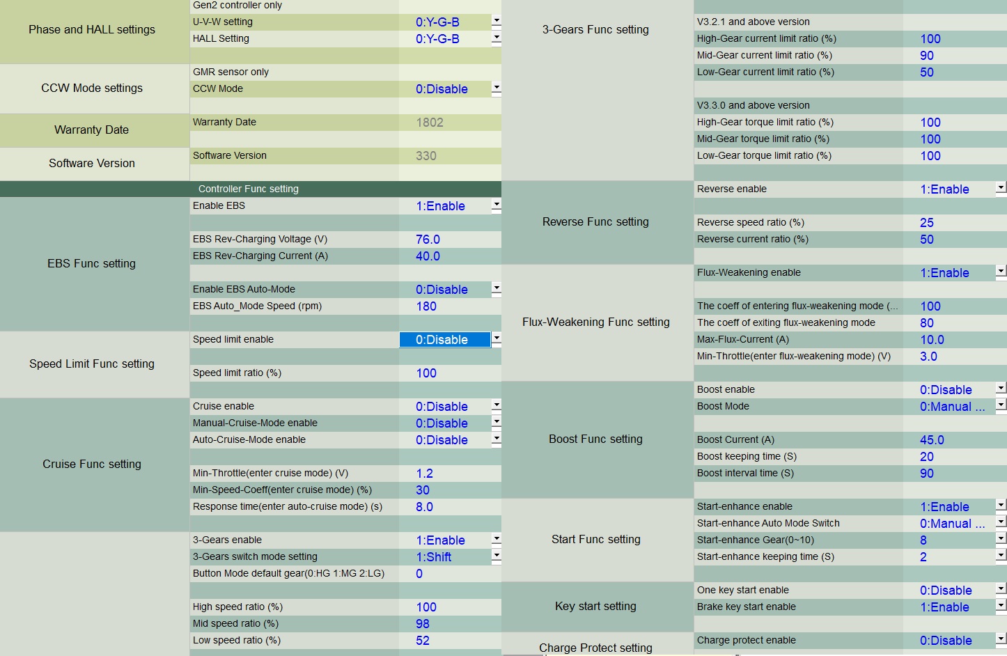

I paste the other pages from the settings below. Can a higher speed be obtained from this scooter? Is this max when it comes to this configuration?
Please guide me what I can change
- Beiträge: 19391
You have deactivated Speed limiting and activated flux weakening, which both should take away a speed limit and actually slightly increase max speed via flux weakening. But those weakening settings must be tested with care as efficiency can suffer greatly and your motor may overheat if you overdo it.
The most important point to adhere to is to only change ONE setting at a time, test the result, tune, test, and only when that one setting leads to your desired or the optimally possible result go on to the next parameter. Otherwise you might easily change counteracting values and not notice any difference, or have unexpected results without knowing what exactly caused it.
Tuning controllers is very tedious work, even with such a simple GUI...
And I hope you saved the original controller setting in case something goes completely wrong.
