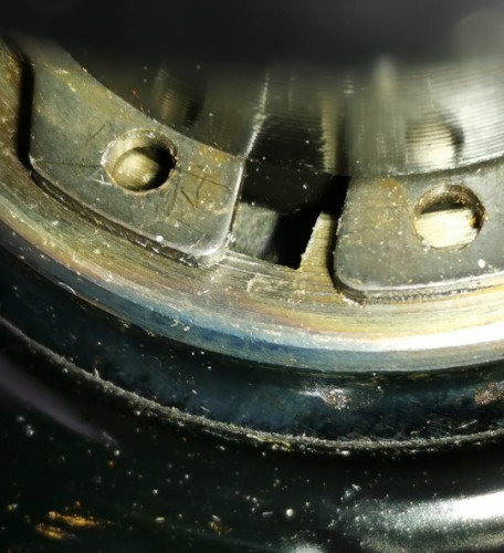

bob2.0 hat geschrieben:
Di 28. Jan 2025, 15:57
I guess maybe a woodruff key? I can take the circlip off to see what is underneath it on the shaft, if you like?
I expect something like such a woodruff key. But there must be some kind of anchor point at the stator package. I guess that's the weak spot.
It would be really nice if you can have a look underneath it and take some pictures where shaft and the steel sheet of the stator are fixed together.
Then I can estimate what it takes to fix the issue.... or just to leave it as it is now (currently without recu).

I have lost my circlip set (again!) but I could rotate it around.
There is a woodruff key in there, or at least, some sort of detent, not quite sure.

Thank you bob for taking that extra picture.
