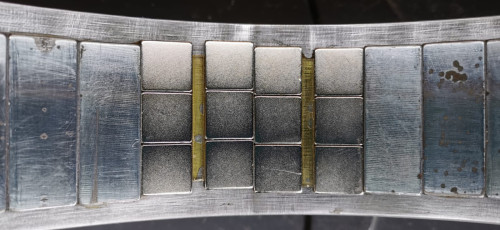

Nope, only pictures from the opened Motor and the burned phase wires and from getting new wires in, as I was working by myself.
https://www.elektroroller-forum.de/view ... 48#p316448
Thank you for the link and photos, at least they give me an insight into what I might find.

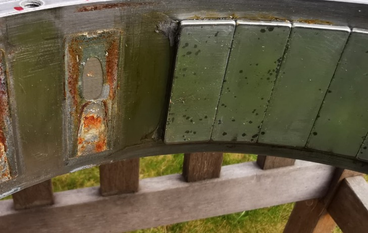

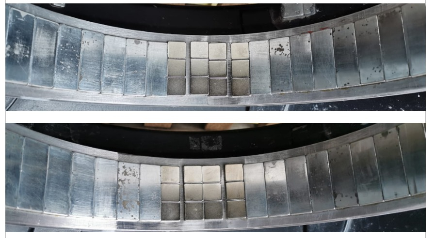

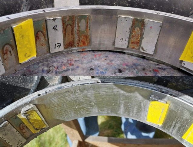

Maybe these photos and the description from TwisterMax might help dismantling the motor.
And here.
And DavidSt dismantled his motor too.
And here.
Thank you, yes, indeed.
More photos will help me do the job.
