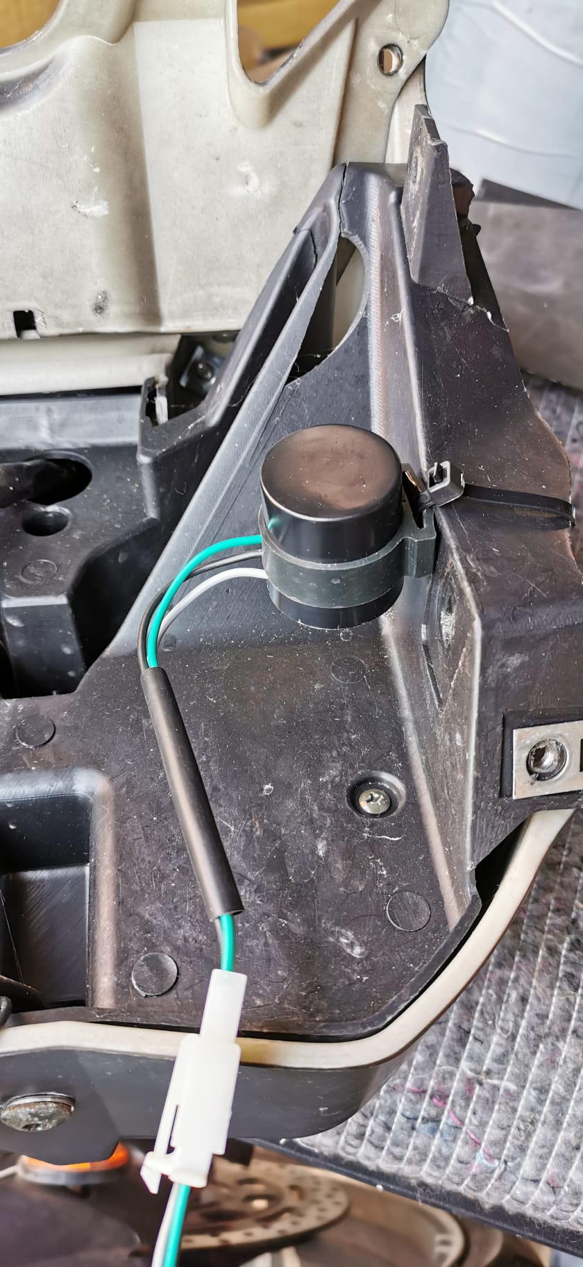

There are more robust flasher units available, and cheaper than the Dayi official offerings.
This works fine (for now, for ever? I presume it is a lower power handling), comes with a little rubber mount, and is fully potted.
