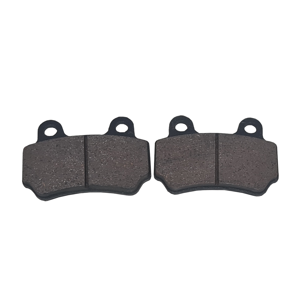

Hi guys,
I measured both front brake discs and the left one is 2 mm out (on 1/4 of disc's surface gauge went from 0 to 2 mm up and then back to 0).
Right disc was only 0,02 mm out at one section. So at least one disc is ok (but I rather ordered two new discs https://www.cmpoparts.com/part/BRDF031 from e-bay, if it will colide with brake calipers I will handle it).
But I finally got to front brake pads and I can not find it anywhere else than in gran-scooter.com - https://www.gran-scooter.com/spare-part ... 20309.html (madatshop and xscooters does not sell it at all).
Does anyone know where can I buy it ? Or even better same dimensions (70x35 mm body / 67,7x31.6 mm pad) but different brand ?
These - Reeco RL8062 B6 114901 (for front brake calipers WITHOUT red "buttons"): I have found a lot of Reeco brake pads but none RL8062 (or rl-8062).
I am very seriously thinking about replacind brake rotors with some well known brand like Brembo etc. + make a bracket for it (then also will be possible to use bigger brake disc).
Thanks for any advice.

Hello Miguello80,Miguello80 hat geschrieben: ↑Mo 1. Apr 2024, 22:50...
look for brake pads for: "Hyosung 125 GV Aquila 2000", they are the same and will fit for our E-Odin 2.0.

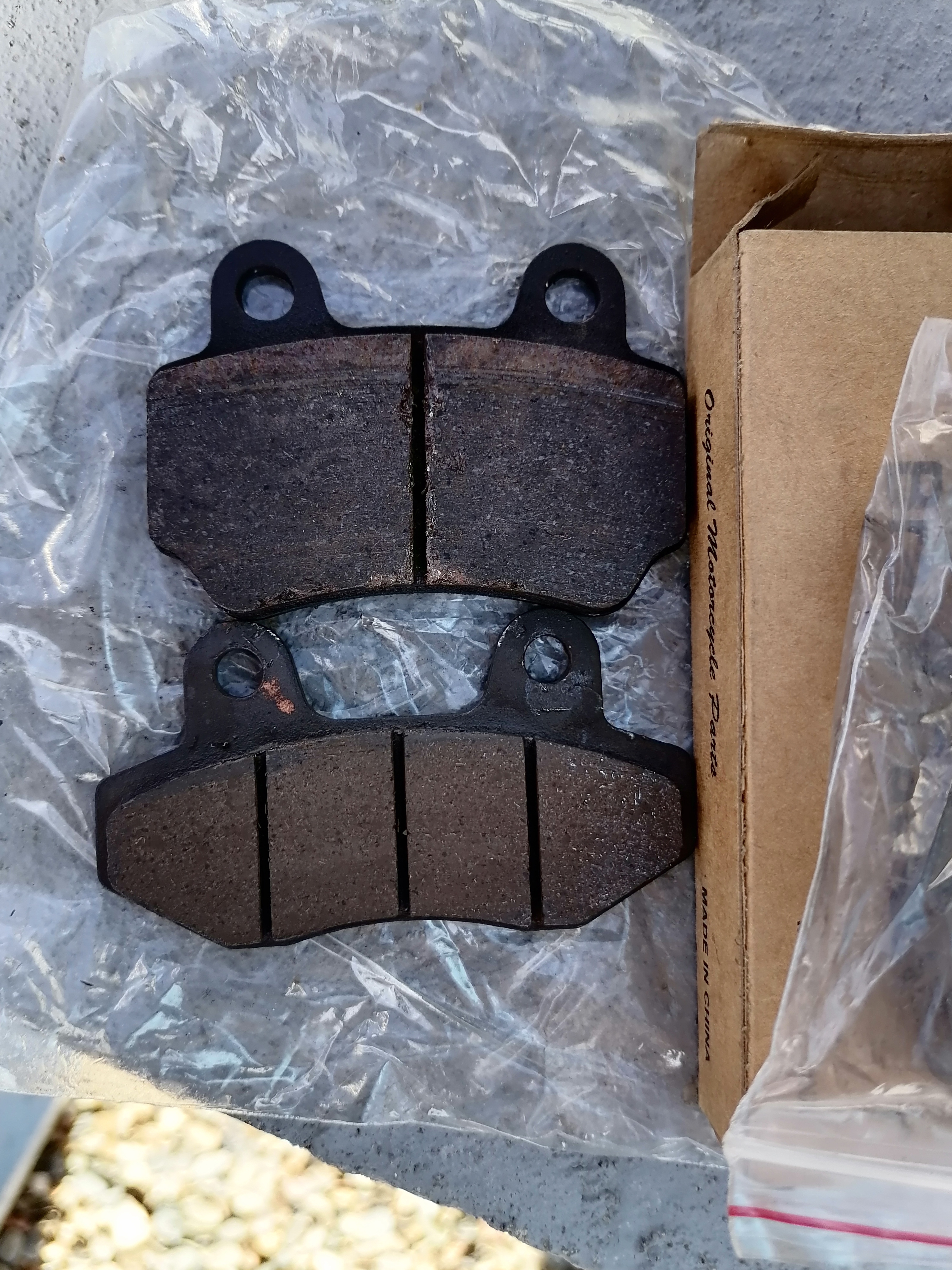

I am affraid that these fit only calipers with red buttons, not in my HSK calipers, they are wider (77 mm).jeff-jordan hat geschrieben: ↑Di 2. Apr 2024, 12:27look for brake pads for: "Hyosung 125 GV Aquila 2000", they are the same and will fit for our E-Odin 2.0.
Do you see the difference ?
yours: my: I would be happy if I am wrong

to confirm my previous post I asked my friend with calipers with red buttons to bring me his front brake pads and compared it with my front brake pads, see the photo, and as I expected it did not fit my caliper. I found a seller on Aliexpress that says "official Reeco seller" so I contacted them and they answered that they do not have these pads in stock because they supply with them OEM manufacturers directly. After I explained whole situation they offered me a custom production. But one batch is 16 pairs
Finally they said that they will make a small portion for aftermarket in less than a week.
Here is the link: https://www.aliexpress.com/store/818488 ... 2511cTPk5l - hope RL8062 will be there soon.

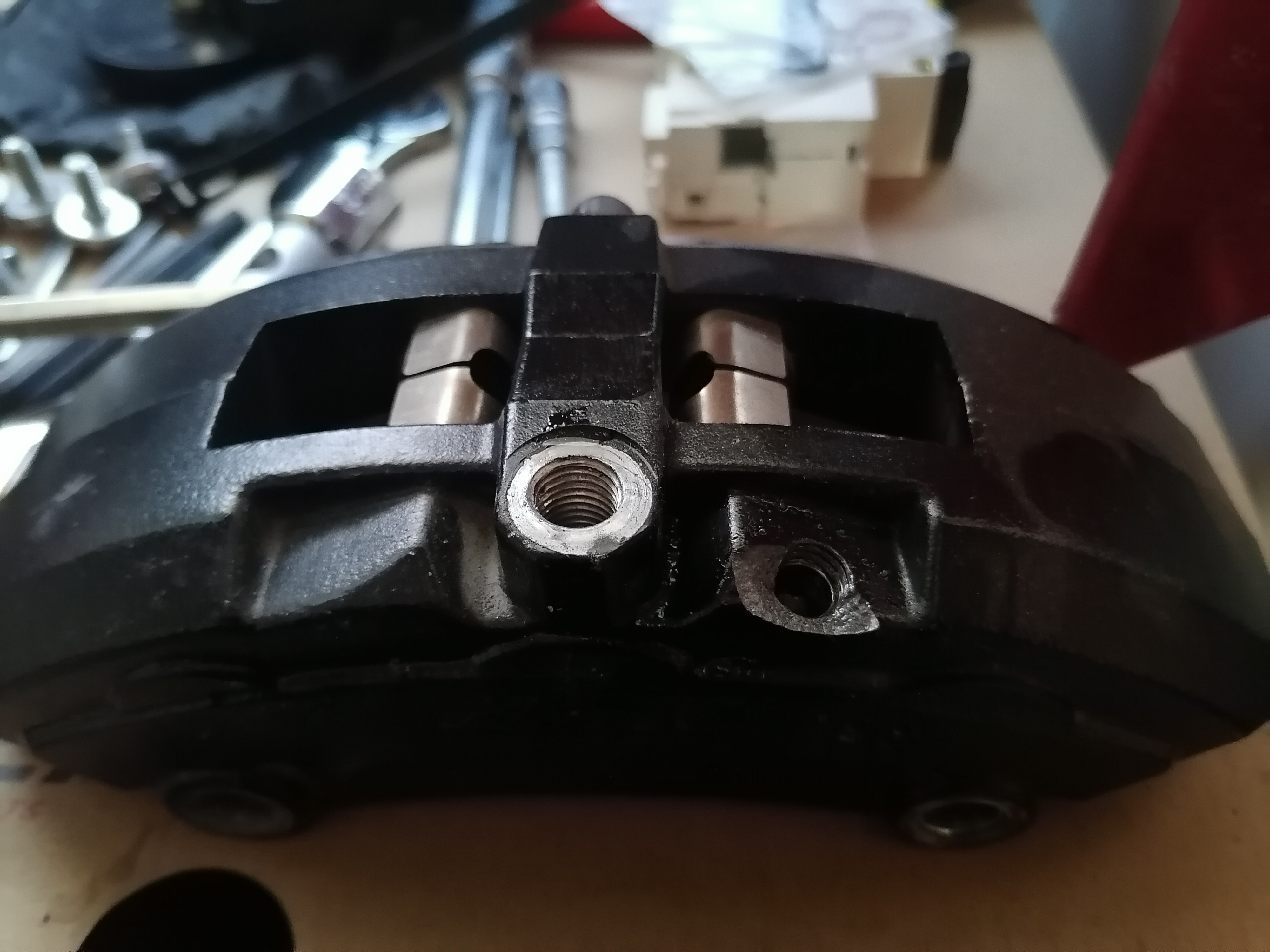

First brake fluid change after only 1200 km and pressure valve on rear HSK brake caliper broke off. I am skilled mechanic and I use a torque wrench, I would admit my mistake but this is absurde. Used alloy is very brittle, same as foot pegs. I will not mention brittle rear tile plastics and broken turn light indicators on every E-Odin I saw.
Brake caliper is impossible to repair and there is no place where to buy it! Spanish dealer Gran Scooter does not have even older version (with red buttons). German dealer Madatshop does not have it in stock at all. Polish dealer BiliBike has only older version (with red buttons, with brake lever) for 228 USD + shipping, that is nonsense.

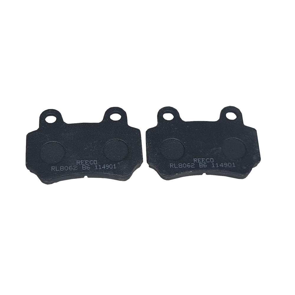

Second problem - front pads in (newer) front HSK brake calipers, Reeco RL8062 B6 114901. No place to buy it! Reeco company offered me a custom production but one batch is 16 pairs. For older version you can use same pads as for Hyosung 125 GV Aquila but E-Odin owner with newer HSK brake calipers is done. I did not checked rear brake pads because one bolt is damaged from factory so I can not screw it off so I hope there is not the same problem like with front brake pads.
How is this possible ? E-Odins are still produced. It seems that Dayi's interest ends right after the sell, no aftersell support, especially when there is a lack of dealers.

By the way I thought about why the pressure relief valve broke off and my guess is wrong position of brake hose that pushed whole time on it and stressed the alloy. And also bad design etc. I should check it sooner
Take it as an advice to check it too.

Good news is that Reeco added brake pads for newer front brake calipers !!!
https://www.aliexpress.com/item/1005006 ... Redirect=y
Damn...

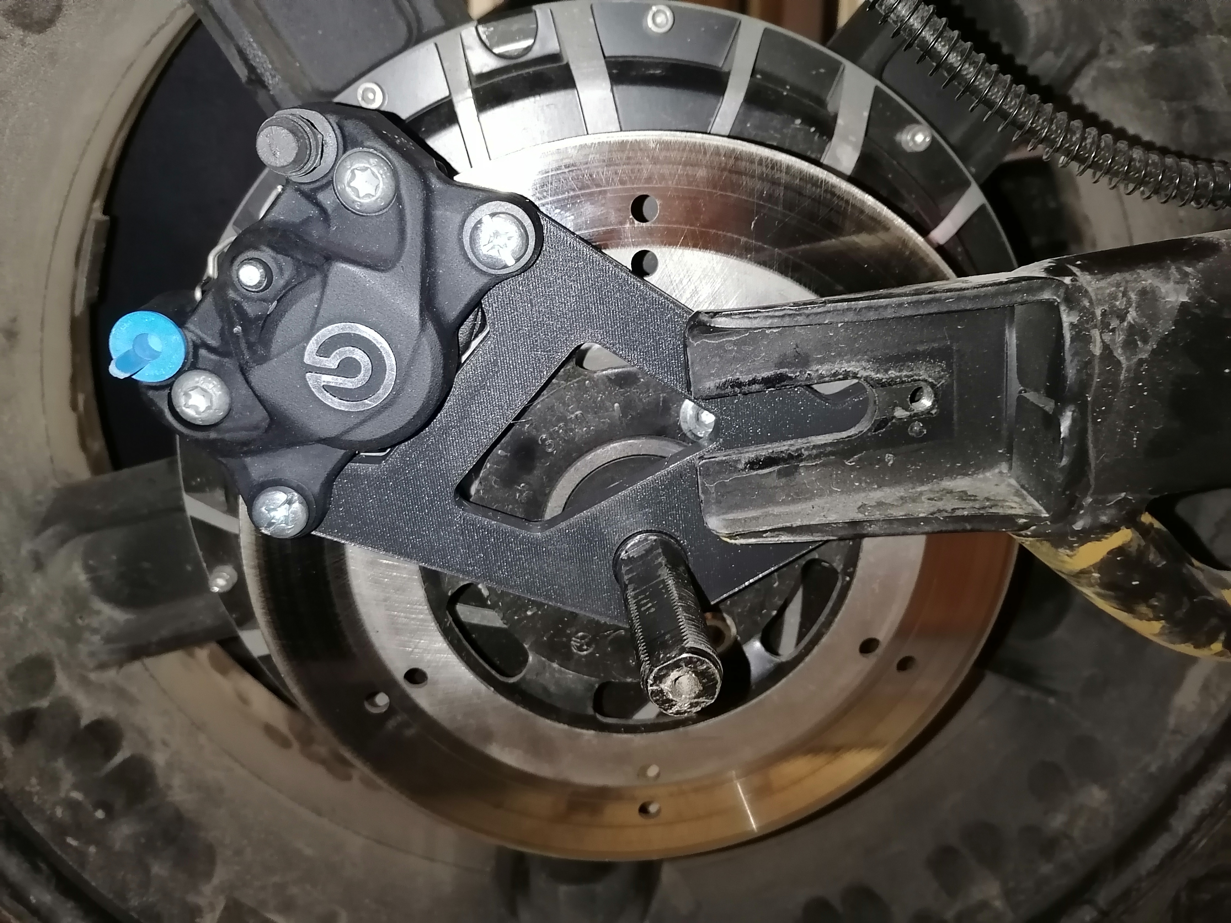

Hi guys,

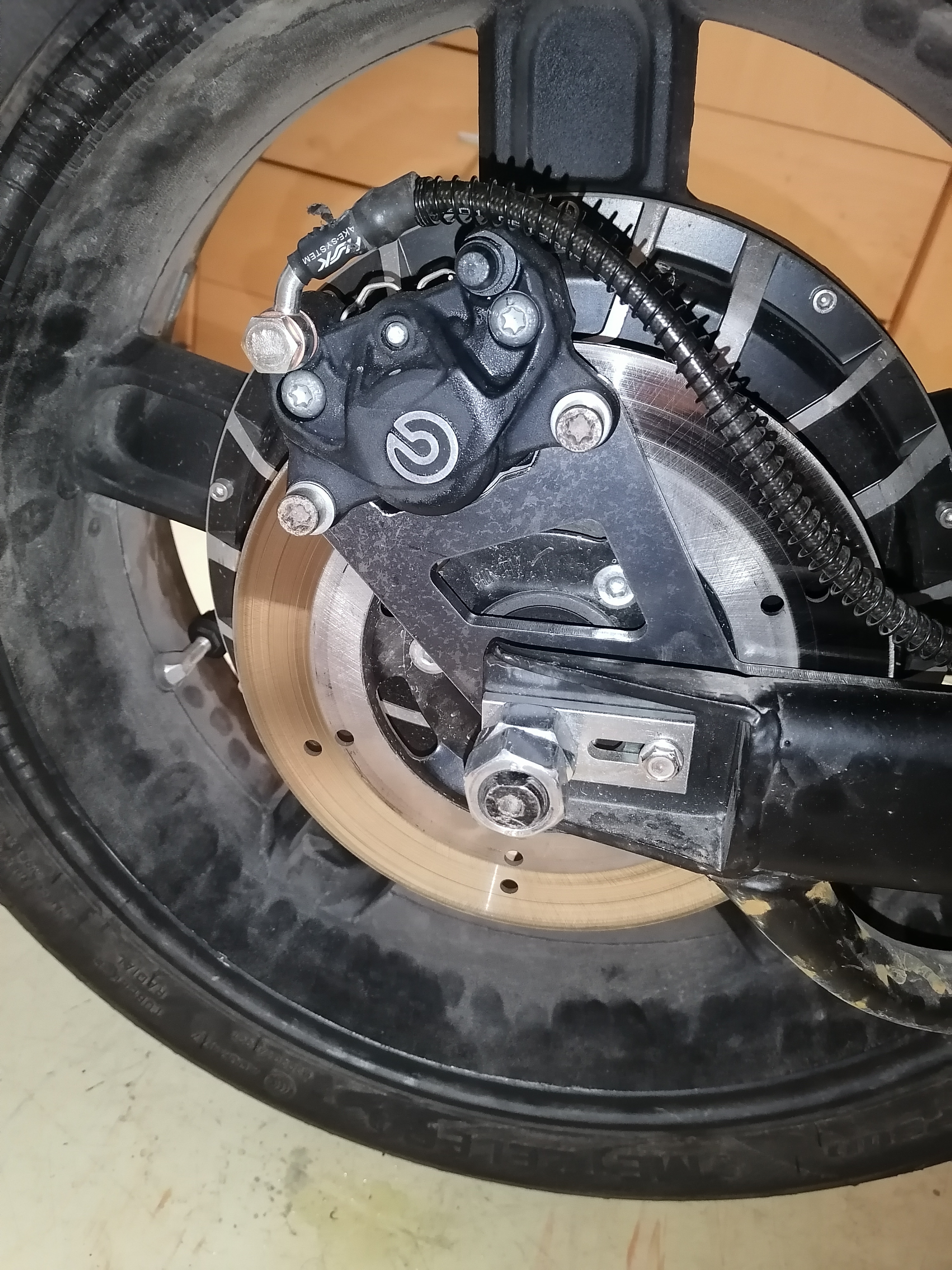

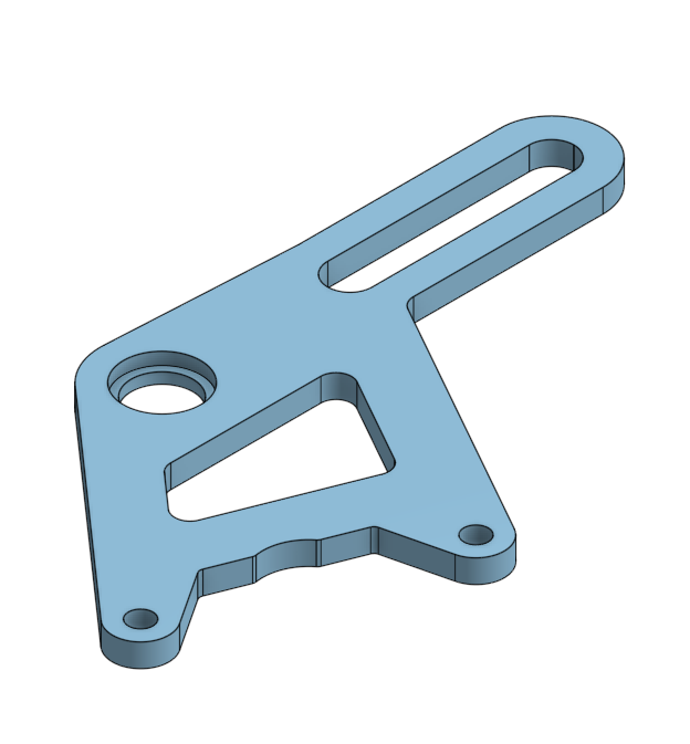

new bracket for new Brembo rear brake caliper is currently being manufactured so I will ride again soon
Next project will be... new brackets for new front brake calipers - of course Brembo

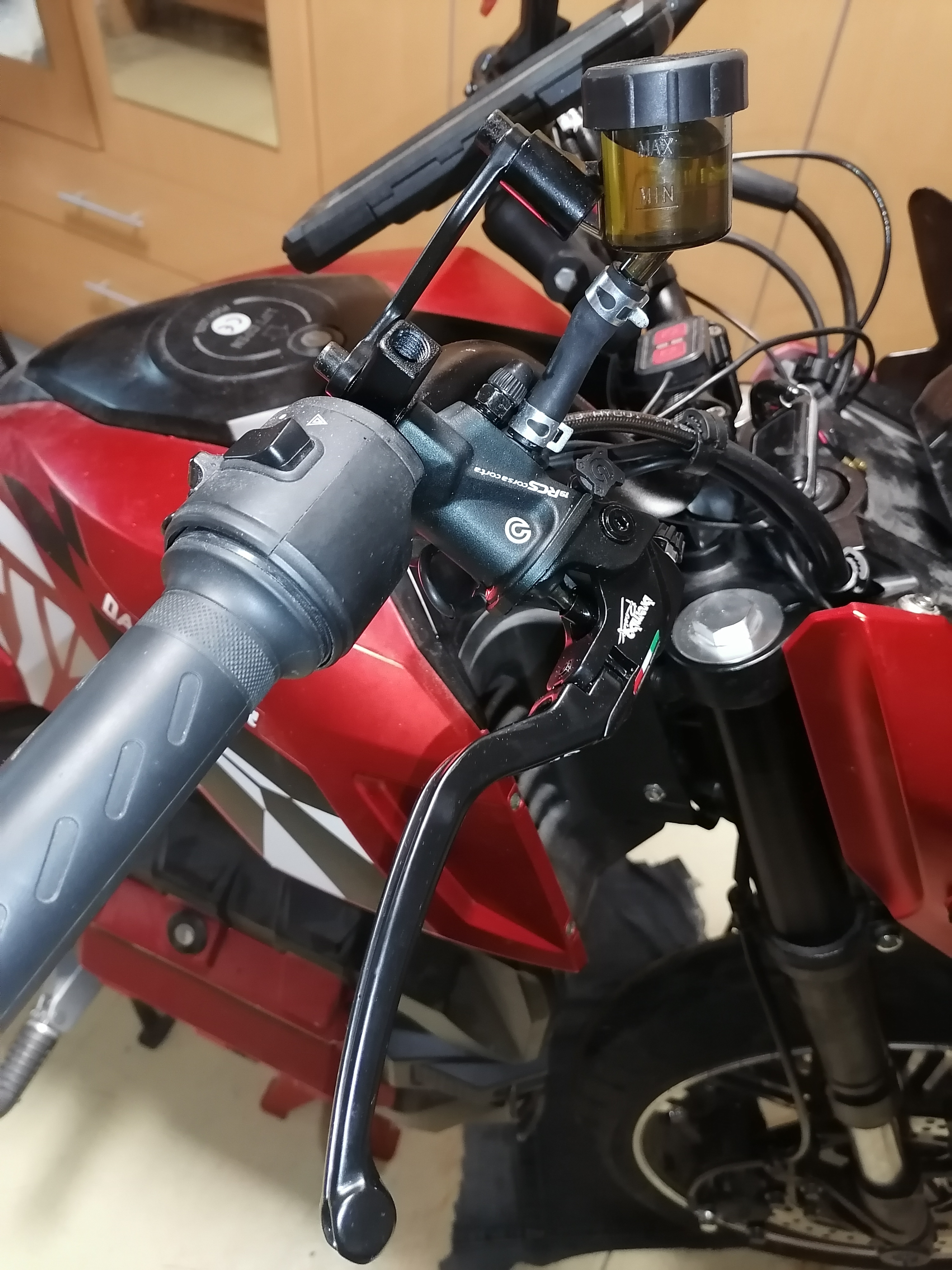

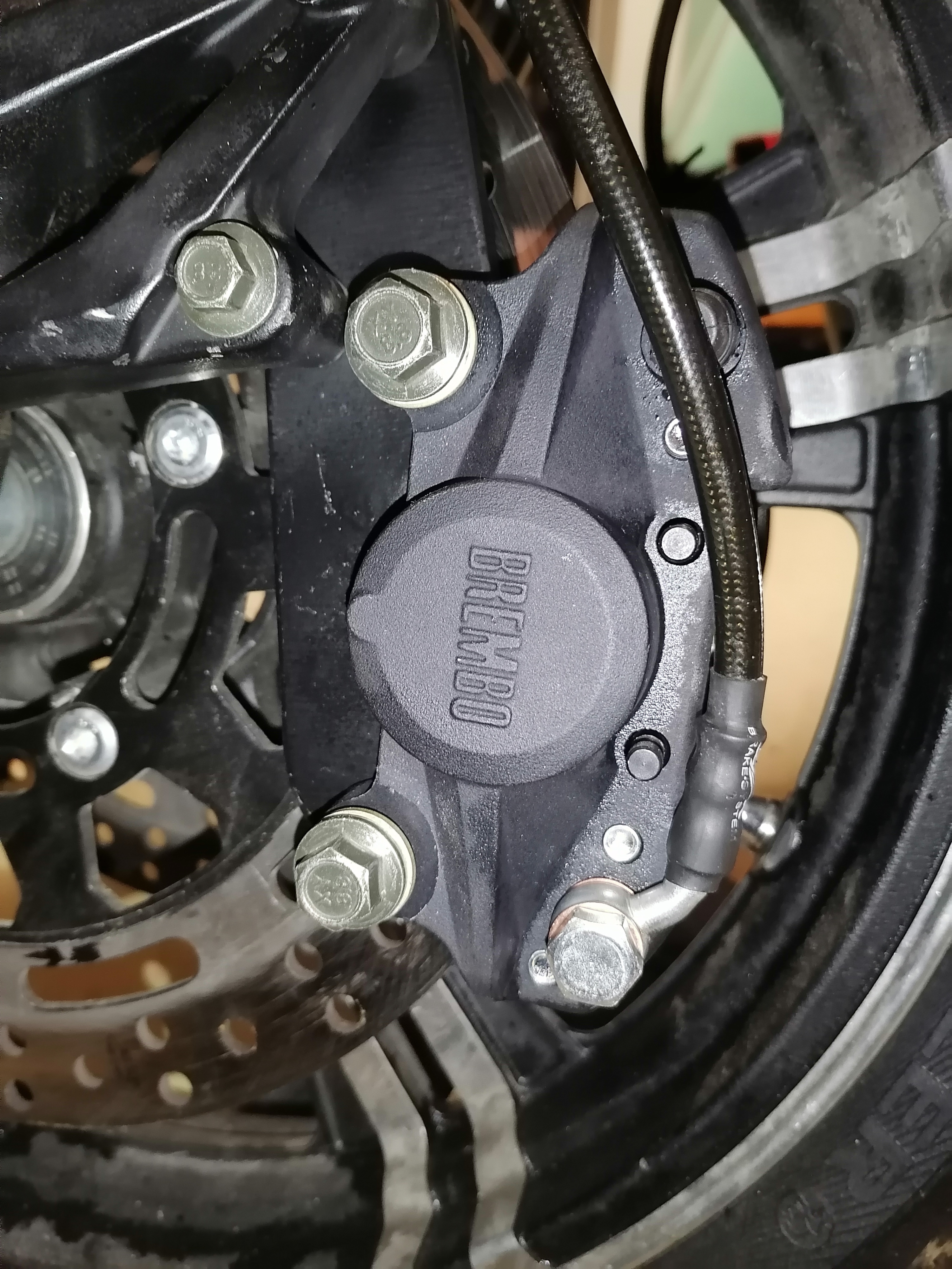

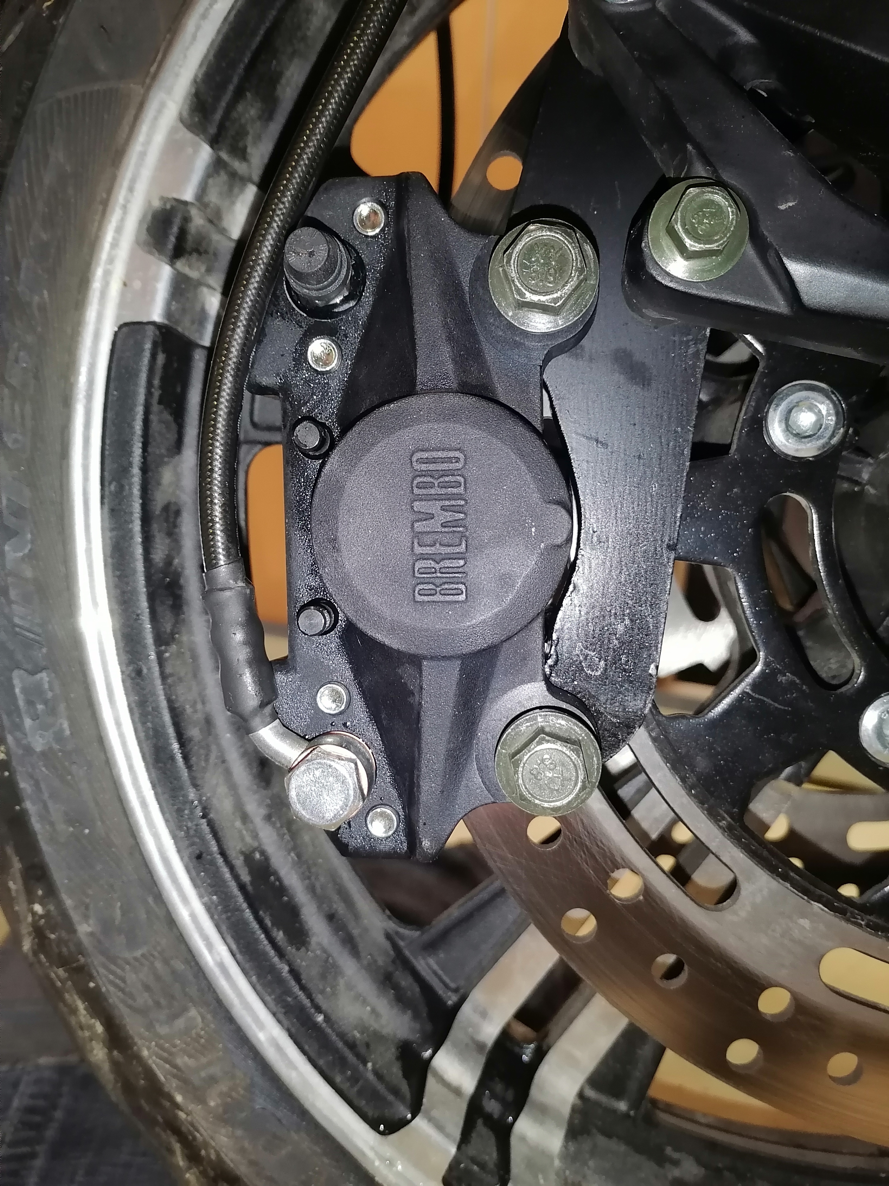

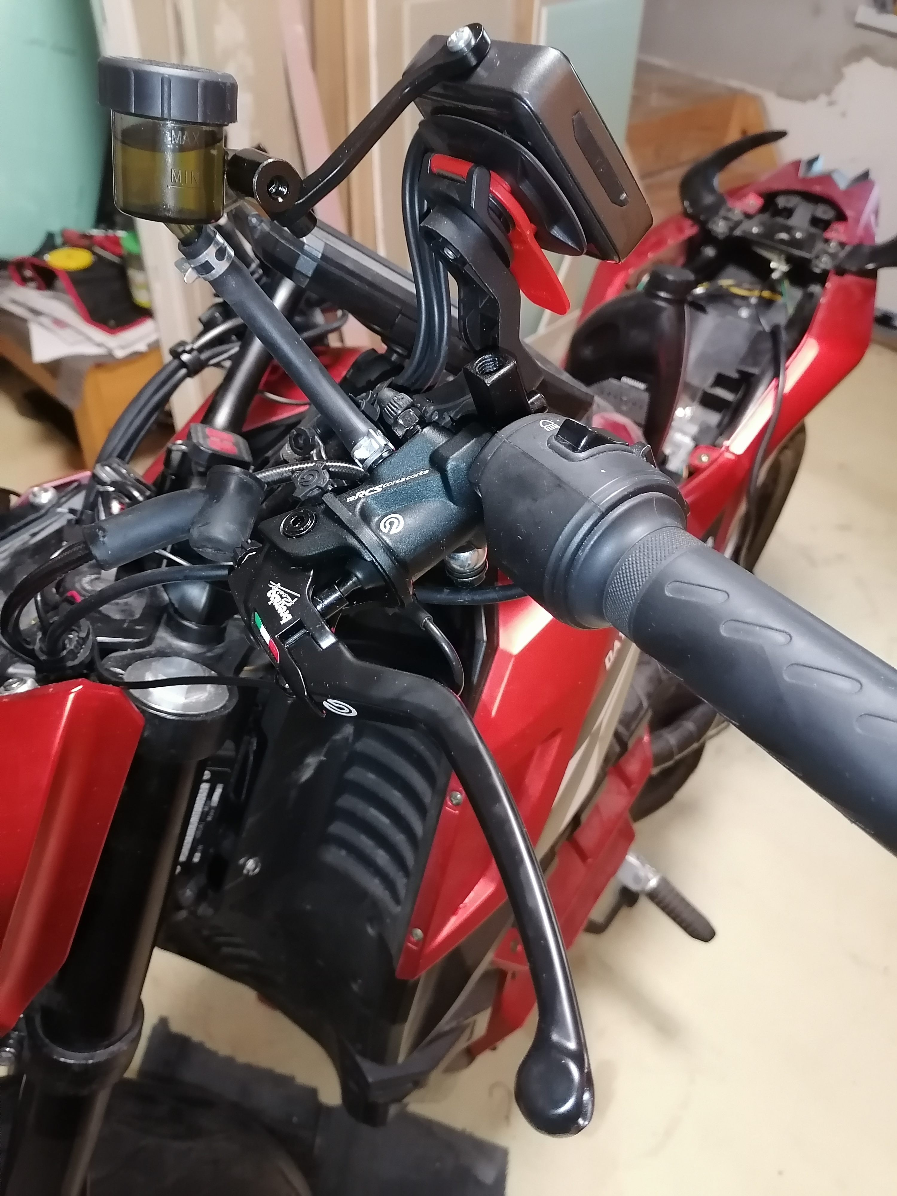

Project "BrOdin" (Odin with Brembo brakes) finished.
All calipers are original. Rear bracket is made with laser, front brackets are factory, needed only a little bit of angle grinder (I will make new ones because of new 300mm brake discs but it will wait now). Works great. I have not try it on road yet so can not compare whether they brake better than original but I am sure they do.
Brake levers are chinese copy of Brembo Racing 19RCS Corsa Corta (65 EUR on Aliexpress, original costs 10x more). Works much better than original levers.
Brake hoses are the same, some bolts are new.
