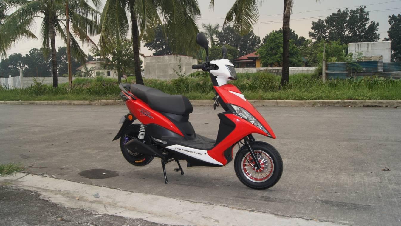

Mein Roller ist: Kenwei Extreme 1800 Watt
