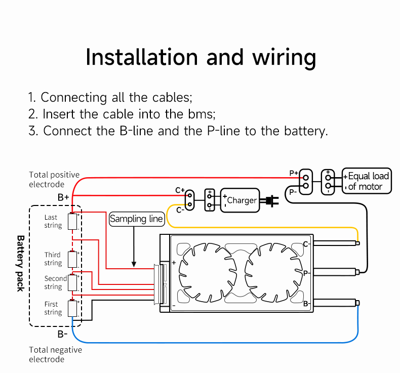

obvoiusly Your battery looks like this:
Due to recuperation mode the battery should also accept charging via Anderson 50 connector,
but safest way will be the charging port.

Do you know what bms is in the Pusa battery? At least if it is with one port for charge/discharge or two separate ports. I want to know if I charge via the discharge port does the bms protects for overcharging.

the charging socket in the battary case only makes sense, if there is a charging port BMS inside.
A charging port BMS is able to close (cut off) charging port C- while chargig and is also able to close (cut off) dischargig port P- (Anderson 50) while discharging. There are separate FETs at charging port and at discharging port, to cut off the line. In recuperation mode of PUSA/LIPO there will be charge current on discharging port (Anderson 50) for a moment, but probably no cut off possibility, if a cell reaches maximum voltage.
The motor controller should activate recuperation mode only below 90% of highest battery voltage, to cause no problems. If You use a charger on dischare port, it may work on the normal way. But (to be on the safe side) You should use lower limit of maximum chargig voltage (f. ex. 0.1 Ohm power resistant 50W in line), to have secure chargig stop. However if a cell reaches the limit, there may be an acustic alarm by the BMS. Additionaly there will be cut off of charging port (without function), but the discharging port will probably stay open.
