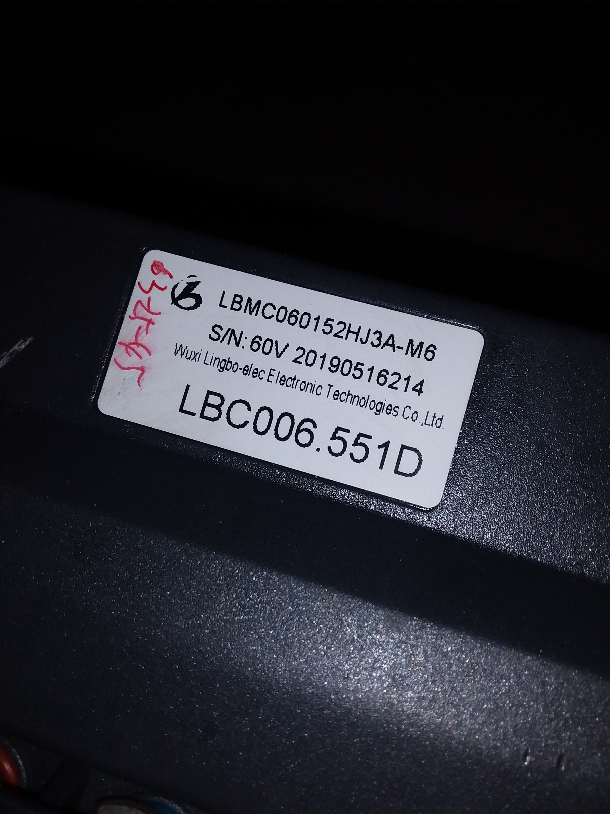

Hello,
I bought a CITYCOCO LUQI 3 3000W with 20AH 63v battery, unbridled version, but the supplier is mistaken and sent me the approved version with 45 km / h, knowing that the ligbo controller is programmable, someone will be able to me help configure it ??
Could you give me the description (identification of the connection of the socket) of the following controller:
- BRAND: LINGBO
- LBC006.551D
- LBMC060152HJ3A-M6
- S / N: 60V 20190516214
I want to reprogram it in order to release the maximum speed.

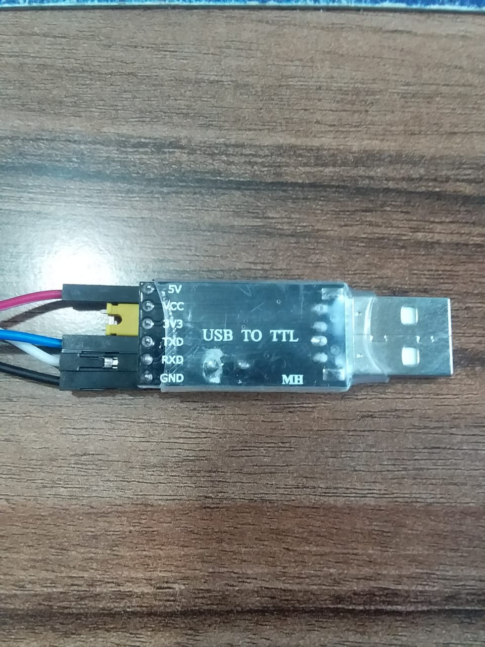

what else do you need? the russian site says it clear:
"USB TTL converter on the controller 30 pin connector
• USB 3V3: RED (3.3V) on pin no .: 29
• USB GND: BLACK (GND) on pin no .: 7
• USB Tx: WHITE (Tx) on pin no .: 23
• USB Rx: GRAY (Rx) on pin n °: 13

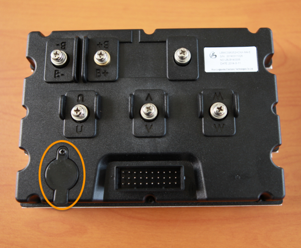

First, according to instructions in russian site I need "Dupont 10P male / female Arduino cable". In the original pictures by dpatrock in this thread both the controller pins and USB-TTL adapter pins are male. Why do I need male/female cable? I tried to seach in ebay suitable gear for the operation and I found from ebay this adapter and this cable. Are they good for this purpose if I select female/female cable?
Secondly, in the picture of the controller by dpatrock there are 30 pins in the connector. Which pin is nr 1 and which one is nr 30 ? The pin numbers are not printed in the controller.
He says in his very good instructions " "Speed limit ratio (%)" = 100% (to be modified first, then meter later on "disable")". What meter? What modified first and after that?
Sorry if the questions are idiotic but like I said I have never done this kind of computer works before and I need very detailed instructions that I do not blow up the who controller (or the computer usb port). But I definitely want to try this out to learn.

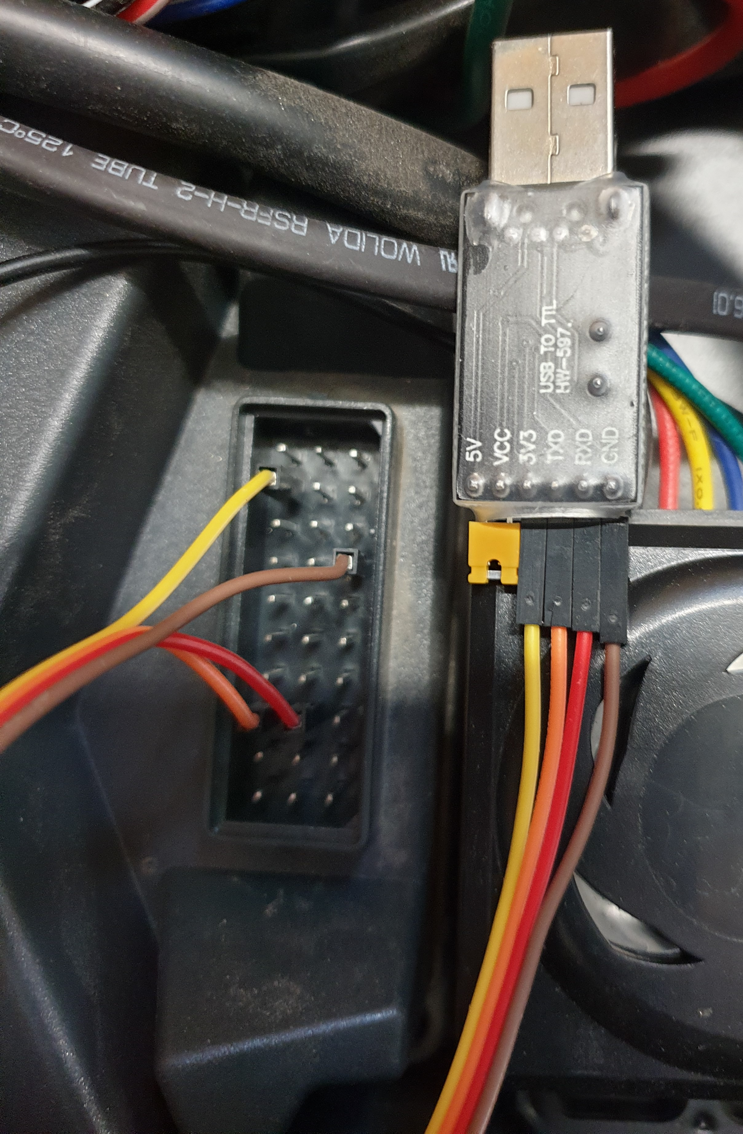

send a detailed photo of connector and jack, we will see
Zerry
- Beiträge: 3
- Registriert: Do 22. Apr 2021, 20:16
- PLZ: 00100
- Land: anderes Land
Re: unclamping, lingbo controller LBC006.551D
It was very straight forward operation to get control unit on-line. Thank you for these detailed instructions.
If someone needs in addition to written instructions detailed picture of the wiring here it is: Like the instructions above says the red LED in to lower left corner of the 30pin connector start to blink when connection is on.
