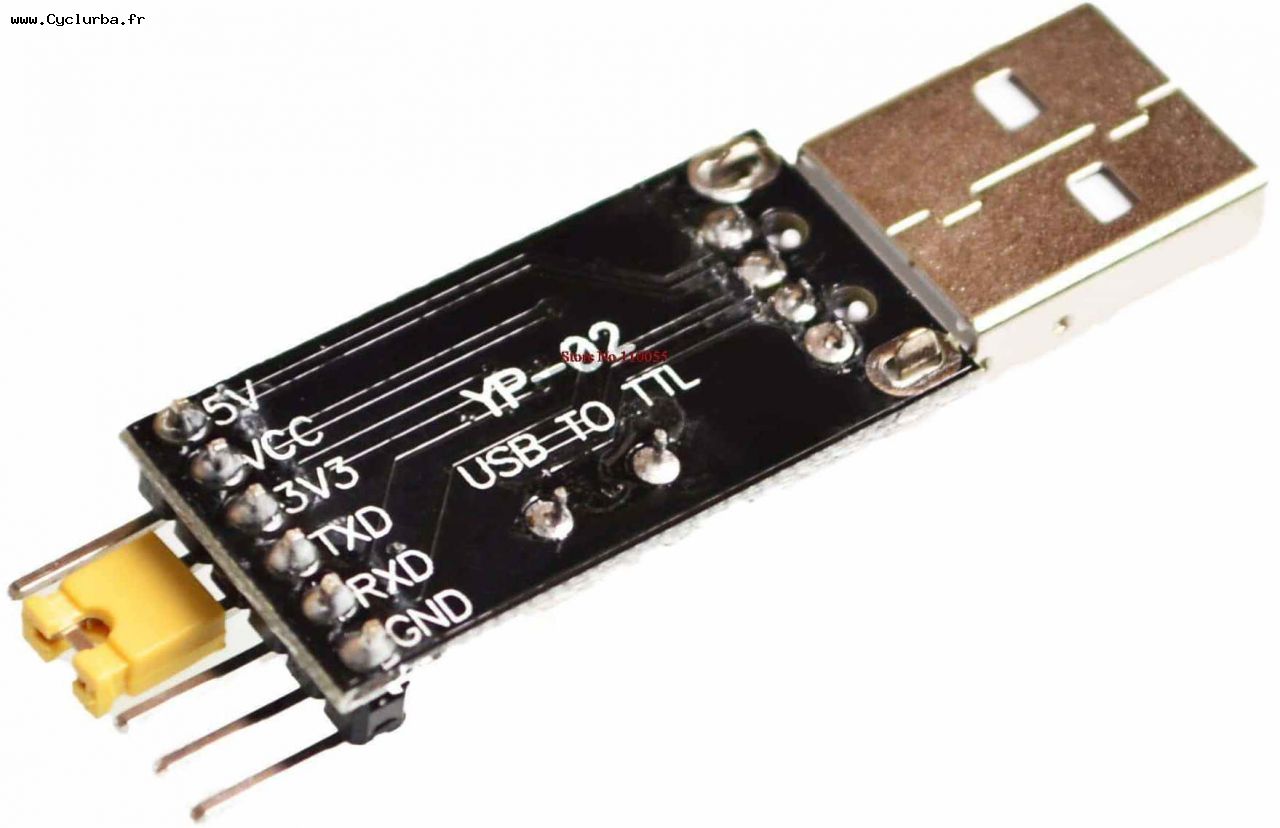

- USB TTL Converter CH340G CP2102 PL2303 UART FTDI Arduino 5V + 3.3V : AliExpress - ebay - Cdiscount_ - AliExpress - Amazon

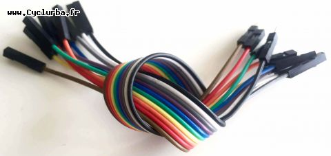

- Cable Dupont 10P male/female Arduino : ebay.de - ebay.fr - AliExpress

A. On USB TTL Converter, connect cap on jumper 5V and Vcc , in order to use 3,3V
B. Install driver (CH341ser.exe) / Connect USB TTL Converter to PC or laptop

USB TTL Converter Code > Color on controler 6 pins connector
USB 3V3 > RED (3.3V)
USB GND > BLACK (GND)
USB Tx > BLUE (Tx)
USB Rx > WHITE (Rx)
