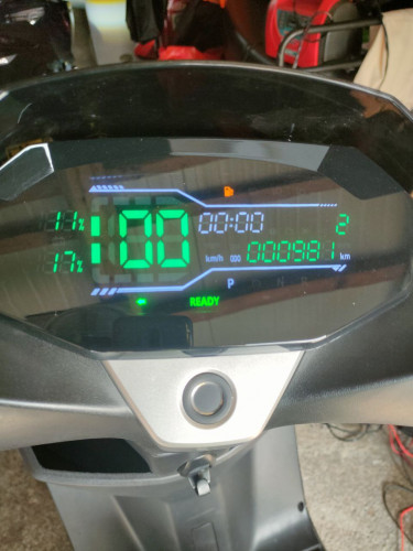

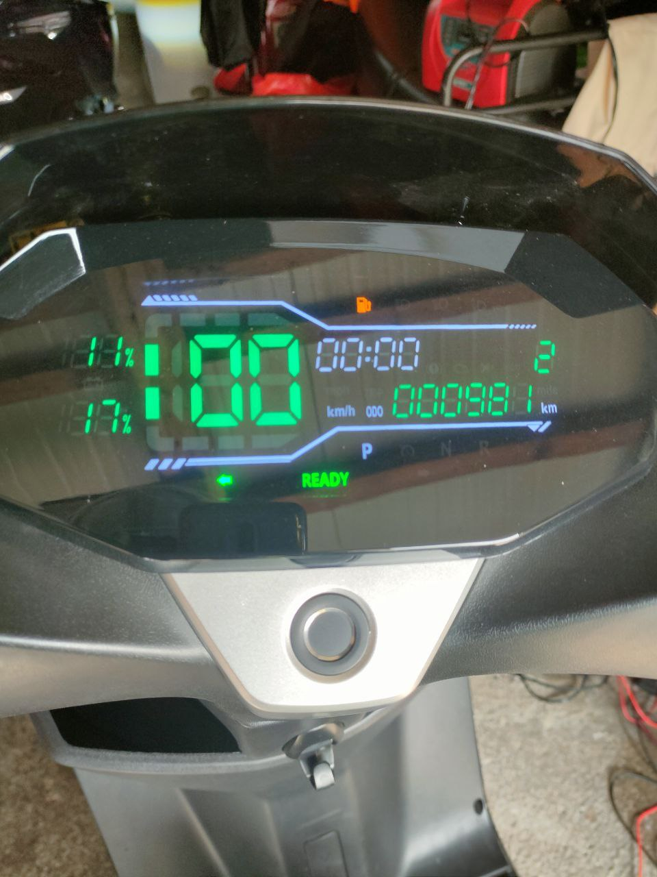

In the end, as always, I cover 3 trips (round trip) with a total of 57km since the "reserve" light came on at 981km:
(90km advertised at the sale, 53km registered ... and the other 37km? to the fairyworld?)

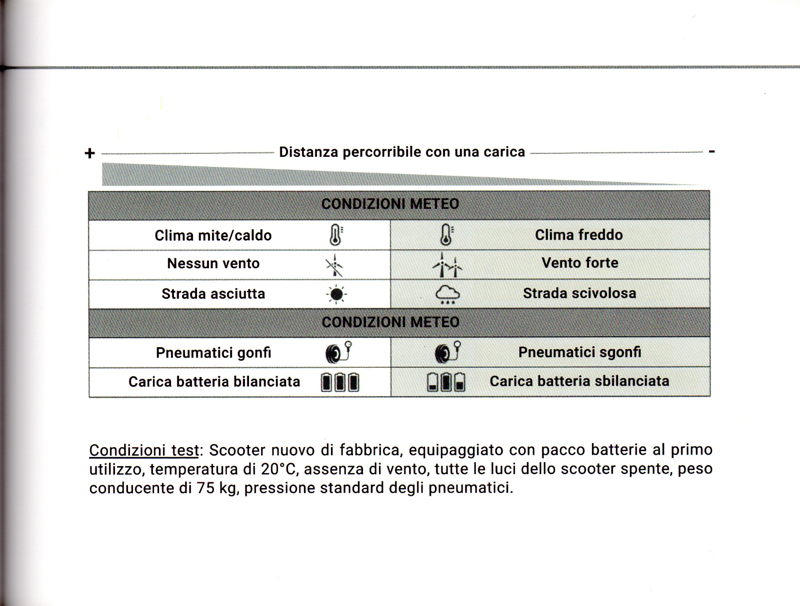

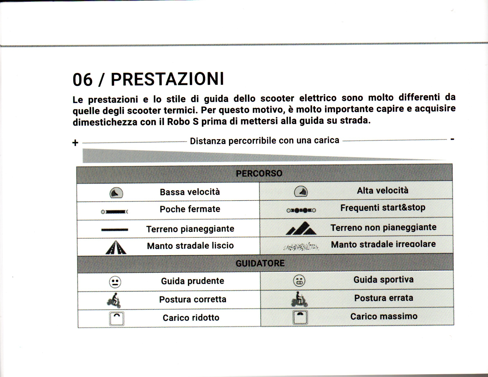

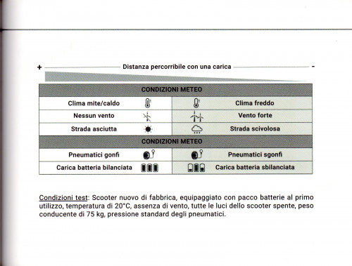

they proudly advertise the maximum 90km / h and 135km of range, but in any case they did not take into mind that in an SS (statal street) during peak times you cannot do acceleration races or anything else, also because not all of us drive recklessly];
However, they invite me to test the scooter "on the same journey" in D1 mode (50km / h maximum). Although it may be a stretch that I travel at 50-60km / h for the most part, there are also many heavy vehicles that travel the same road and as often happens, they do not keep very far when they have to overcome a snail on the 70km / h limit. that gets in the way at 50km / h. I decide that it is too dangerous to go so slowly as it is not a car and I travel a route with fewer stops and restarts in the open countryside on wider and less busy SP or SS, as indicated in the manual I help to maintain a better autonomy since it was a mild day, little wind and plain.
I know that it's in Italian, but I think that we have the same Manual and we can read the one that we have with us.

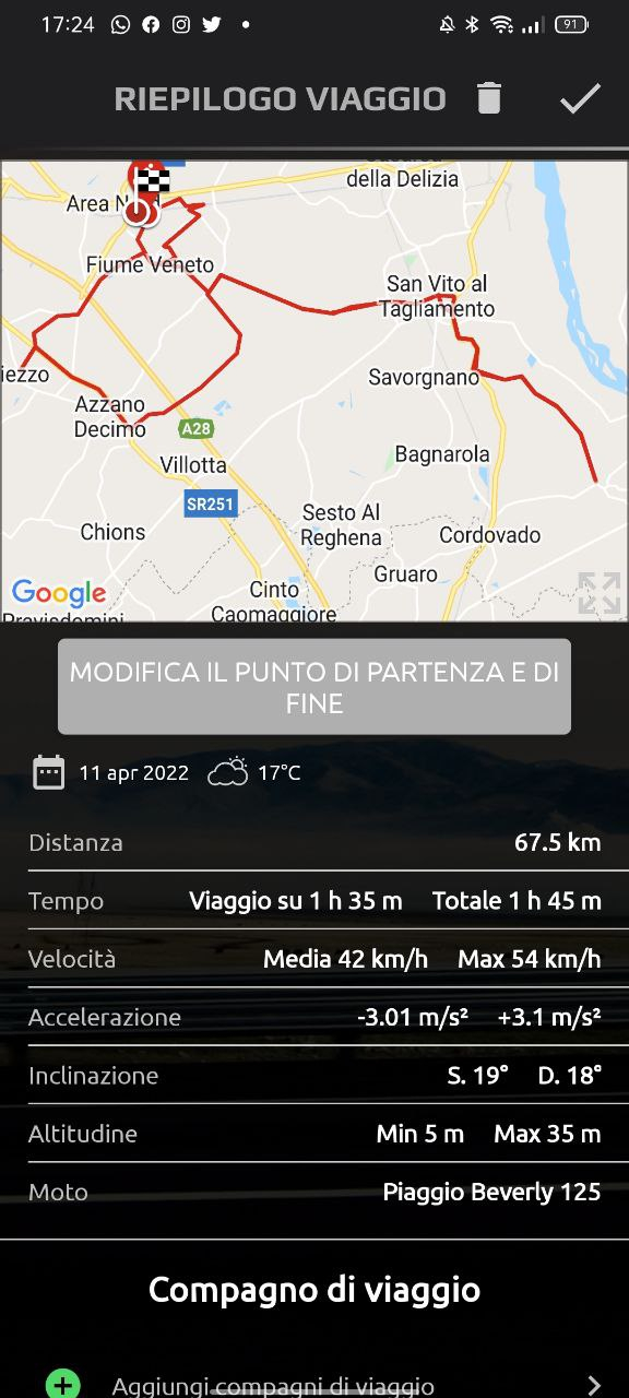

To demonstrate that I am taking these measurements seriously, I use a Yamaha app that tracks the route and records the maximum-minimum-average speeds etc ..
I start driving with the D1 mode only and travel 72km in 1h and 46min crossing the localities of San Vito al Tagliamento, almost at the height of Cordovado to return towards Azzano Decimo and finally to the starting point:
I report everything to the workshop by also sending the videos I recorded during the ride to testify the kilometers traveled and the travel time (if someone is able to use the calculator it makes [space] / [time] and calculates the average speed, put the case that a bad faith is assumed).

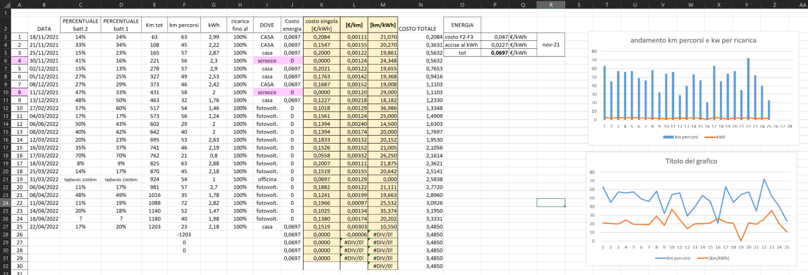

By the time had carried out 25 recharges, all documented and looking at the data of routes and recharges (ditto the kWh consumed to recharge it) I do not notice alarming variations, however the data collected are still few to be able to observe something:
There is a huge difference between the declared / advertised autonomies and those recorded during use, namely:
- mode D3: declared 90 [km] to 85 [km / h], measured 57 [km] (taking into consideration the first test communicated), therefore the 36.66% difference;
mode D2: declared 110 [km] to 70 [km / h], measured 57 [km], therefore the 48.18% difference;
- D1 mode: declared 135 [km] at 55 [km / h], measured 72 [km] (last test) at 42 [km / h] on average, therefore the 46.66% difference.
