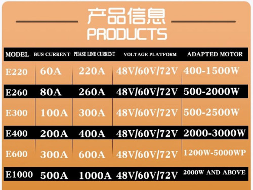

Re: Super Soco Stash 2023
Vmoto Stash controller = Lingbo E1000, bus current 500A, phase line current 1000A, bluetooth direct connection.
