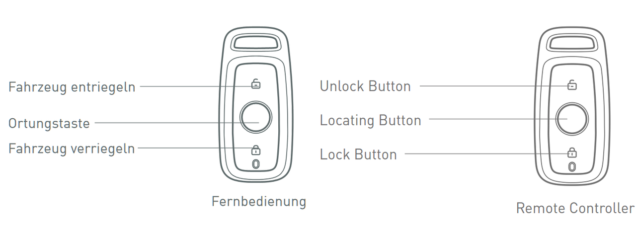

I can shake my M+ without anything. The only case in which my alarm goes off is if I take it off the stand or turn the key in the lock without disabeling the alarm beforehand.
First check what the sensitivity setting of your alarm is now and change it if necessary.
1. First turn off the alarm/the power and unlock the scooter
2. Hold down the red Locating Button on the Remote Controller for 3-5 seconds.
The scooter sends out a didi prompt, 1 didi is the most sensitive and 5 didi is the least sensitive.
3. Click the Locating Button on the Remote Controller to adjust the sensitivity to the appropriate niveau (according to the parking environment )
4. Click the Unlock Button on the Remote Controller to save the sensitivity Settings
5. Click the Lock Button on the Remote Controller to test whether the alarm device has a false alarm or low sensitivity, if there is, repeat the above steps to adjust.
https://www.deepl.com/translator

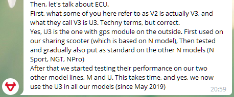

Unfortunately, I expect no cooperation from Niu in replacing the promised and by Niu promoted ECU v3. Niu has issued a statement about the ECU's, in which in my opinion Niu tries to mislead the indiegogo M+Sport backer (again).
Here is an explanation of Niu in the chat group:
Then, let's talk about ECU.
First, what some of you here refer to as V2 is actually V3, and what they call V3 is U3. Techny terms, but correct.
Yes, U3 is the one with gps module on the outside. First used on our sharing scooter (which is based on N model), Then tested and gradually also put as standard on the other N models (N Sport, NGT, NPro)
After that we started testing their performance on our two other model lines, M and U. This takes time, and yes, we now use the U3 in all our models (since May 2019)
Leider erwarte ich von Niu keine Zusammenarbeit bei der Ersetzung der versprochenen und von Niu beworbenen ECU v3. Niu hat eine Erklärung über die ECU's abgegeben, in der Niu meiner Meinung nach versucht, den indiegogo M+Sport Backer (wieder) zu täuschen.
Hier ist eine Erklärung von Niu in der Chatgruppe:
Dann lassen Sie uns über ECU sprechen.
Erstens, was einige von euch hier als V2 bezeichnen, ist eigentlich V3, und was sie V3 nennen, ist U3. Technische Begriffe, aber korrekt.
Ja, U3 ist dasjenige mit GPS-Modul auf der Außenseite. Erstmalig auf unserem Sharing-Roller (der auf dem N-Modell basiert) verwendet, dann getestet und nach und nach auch auf den anderen N-Modellen (N Sport, NGT, NPro) serienmäßig eingesetzt.
Danach begannen wir, ihre Leistung an unseren beiden anderen Modellreihen, M und U, zu testen. Das braucht Zeit, und ja, wir verwenden den U3 jetzt in allen unseren Modellen (seit Mai 2019).

Today I also received the communiqué concerning the ecu.
I must honestly admit that against my expectations in this alarm/notification issue, Niu has come to a different understanding by offering a solution to the indiegogo M+Sport backer.
Hopefully this topic will come to its (happy) end soon.

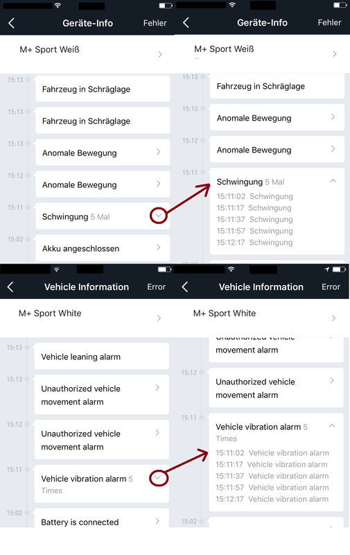

The ecu replacement took a lot of effort, but in the end it worked out.
Lately, the availability and stability of the Niu servers leaves much to be desired. The first few days no anti-theft alerts were received from the alarm system or from the gyroscope in the App. Since yesterday the anti-theft alerts have been received from the gyroscope in the App. The alert notifications of the physical alarm system do not (yet) arrive in the App and since the ECU replacement no kind of push notification has been received (on my IOS device).
Der Ecu-Austausch hat viel Mühe gekostet, aber am Ende hat es geklappt.
In letzter Zeit lässt die Verfügbarkeit und Stabilität der Niu-Server zu wünschen übrig. In den ersten Tagen wurden keine Diebstahlwarnungen von der Alarmanlage oder vom Gyroskop in der App empfangen. Seit gestern werden die Diebstahlwarnungen vom Gyroskop in der App empfangen. Die Alarmmeldungen des physischen Alarmsystems kommen (noch) nicht in der App an und seit dem ECU-Austausch wurde keine Art von Push-Meldung empfangen (auf meinem IOS-Gerät).
I put the scooter on his side on the ground, after 15 seconds came the leaning alarm notification in the App.
After that, the scooter was put upright and moved 1.5 meters from its place, in the App appeared the unauthorized vehicle movement alarm.
Finally shaken several times on the scooter, resulting in several consecutive vibration alarms accumulated in the App.
Unfortunately, after the installation of the ECU u3, the sensitivity/performance of the physical alarm system has not improved at my (indiegogo) M+Sport. I had expected that the gyroscope would (also) use the alarm system, if the alarm system was switched on with the remote control, unfortunately this is not the case. So I consider contacting my dealer and importer again about the poor performance of the physical alarm system in my (indiegogo) M+Sport.
Ich habe den Roller auf seiner Seite auf den Grund gelegt, nach 15 Sekunden kam die schrägelage Alarmmeldung in der App.
Danach wurde der Roller aufrecht gestellt und 1,5 Meter von seinem Platz entfernt, in der App erschien der anomale Bewegungsalarm.
Schließlich wurde der Roller mehrmals geschüttelt, was zu mehreren aufeinanderfolgenden akkumulierten Swingungsalarmen in der App führte.
Leider hat sich nach der Installation des ECU u3 die Empfindlichkeit/Leistung des physikalischen Alarmsystems bei meinem (indiegogo) M+Sport nicht verbessert. Ich hatte erwartet, dass der Gyroskop (auch) die Alarmanlage benutzen würde, wenn die Alarmanlage mit der Fernbedienung eingeschaltet wurde, ist dies leider nicht der Fall. So denke ich darüber nach, meinen Händler und Importeur erneut wegen der schlechten Leistung der physischen Alarmanlage in meinem (indiegogo) M+Sport zu kontaktieren.

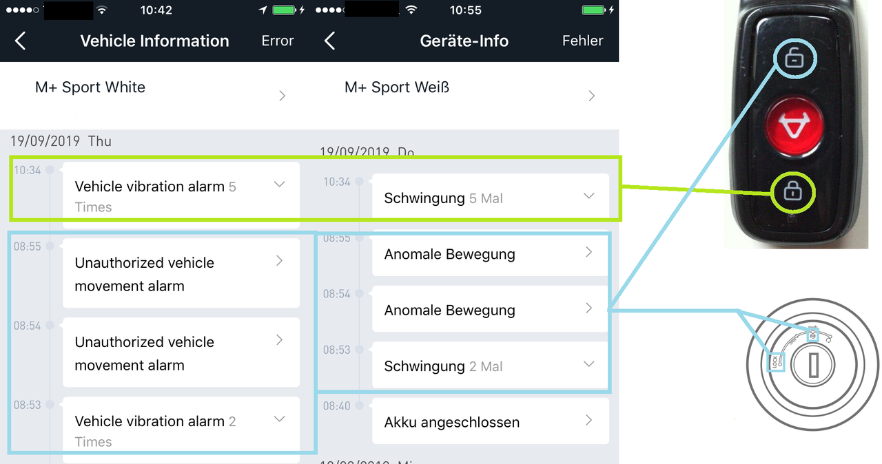

Since yesterday, when Niu contacted me, there have been changes / improvements. Suspect that the ECU template file has been remotely modified, and possibly tested on my ECU.
I notice that the alarm notifications can be seen in the App again, I haven't seen the push-notification yet.
Be patient, maybe today yours will be updated remotely as well.
Seit gestern, als Niu mich kontaktierte, gab es Änderungen / Verbesserungen. Verdacht, dass die ECU-Template-Datei aus der Ferne geändert und möglicherweise auf meinem ECU getestet wurde.
Ich stelle fest, dass die Alarmmeldungen wieder in der App zu sehen sind, ich habe die Push-Meldung noch nicht gesehen.
Haben Sie Geduld, vielleicht wird heute auch Ihre Version aus der Ferne aktualisiert.
