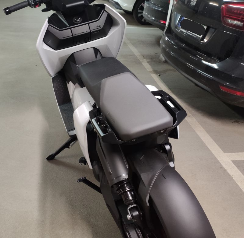

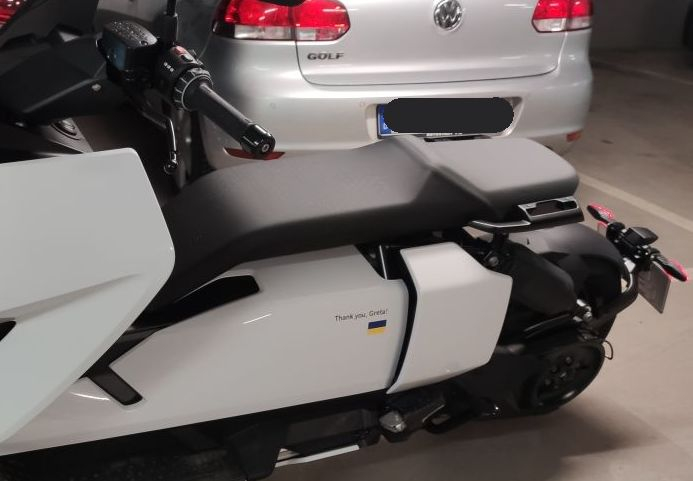

For the top case: Many use it here, nearly 50% I guess. The others won't ever think about it because they think, that it would be like putting a roof rack onto a Ferrari :lol:
I've seen you've found the right thread for that viewtopic.php?p=307521#p307521
I hope somebody gives you some hints for Shad (I think that's a very good choice) and the needed rack. Unfortunately all these racks from third party (behind the seat, not on the passenger seat like from BMW) are not compatible with the racks for the saddle bags (side bags).
What nearly everybody bought and whats compatible with all these racks is the original lower part of the BMW rack with the handles.
https://www.leebmann24.de/catalog/produ ... 549445299/
The picture is wrong! It's only about the lower part on the picture and looks like this:
There are 4 holes in the handles to mount the upper part (then it uses the passenger's seat), which look a bit ugly. I've 3D-printed some cover plugs with which you can easily close these holes (just plug them in). Tell me, if I should send you some (just for the postal expenses, in germany quite cheap).

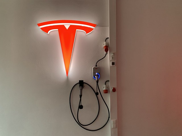

Autoladestation (könnte ich um Schnellladen auch für den CE04 verwenden):
CE 04 Ladestation:
Die Plattform verwende ich um den CE 04 leichter verschieben zu können da dieser neben dem Auto steht und deshalb knapp zur Mauer geschoben werden muss.
