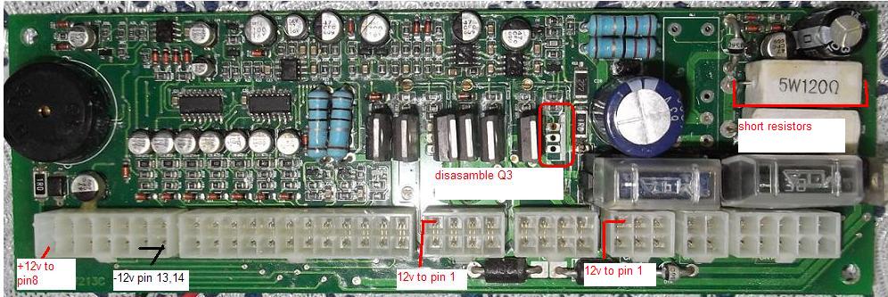

Hello Sebastian, I think the SVMC48V100A are the best - 50A normaly and 100A with boost. The circut diagram of the emax ist not easy. The emax controller work together with the MSU management system unit with integrated DC DC 48V to 12V. The emax controller has a 12V output with low current to start the MSU. Kelly and Sabvoton doesn't have it. You must be a good electrician to handle it. Maybe it easier for you to wait and get a used one at ebay.uk.

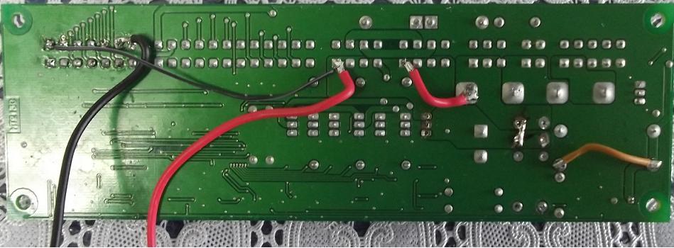

It is a 3 phase brushless dc motor with 120° angel. A controller is not a frequency converter. 72V and 37V cut off voltage seems to be okay. I think you need a seperatly DC DC 48V to 12V converter for the MSU (is to be modified) so the speedo meter will work.
The Q3 from the MSU is to be unsolder and a bridge over the 5W120Ohm resistor is to do. I would take a 48V 4,5kW Kelly. You can set the parameter with a PC and you have 2 years warranty..
