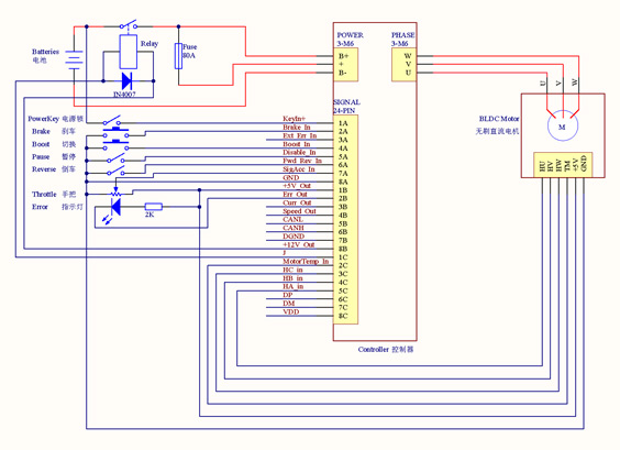

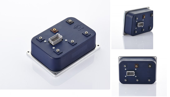

2.3 Software Update and Parameter settings
Our company’s official website provides software download for controller‘s software update and software user manual. Please read the user manual carefully before change the parameters of the Controller. Before sending the controller to our customers, the controllers have already been fully test and own the latest version software.
When computer is online with the controller via USB and run the software provided by our company, the controller is ready for reprogramming to update firmware or change settings for new application. This operation should only be done by experienced engineers. Any wrong programming or setting may result in error or damage the controller.
The following picture shows a screenshot of our software .Users can use the software to set up the following three types of parameters:
1. The controller’s input parameters. Customers can modify the threshold and the maximum effective value of accelerator pedal.
2. Controller protection Settings. Customers can set Under voltage value, Over voltage value, Over temperature value, Over-temperature reliving value, Over current value and standby state power automatic shut down delay time.
3. Speed value and current limit Settings. Customers can set the max speed of economic mode and BOOST mode. And can set the bus current limit value of the two modes to save battery power.
Note: Calibration has already been done on the controllers before they sent to the customers; if customers have the change requirements please contact our company’s engineers. Customers are only allowed to modify the above parameters and not allowed to modify the other parameters for security concerns.
