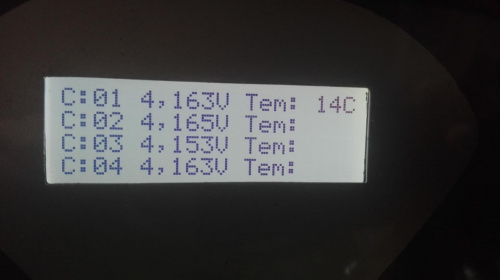

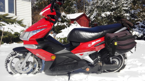

I would like to say a BIG HELLO to all e-scooter's fans. I live in Poland and I"m very happy to be here.
Unfortunately I do not speak German quite well, I hope it will be acceptable.
On the begining I have to say, that I am totaly crazy Emco fan. In 10 months I made around 12 000 km.
My Red Horse in the Winter time...
...has just received a new electronic look:
11KW peak power.
I hope you will find it, as an interesting modification of our e-horse.
Darek

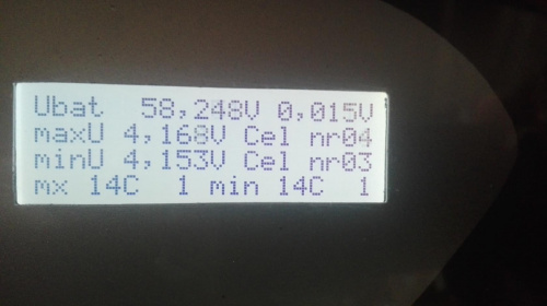

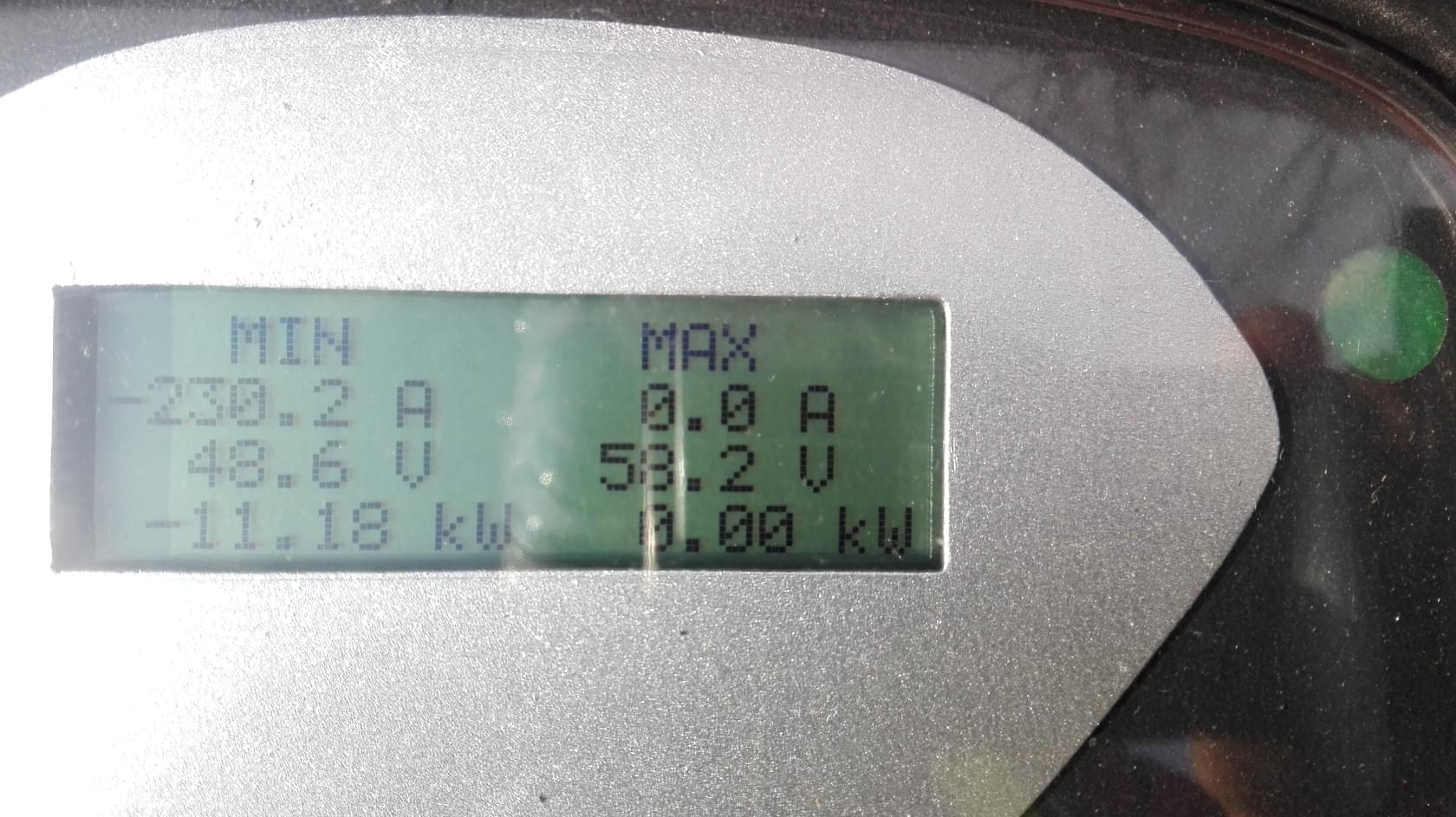

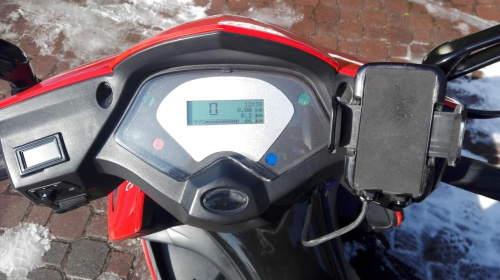

Hallo Joehannes,
Thank you for your reply.
Follow your request I posted better pictures as above. I hope now it is more visible.

Hi Darek,
11kW peak power? The contineous power of the original novax is about 4 kW and ~6 kW peak. So, you use a other hubmotor/ controller as the original use?
