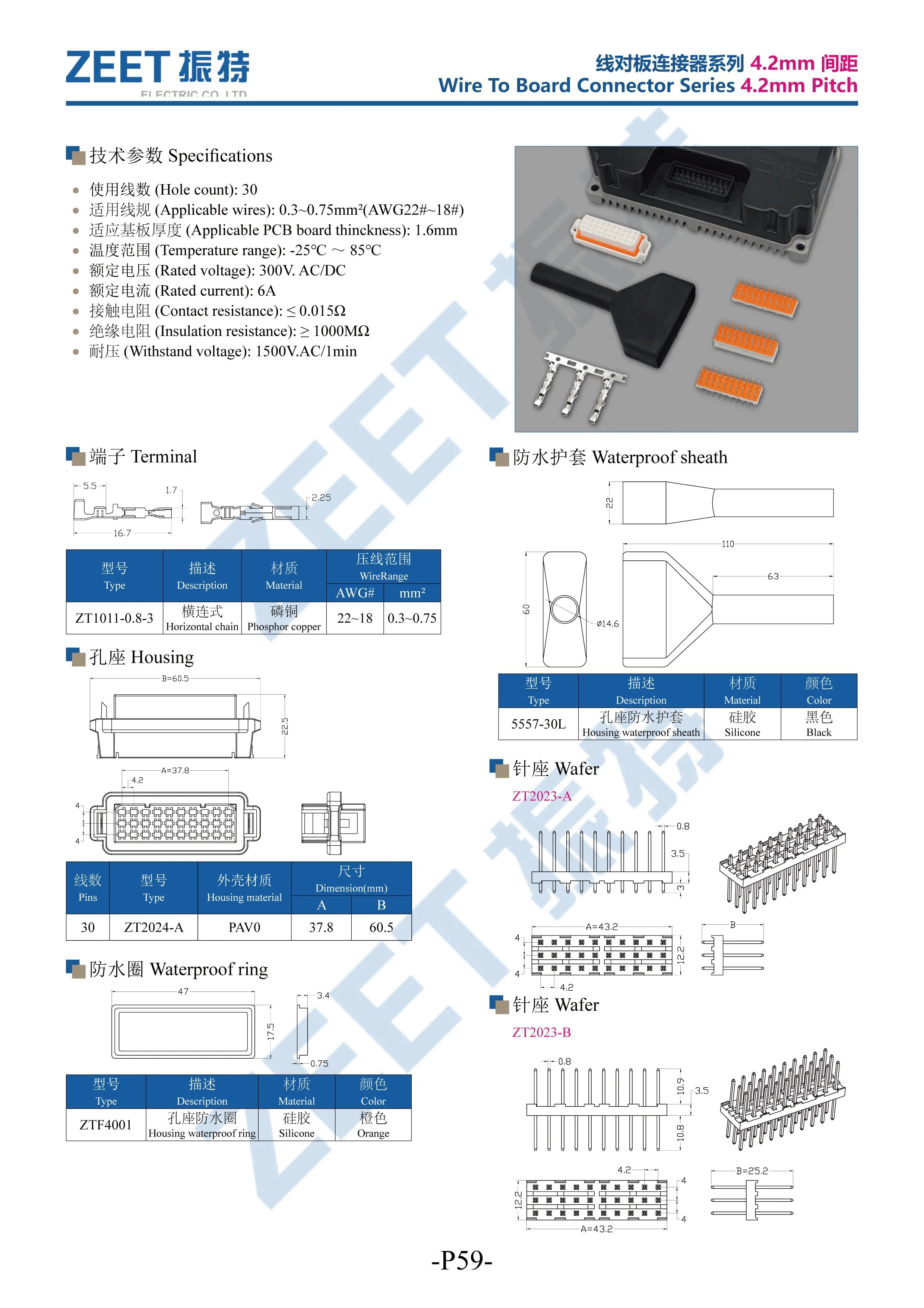

I found out which 30P connector is used in the Lingvo controller, ZT2024-A.

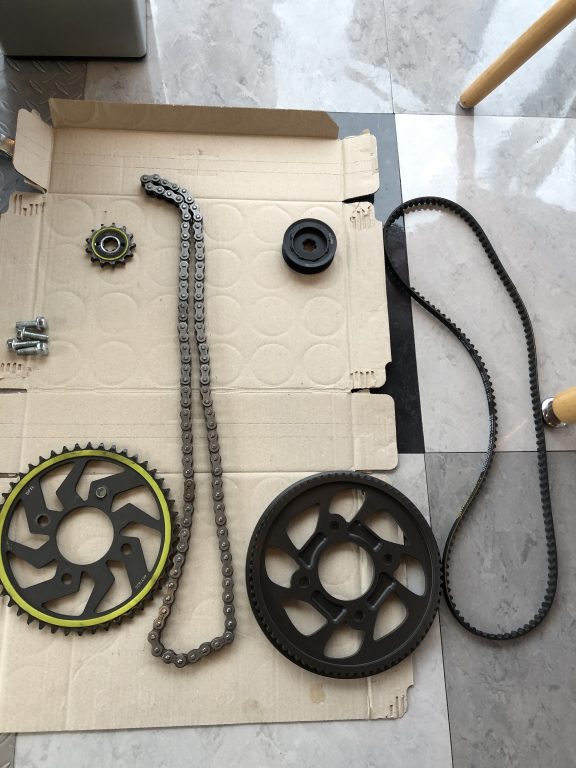

Lohnt sich der Riemenumbau (https://www.trial24.net/produkt/umbausa ... enantrieb/)?

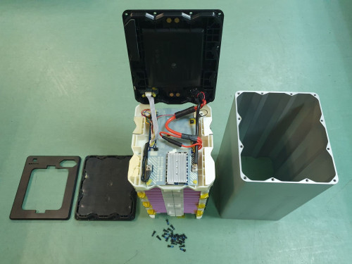

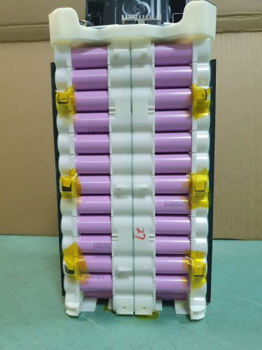

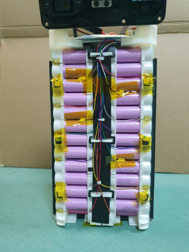

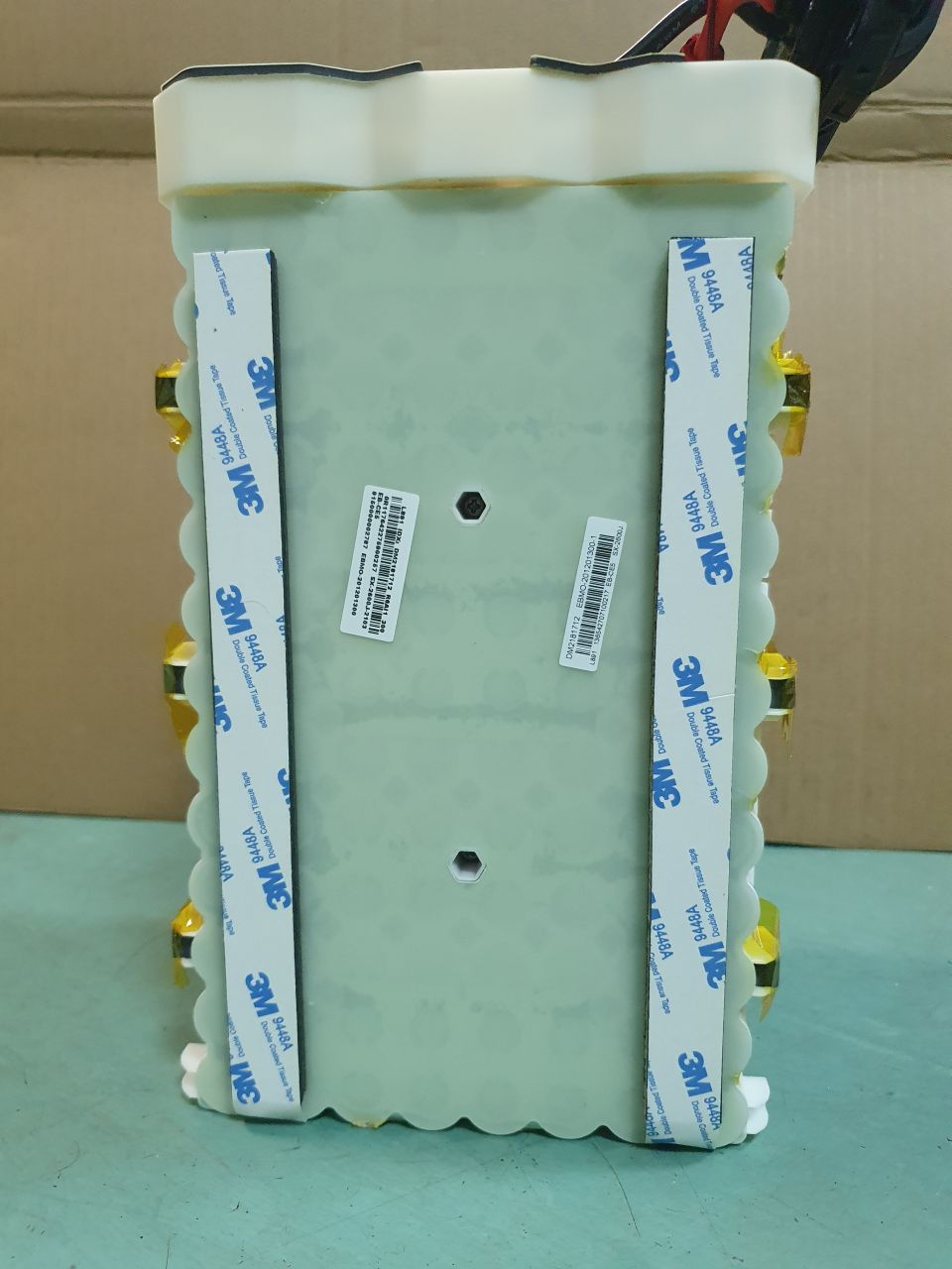

Tromox Mino Battery (what's inside)
Configuration: 204 Samsung ICR18650-26? elements (the end of the marking is not visible under the holders), 17S12P.

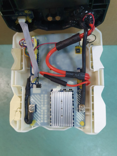

Does anybody know if there is a battery in the VCU? The app shows the battery. It seems like my battery is empty.
vlad_vy
Beiträge: 130
Registriert: Fr 30. Sep 2022, 15:53
Roller: Tromox Mino
PLZ: 1
Re: Tromox Mino
Beitrag von vlad_vy »
Yes, there is a battery inside the VCU.
