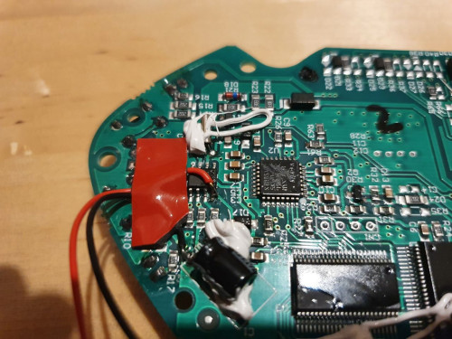

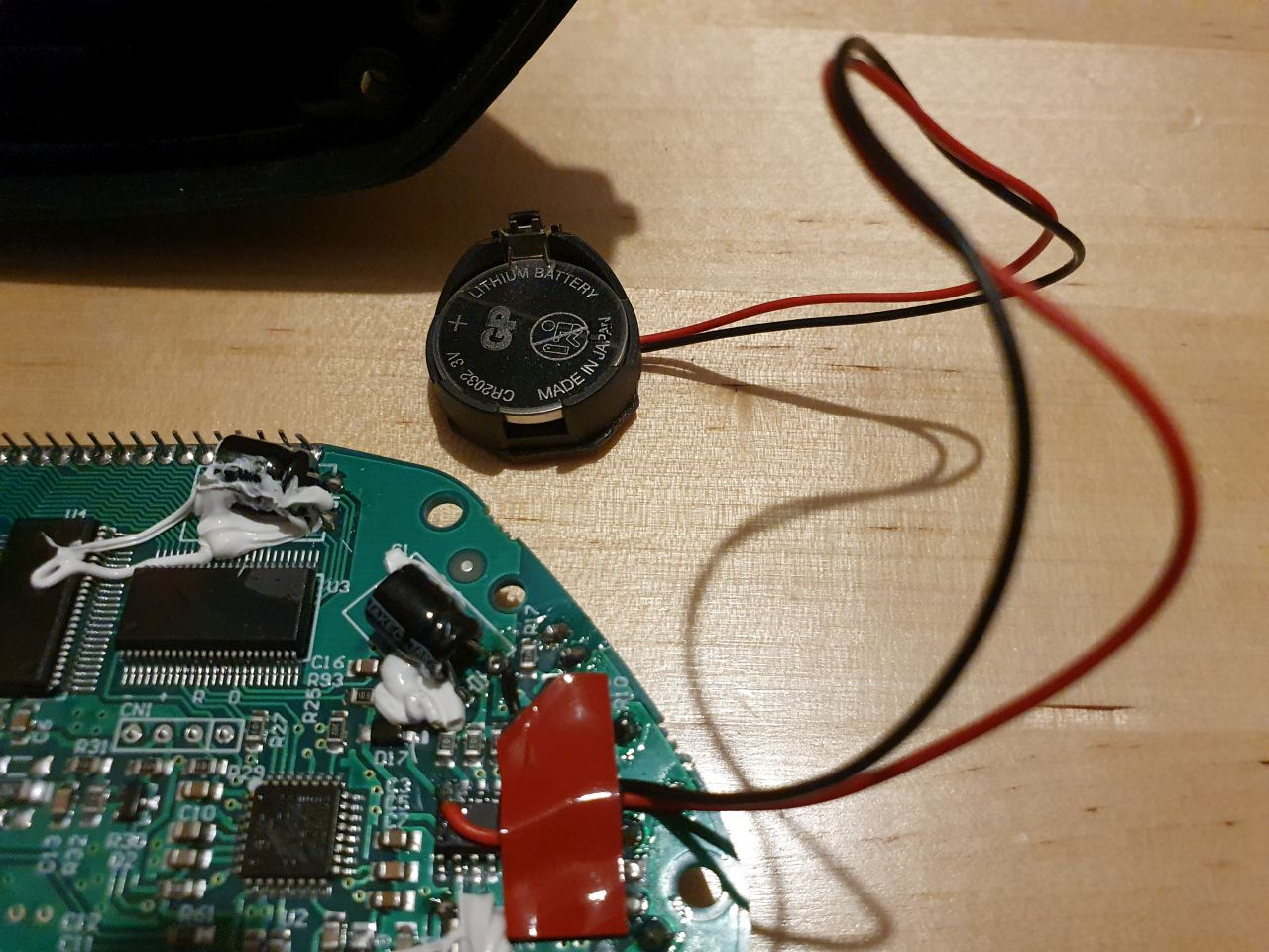

I have a couple of questions: 1. How did you connect the new dashboard? Did connect it to the VCU? Which cables to which PIN? 2. Can you post a picture of where you attached the battery holder on the chip? 3. How can you attach the dashboard to the handlebar?

Pin 8 of DS1302 is desoldered from PCB and hangs in the air. Red wire soldered to pin 8, black wire soldered to GND ("-" of capacitor). The wires are fixed to PCB with 3M adhesive tape.deadropine hat geschrieben: ↑So 20. Nov 2022, 20:46@vlad_vy

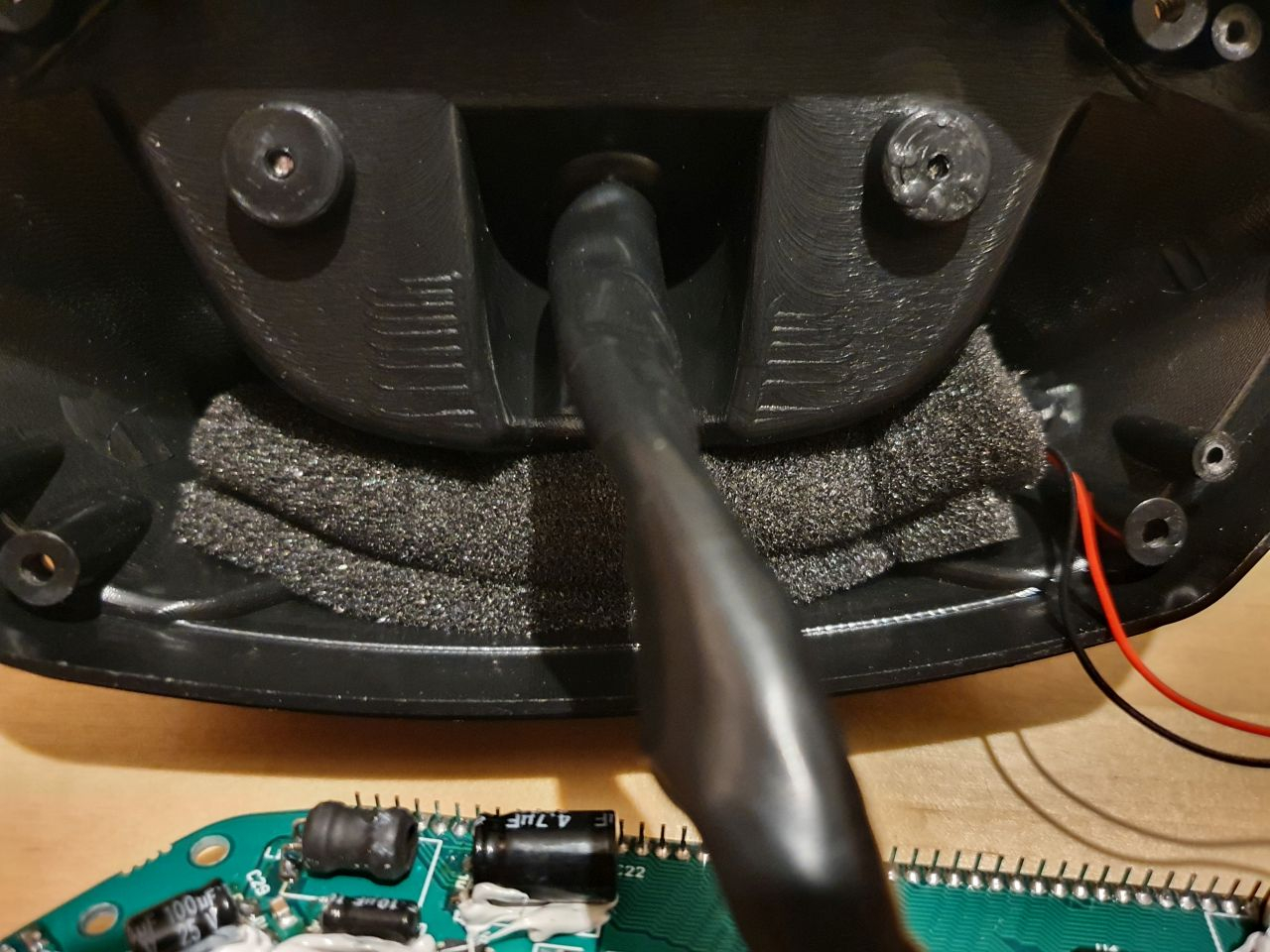

In time assembling the speedometer, one self-tapping screw ripped off the thread in the plastic stand. Replaced all self-tapping screws with M3*16 screws. Before tightening, lubricated the screws with grease, so as not to rip off the thread again.
