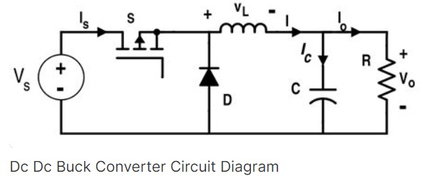

Look at the basic buck circuit you'll find in a charger.
Imagine there is huge 1000A 72V source sitting on the output, Vo.
Imagine it is 'OFF', that is, S is not running. It's powered down but plugged in.
Imagine diode, D, with Vo across it, failing closed. Or capacitor C failing, which is the other common failure.
What happens next?
THAT is why I have installed a fuse in the charging leads on the bike.

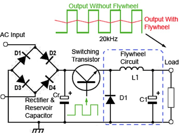

Let`s stop it. Simplified this is how the DC part on the primary side is working. But the battery is connected to the secondary side.
You are currently surrounded by millions of fine working SMPS (switched-mode power supplies). Please don`t make things up.
Very simplyfied schematics:
picture is stolen from:
https://www.circuitdiagram.co/switching ... planation/

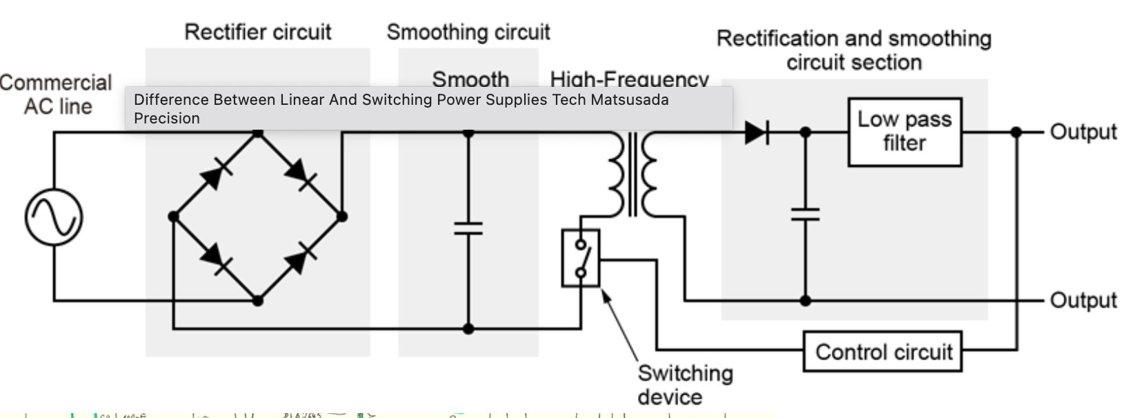

Depending on the accuracy of voltage and stability required, there are sometimes 3 stages, these two stages producing a stable DC voltage to a second DC link capacitor.
Or a neater way for better control is to have active transistors in the rectifier bridge which can be controlled to regulate the rectified voltage to the link capacitor directly. Switched (MOSFET) rectifiers are also more efficient than diode rectifiers as they have very low voltage drop across them.
(FWIW, my first power supply invention is a way to accomplish capacitive galvanic isolation from the source supply, without inductive isolation.)
The problem I am pointing out with our motorcycles is D1 or C1 failing short.
As you rightly say, if there is an appropriate fuse on the output to the battery, this is fine.
I am saying there is no such fuse on the charger supplied with my motorcycle that I saw. Therefore, I added a fuse on the bike itself in the charging leads. This also ensures if the charging port is damaged in a bizarre way while out on the road, it will fuse if it is shorted somehow.
I am not saying anyone has to do anything, but the electrical design is flawed in several safety aspects, and I think we know this?

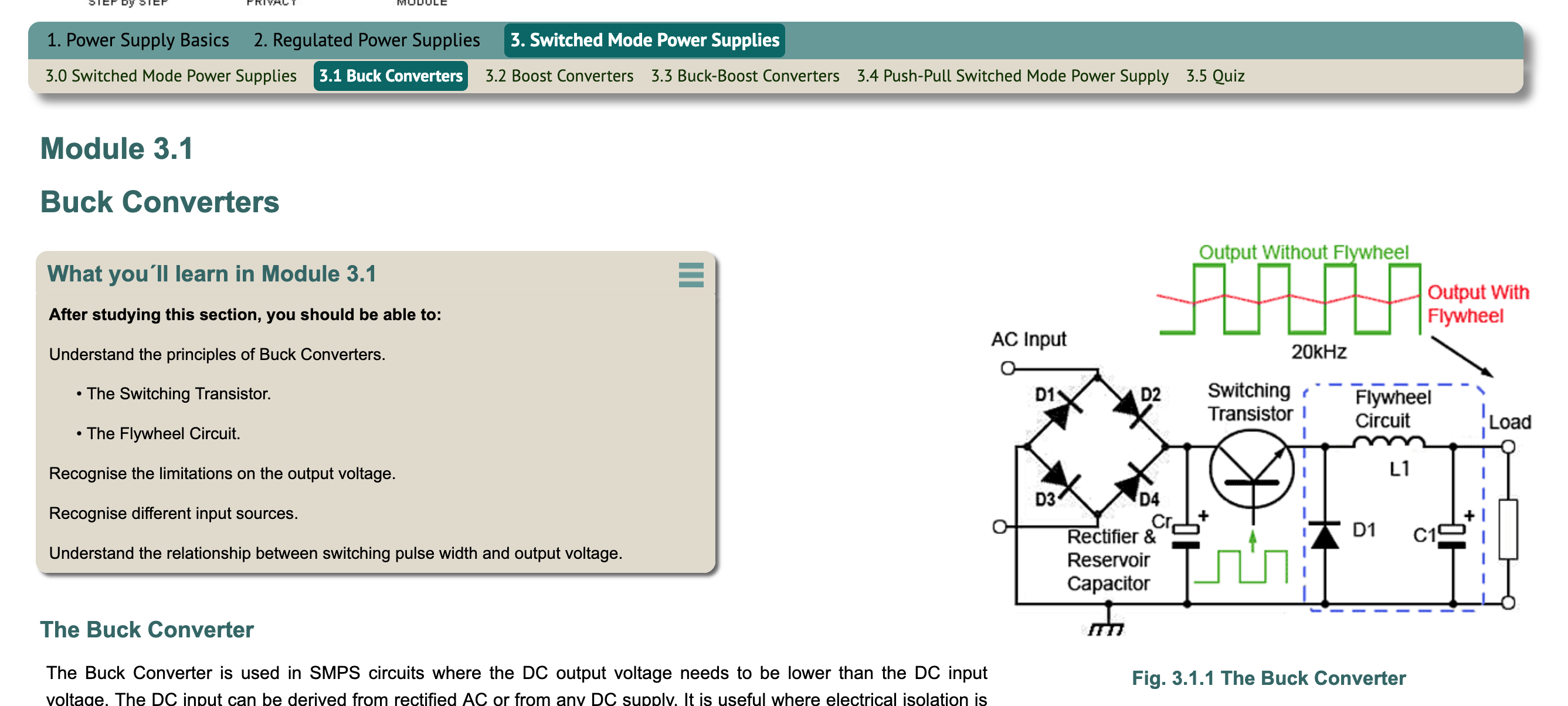

Reverse picture search took me to the source: https://www.learnabout-electronics.org/PSU/psu31.php

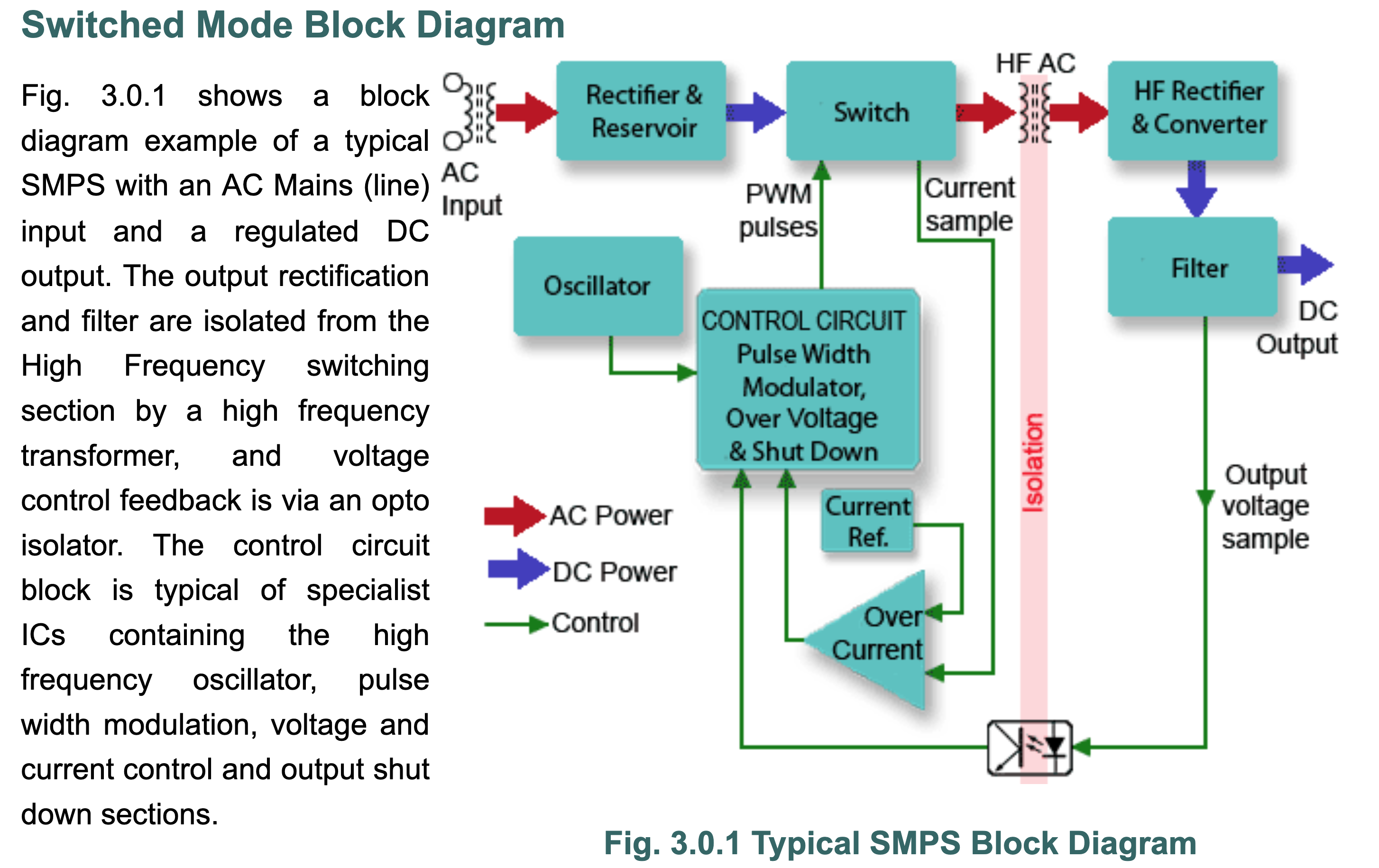

This is the beginning, the missing part, the whole story: https://www.learnabout-electronics.org/PSU/psu30.php
The important difference is the isolation from mains! There is a Control Circuit for trouble-free and safe operation.
