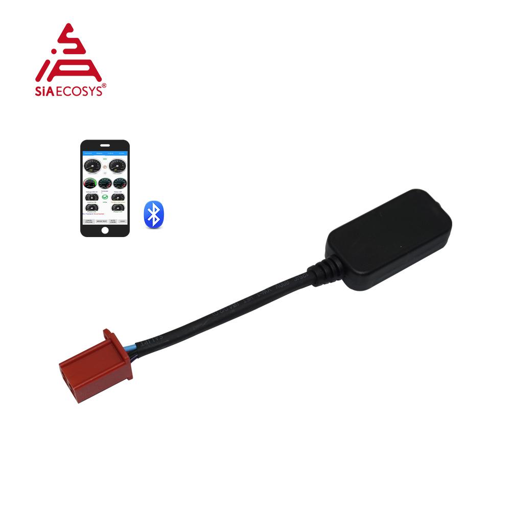

Good morning.
I have an Odin 2.0. It has got Nanjing fardriver.
I want to put a bluetooth module to see the amount of battery from the mobile and I have seen this: https://a.aliexpress.com/_vLf3Zr
In the valuations it says that some German buyer has put it and it works for him. Does anyone have it or something similar?
Thanks

Hi,
this part is for communication with the motor controller (not battery). I have it with SiaYQ7290Controller (not ODIN).
User Jeff-Jordan had made connection to Odin controller: viewtopic.php?f=157&t=16646&start=340
by own solution with PC S/W and correct connection (maybe there is wrong plug).

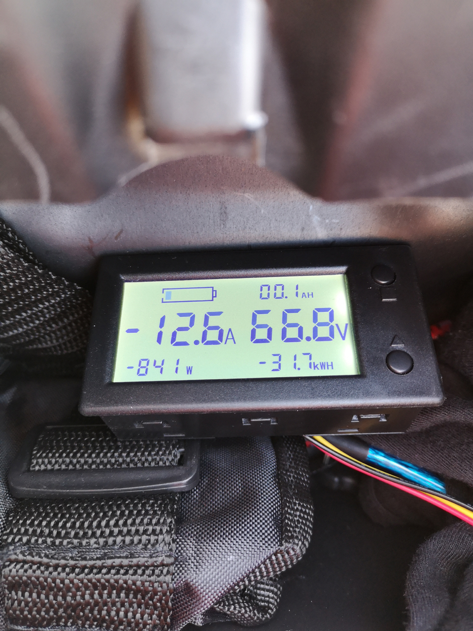

But Your real problem seems to be the wish to get better knowledge about remaining battery energy.
In this case; I would recommend You the istallation of a Coulometer-Set, like this type TF03K-A:
https://www.ebay.de/itm/163846524800?ch ... gK-z_D_BwE
The shunt sample resistant (bridge) has to be placed in der battery minus main line and a small cable has to connect batterie plus line to it, for voltage and energy. If You were able to put this in adaptor cablel between two Anderson connectors (like Your bike an battery have), You would not have to hurt the original harness (waranty) and can replace it in winter/no use time, to save battery.
https://www.ebay.de/itm/124902436433?ha ... Sw6AZhQgvU
The connection has to withstand 100Amps.
The (adjusted) coulometer gives You exact information about Ah used an Ah charged and remaining Ah/%.
It stays in sleep mode but switches on with current consumption.

Hi david....davidmunoztorrijos hat geschrieben: ↑Mi 27. Apr 2022, 11:38Good morning.
Thanks
as Didi mentioned: the adapter in your link is to configure the controller. And yes, I've got it and it works to configure the controller and monitor the actual status of the bike (like voltage, current, rpm) with the MotorNet App via bluetooth. But it doesn't allow you to get the real remaining capacity of your battery. There is no communication between the controller and the battery. In fact the bms inside our Odin battery is very dull (jbd-hp32s001) and has no bluetooth or "intelligence" on board to determine the remaining capacity.
For the monitoring of the battery, I use 2 different coulomb-meters. One that uses a 150A shunt (which is not easy to install), and one that uses a hall-sensor ring.
Both coulomb-meters show nearly the same values of the remaining battery capacity and it's way more reliable as the estimation of the speedometer (which is derived from the battery voltage).
But I'm soon going to try a third one (a newer model), that's similar with the one using a hall-sensor, but with bluetooth (& App) too.

Sorry for not posting here that I've already installed the bluetooth-version of the coulomb-meter and that I developed my own android app (which connects to the coulomb-meter), so that I can see the actual energy required per kilometer, the average energy per kilometer, the remaining energy inside the battery and a predicted remaining range (and serveral other infos).
The "standard" WBMS app, that comes with the coulomb-meter, provides less information (battery %, remaining capacity, amount of used energy, voltage, current), but it's still usefull... and much more reliable than the 10 bars shown at the speedometer.
I've seen your request for showing how it is assembled inside the e-odin, at the other thread.
Unfortunately I made no pictures while installing the coulomb-meter at the first time... so I made some pictures "afterwards".
I have to add some informations and as soon as the package is ready (expect it this week*), I'll post it at the other thread.
At least the "basic" way to install the device
