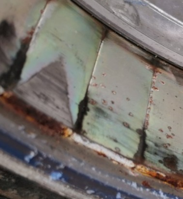

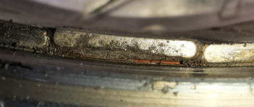

Today I studied the rim/magnets more closely.
I think everything that is not quite right is this one magnet.
On the far side (away from the cable side of the motor, it sits flush with the other magnets.
On the other it sits around 0.3mm proud.
The triangle shape is therefore understood. At the tip of the triangle it is precisely zero clearance with the stator.
At the base of the triangle, the middle is closest to the centre, because the magnets are flat and are each a short chord to the circle. So the middle and as far as the tilt on the magnet interfere with the stator. So, it is a triangle.
I realised that there is no reason for any wear on the stator. I measured more accurately and all I could find was wear on the one side of it. It is about 0.1mm of wear, on the cable side edge compared to the other edge.
I cannot say if something has made this magnet tilt, or if it was like this since it was made. I think it is since it was made. I don't know how they make these, but maybe it was the last magnet in and didn't quite fit. Or maybe the first one and it popped out.
I don't know.
All I know is that the only solution I can see is to sand this magnet back by at least 0.15mm. I know this because the wear triangle shows it is about half way between the tilted up edge and the correct placement.
I cannot see any corrosion on the rim or the magnet to show bubbling underneath. I think it was just too much glue, didn't quite fit. Or maybe it was one-off magnet not quite right.
Trust my luck. I always seem to end up with this sort of thing. Nothing at all I could have done to stop it, and yet there is no-one else to take responsibility.
I assume the plating is already worn off and I am looking at sintered magnet? I do not know the best solution to remove this thickness.
Maybe I do not bother and I let the parts grind themselves into place? I can open it again next year and take a look?
What would you do?

- Beiträge: 19291
Re: Dismantling and repairing the motor :o
Grind away another 0.1 to 0.2 mm on the triangle side, WHILE having someone else VERY closely have a small-tipped vaccum cleaner nozzle going at full tilt (best is an industrial one), in order to whisk away as many magnetic particles as possible, because you won't be able to get them off magnet otherwise. Maybe covering the not to be ground off magnet area with masking tape, which you should be able to peel off in one piece after vacuum as much of the magnetic powder off as possible. And before peeling it off, put on another covering layer of masking tape to as good as possible take prisoner the magnetic powder.
And after you are done apply a thin coat of clear coat or the oil you prefer to the enlarged triangle, for some corrosion inhibition.

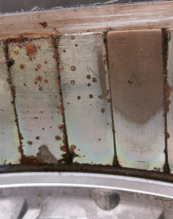

Here is the rotten detail.
The magnet is completely demagnetised in the area of the triangle. It is clear it has got very hot with friction and demagnetised.
The other end is OK and so are the magnets either side.
So, it is only half a magnet anyway, now.
I used sand paper and it produces only a fine dust that can be wiped.
But, is there any point to go further?
I cannot tell if there is corrosion beneath this piece, which has pushed it out?
In any case, I think, like a dentist, I might as well take it out? It will get worse and corrode more, stick out more.
Could this be a reason my controller gave a motor error? With only half a magnet, the currents are wrong?
What if I take it out?
If it snaps in the middle, this solves the problem for today. Then I have removed the extra thickness!
I am looking now for a replacement magnet. I measured it as 45mm x 16mm x 2mm thick.

- jeff-jordan
- Beiträge: 1205
- PLZ: 6...
That's pretty weird!
I'm wondering what's the red stuff between magnet and rim?
It's only visible at THIS magnet.
Might it be that it's a manufacturing fault? Even some doctors leave tissues or scissors inside a patient....
I think going for a new 40x15x2mm neodym magnet would be a solution... not perfect, but it won't get worse.
It could cause problems when the damaged magnet tries to trigger the hall sensors... so the controller might get a hall sensor error, for a short period of time.
It might well be rust. I gave it a scrape with a clip-puller tool (the pointy one).
If the back of the magnet gets scratched and then it ends up at the bottom and condensate forms, well, you can imagine.
I don't think 2mm shorter either end will make any difference, and the 15mm is sure to fit (I measured 16 but couldn't get the verniers in squarely, so better too small than too big.
The magnets I can get. What worries me is the glue to use. The cheapest magnet-specific glue that Henkel do (trusted brand only here, if a magnet comes loose and the wheel locks on a bend .... not nice) looks like AA326 (£30) plus the activator B7649 (£20).
I mean, the glue alone costs 10% of a new motor. Plus magnets, plus sealant, plus etc etc etc....

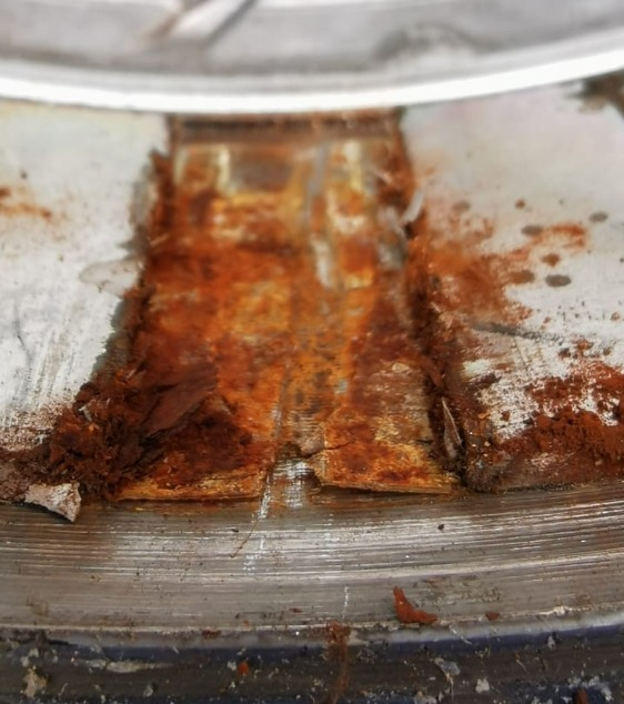

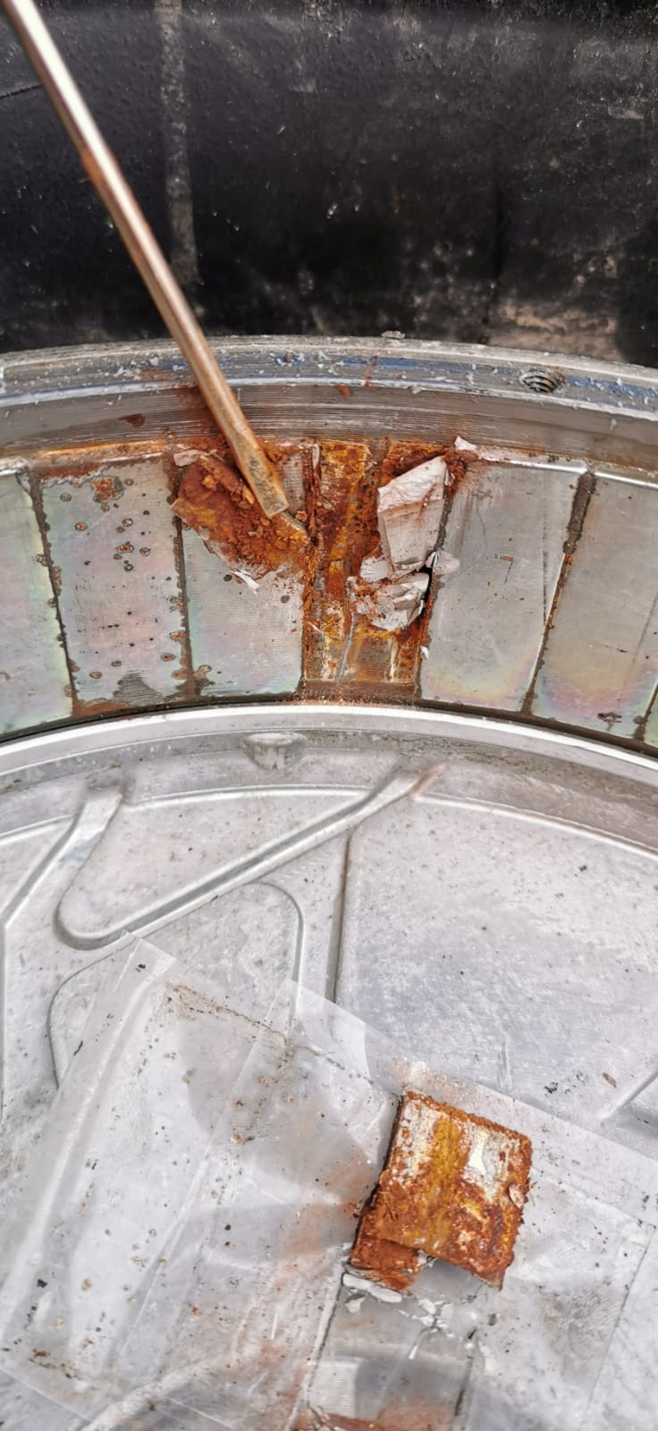

Today I looked again in more detail at the job to replace the magnets. I had started sanding down the bad magnet before realising it was lost magnetism. So, I abandoned doing that.
I realised that the magnet one along was also sticking out. But at the other end, so I did not see it.
This also has the triangle shape. It has also lost its magnetism at the end, too.
So, that is two to replace.
It will be like going to the dentist.
I used my favourite small screwdriver, it is very hard metal. I was sad to abuse it. But it did the job very well.
I just tapped it in behind the magnet. Of course, it broke into pieces, but it came of very easily.
See how the plating was left behind, so it rusted underneath the plating itself.
