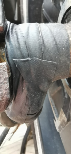

Self amalgamating tape found. Phase wires wrapped better.

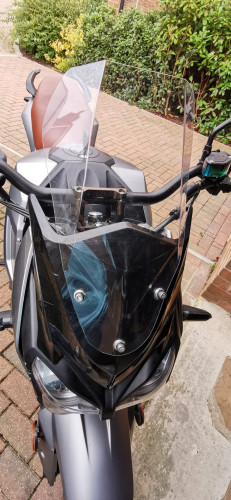

I saw that (back of instrument) when I was trying out a new screen, this is just a prototype using 1mm polycarbonate I cut out for sizing, it will need to be thicker. I am just going to size this up first, see if it works out in riding.

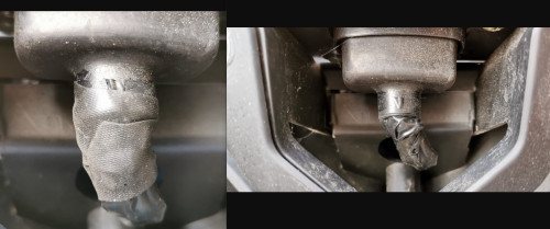

Scratchy-scratchy on the footpeg. Ouch!
I put two layers of heat shrink on the end of the spring, wrapped over each other, but the damage is already done there.

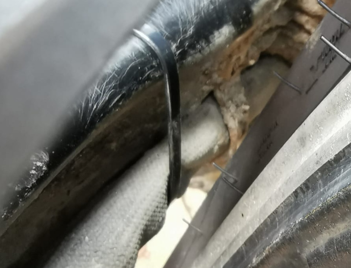

I added an extra cable tie around the phase cables, they are very close to the wheel, I can imagine the rusty clip giving up and all sorts of disaster. So this is just an extra line of safety there.

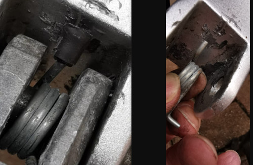

The right hand lock was going over too far and the stop was not engaging before the bars hit the 'tank'.
So I added a large (7.8mm) cable tie to create an extra engagement 'lump'.
It also makes the end lock softer doing this. I tried doing the same on the left, but it kept falling off for some reason, but that side seems OK and does reach the end stop on full lock, though the bars can still scrape the tank a bit.

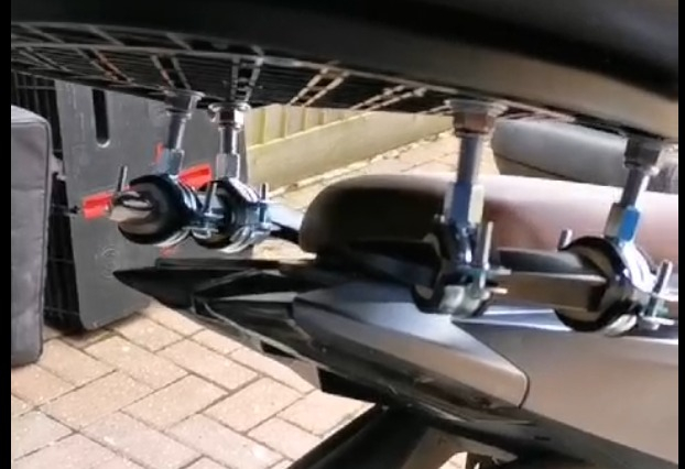

I wanted to add a top box at low cost, so I attached a top box plate to the grab handles using pipe fixings.
This has worked well and it seems secure. I loaded with 10kg of books to test. It did not seem to vibrate or have any problems.
The bike rode much better too. It seems the suspension works better with a higher load at the back.

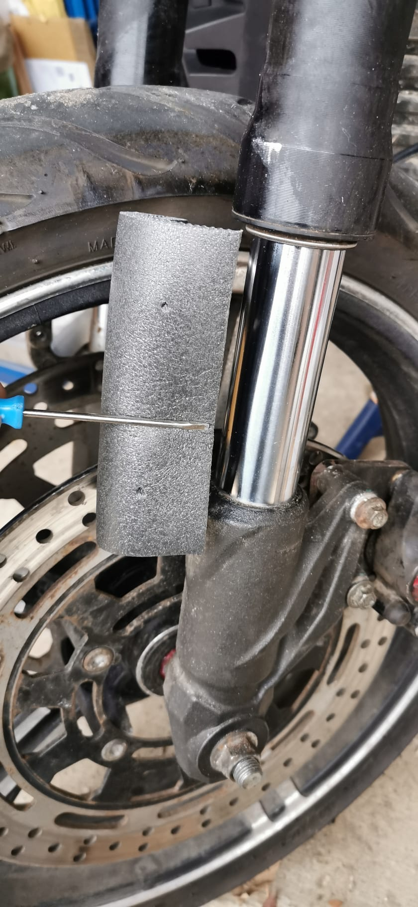

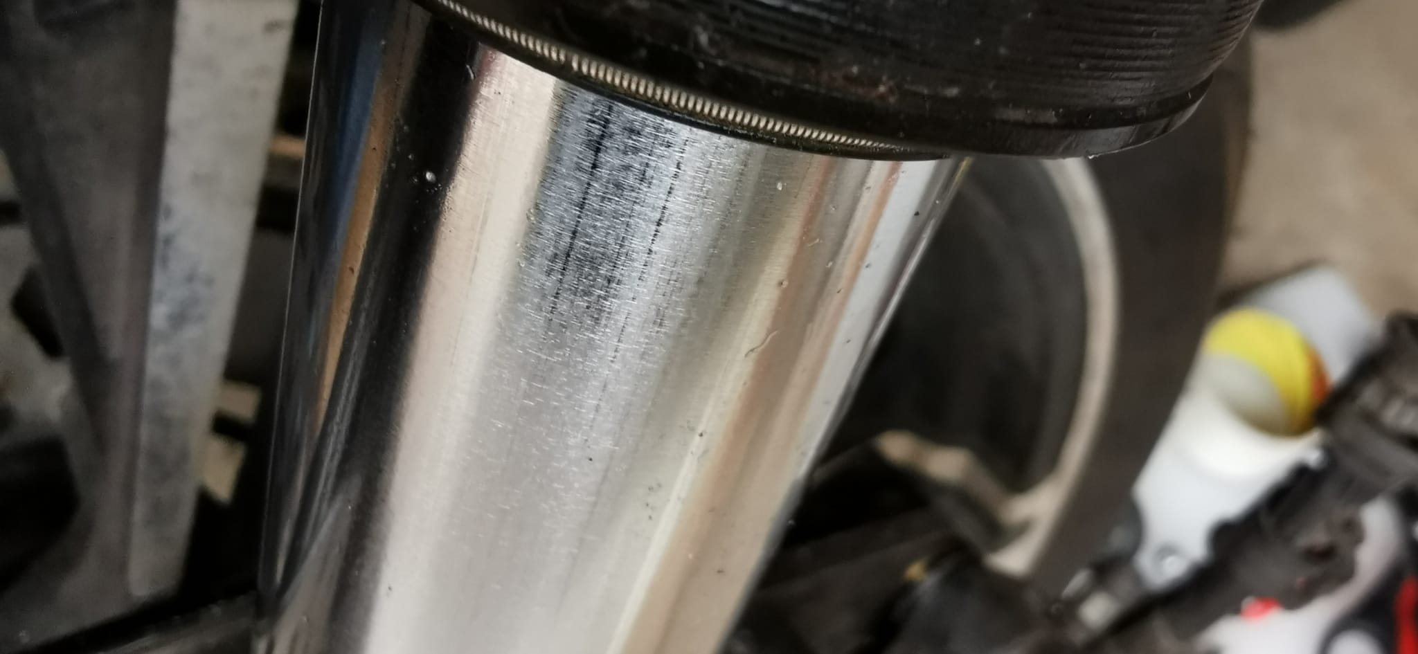

More weather proofing.
The front fender is not good. It leaves mud spraying up, and I notice my stanchions are scratched (from mud being wiped off, I think).
So I added thin foam in this way.
The stanchions now look better protected from spray coming from the front. I will see how this performs.

bob2.0 hat geschrieben:
Mo 28. Okt 2024, 18:28
Wow, forks appear to be VERY misaligned.
It could be just an wrong angle of photo but it hit me in the eye so just for record - space between them has to be same on top as on bottom, that is why there are spacers on front axle.
