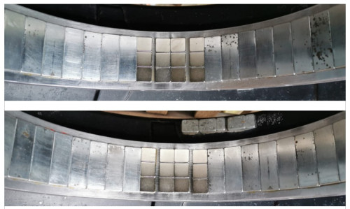

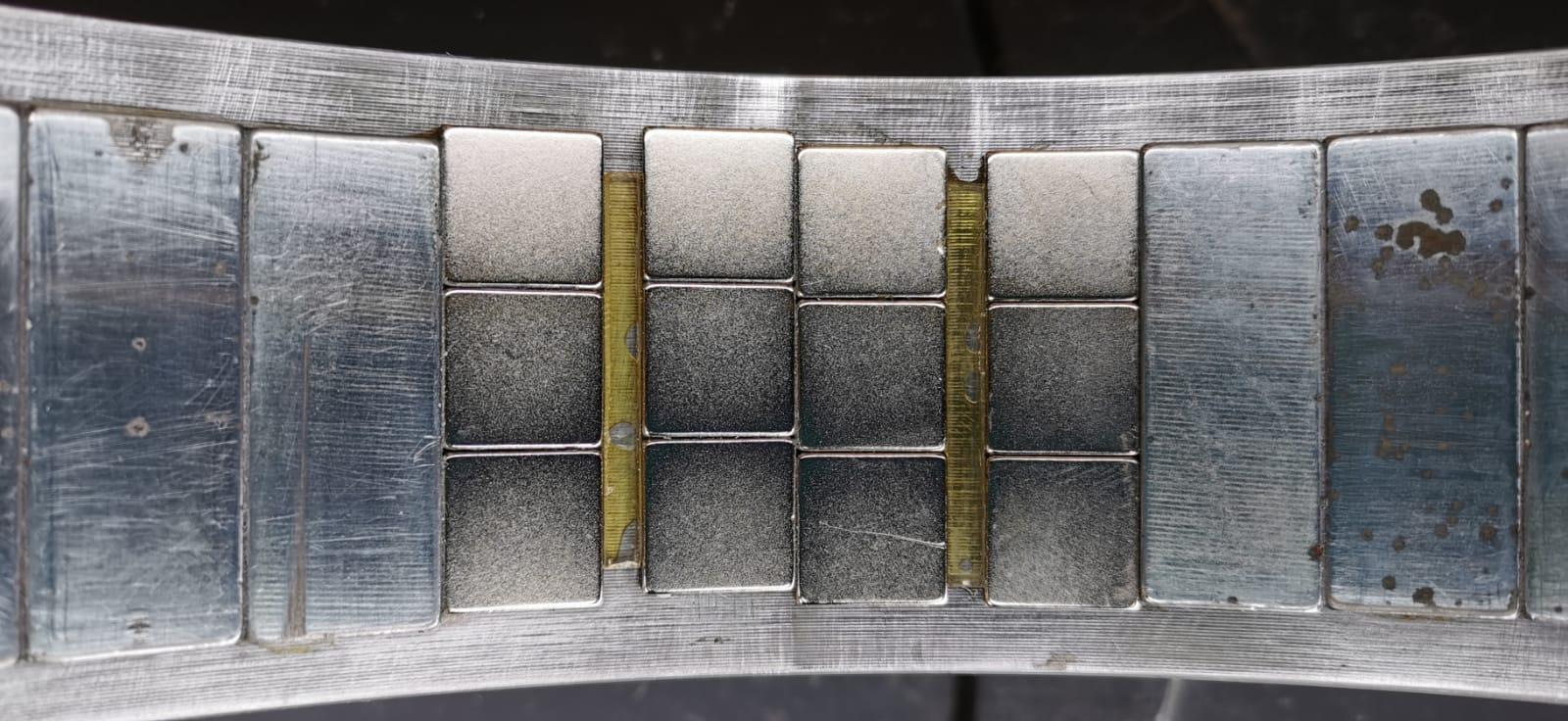

Just to explain my logic of what I am nearly completing.
Each quarter of the motor (12 slots) is getting 8 original magnets back, after cleaning and selection, and 4 of those slots will be the new 3 pack magnets.
This means I will have 16 slots with the smaller magnets, up from just the 3 (which I know worked).
Will the motor still work with that many slots with the smaller magnets in?
I don't know. But I had to commit one way or another, once glued on these are no longer ever going to be 'recyclable'.
I hope it works OK. It's become very boring now and I just want my bike back. This will have been a 4 month long repair, including one failed repair. I suppose I should be glad I discovered all this now than the magnets carrying on rusting and becoming beyond refurbishment.

FWIW and a record of my efforts, the motor now looks like this.
You can see how my plan worked out for locating the smaller magnet sets.
I would have liked to get the alignment better, in hindsight I should have made a simple L-shaped tool to set the distance to the edge of the flange, but I don't think it will have a performance effect :? . I am more concerned if so many of the smaller magnets are up to the job.
I spent an hour cutting strips of polycarbonate to fit in the gaps (I don't think it is necessary with the strength of the glue, but who can say in the very distant future), but only managed 3 of the 8 I needed, as the gaps are all slightly irregular sizes. Tomorrow I will try heating the polycarbonate until it can deform plastically in to the gap. But one way or another, I will finish the job there.
It took 9ml of my 10ml bottle. I think I used just the right amount, not too much nor too little and I resisted using less as the bottle emptied. There is only just enough now to wet the sides as I turn it upside down! If I wait a long while I can get enough drops out to fix the polycarbonate fillers.
In principle, if the smaller magnets do not work properly, I could try to find/order some exact size ones and chisel those off. But I think simply trying to buy a new motor might be the better answer if that happens. Custom magnets are expensive. For reference, I measured them as 45mm x 16.75mm x 2.5mm.
I suspect the smaller magnets will give me slightly less performance at slow speed but perhaps higher speeds (less back EMF beyond constant V/Hz). This is me being optimistic, I just want my nice bike back on the road!
