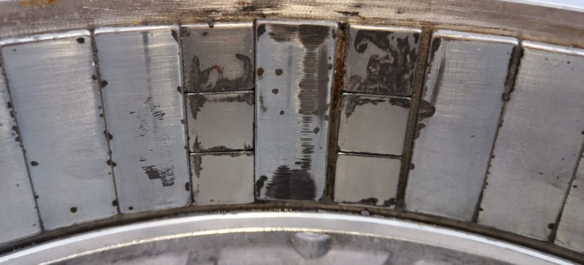

Here are the repaired and glued new magnets before I put it together, and after a light sanding (and before a light oiling).

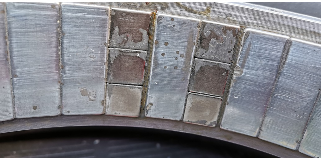

and here it is now, after I have opened it up again
What do you see?
(It's not just a test. Maybe you see something different?)
I'll let you have a look and tell me what you see.
I'm still inspecting the photos. I like to take photos and then go for more coffee, study them. Sometimes it is not quite what you first see.
What do you see?
