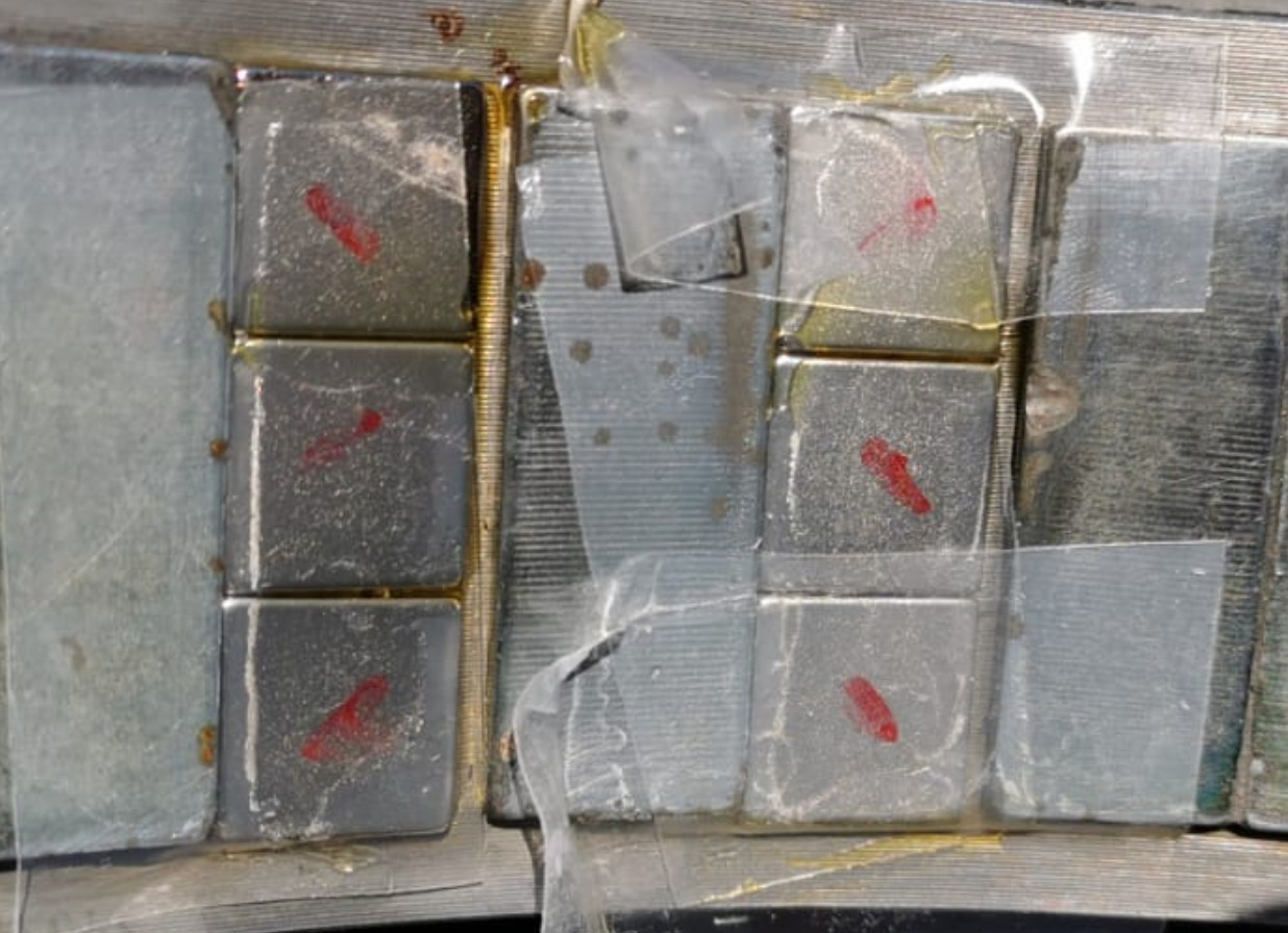

The magnets I will use for the repair;
This is what 'fake' magnets look like;
You can immediately tell these are weak magnets because they do not even have spacers. If they were full strength for neodymium, they would need spacers or you would probably brake them when separating or bringing them together. (The squares came with spacers!)

Yeah, unfortunately there are some black sheeps under these sellers.
Good that you've had your flux meter, so you could deliver concrete evidence.
But not only Chinese vendors sell junk.

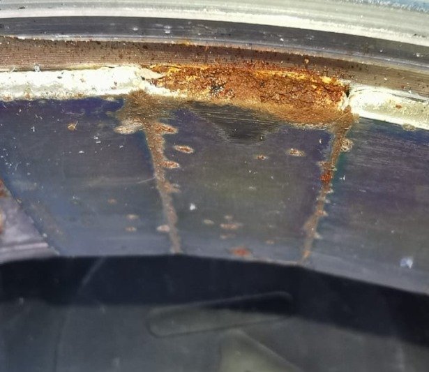

Today, I took the other magnet off that was showing damage.
I thought you might like to see progress.
There are a few interesting points to notice.
I removed the other plate on the rim, and so I could see the other side of the magnets.
Here is the other damaged one.

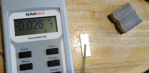

See how there is that little tell-tale triangle. The flux probe showed that the field had been lost here (it actually showed a reverse field, as the flux would pass into it rather than come out of it, if you understand?).
The plating of the edge must have become damaged, rusted, then the magnet swells and pushes into the path of the stator.
I was more gentle this time, and because the magnet was not rusted (weakened), it came off in one piece.

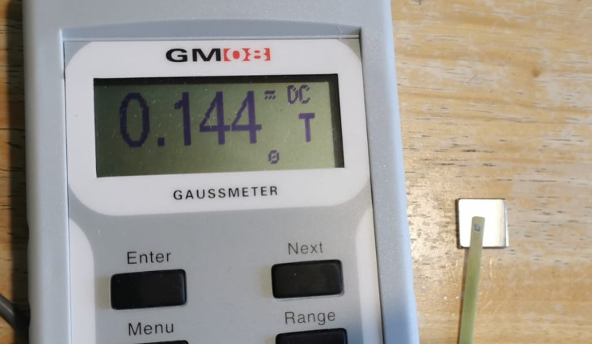

I measured the surface flux on the good end, and it said 0.12T, so I measured the new magnet is stronger than this one!
Here is the gaps now shown for both of the magnets to be replaced.
I did some initial cleaning, I will do more before gluing in the new magnets.
The first thing to see is how the glue is fixed. There is no glue in the middle of the magnet. They have saved glue by only putting it down the edges. I don't think this is a short cut, because it is a flat magnet onto a curved rim (a chord of a circle) so there would be a small gap.
It is this small gap that my small screwdriver fitted behind, so a gentle tapping releases the magnet.
There is no drama. They are not thick magnets. It is not too different to removing a strong fridge magnet. I have seen people express fear at removing these, but there is no issue at all. Easy.
In fact it came off too easily, in my opinion. But we do not hear of these falling off very often, so I guess it does not need much.
I will be using structural adhesive, so, possibly, mine will be a stronger magnet than production, and also glued in more strongly too!
See also, on that one magnet left in the middle, the laminations have been very slightly touching it, leaving those lines. It is possible the corrosion of those two others has already infected this one, and it is also rusting from behind?

I meant it showed a negative flux in the vicinity of the 'V', while the rest of the face was positive flux. It was making a field loop back into itself.About the direction of the field: shouldn't it alter every magnet:... N S N S N S ... and so on?
I don't think that helps the motor work well!

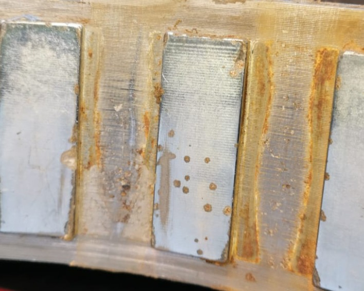

I was thinking about the bad plating on the other magnets.
You might have seen there is even a chip in the magnet next to the new hole? It is where a piece of rust fell out.
How to cover up all the damaged plating?
I cannot decide.
Something that tries to stop moisture might only trap it?
I was thinking of putting a layer of epoxy over bad plating?
Or use lanoline which stays semi-mobile and let humidity out (like on rusty cars).
We talked about this before and I was going to use some automatic transmission fluid, just a film.
But this needs more. Something to help the plating of the bad magnets.
Clear paint (suggested), maybe. Epoxy? Lanoline? I don't know. Maybe just the oil and open it up next year and check everything?

I would just go for a thin film of oil (transmission fluid).
Ok, lanoline melts at about 44 °C. What do you get then: organic oil with a low melting point that might char.
