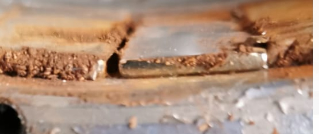

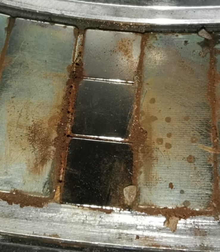

Looking at your pictures, I'm wondering if there was some kind of insulation or (double sided?) adhesive tape underneath the magnet which macerated due to the rust.
Maybe some kind of electric insulation is required, to avoid foucault currents? I don't know.

Magnets normaly get glued with high temperature glue, but if there gets water between the magnets and the housing, rust will grow and this will loosen the magnets.
I would ask QS or Yuma if they can sell fitting magnets to you.

I have asked QS for a replacement motor, because this magnet must have had some sort of plating damage or something. Apart from that second one, the other magnets look good, so this one should not have done this.
I would guess careless handling when fitting left a scratch on the thin end?
But my glue-man is away at the moment, so I will have to wait to make the repair until he can send it to me.
