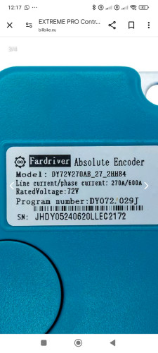

First idea I had was wrong encoder value, my 6kW AMR works with 8192, but if I understand correctly, you tried it and it shows an error. Either it is not an 8192 encoder or it needs a reset/recalibration before autolearn. I would not suspect wiring as first reason because why would chinese guys change anything ? But everything is possible so for sure I would compare wiring = colors with (my) wiring diagram (I made my own because what was on sellers page did not match with wiring).
Did you count pole pairs ? I see 24, mine is 22, with any other value motor does not work at all or stutters etc.
After replacing the controller I changed these values:
Encoder 8192
PolePairs:22
then autolearn
Pause Pin:1-PIN2
Highspeed Pin:2-PIN3
HighLowSpeed:6-Button3SpeedHigh
LowSpeedPin:11-Invalid
BCPosition:2 (other values are same as you have, but I have different display)

In the meantime, I ordered a different controller from fardriver, which arrived after a long wait. With it, I was able to connect to the app and cause the rear wheel to jerk. Unfortunately, despite "self-learning," the result remained the same, even though the "deep encoder setting" had cleared the Hall error indicator. I don't understand what type of error causes the Hall error indicator to light up.
If I swap the controller back for the original one, everything responds normally. I'll swap the battery for the 2.0 AMR soon and try again.
