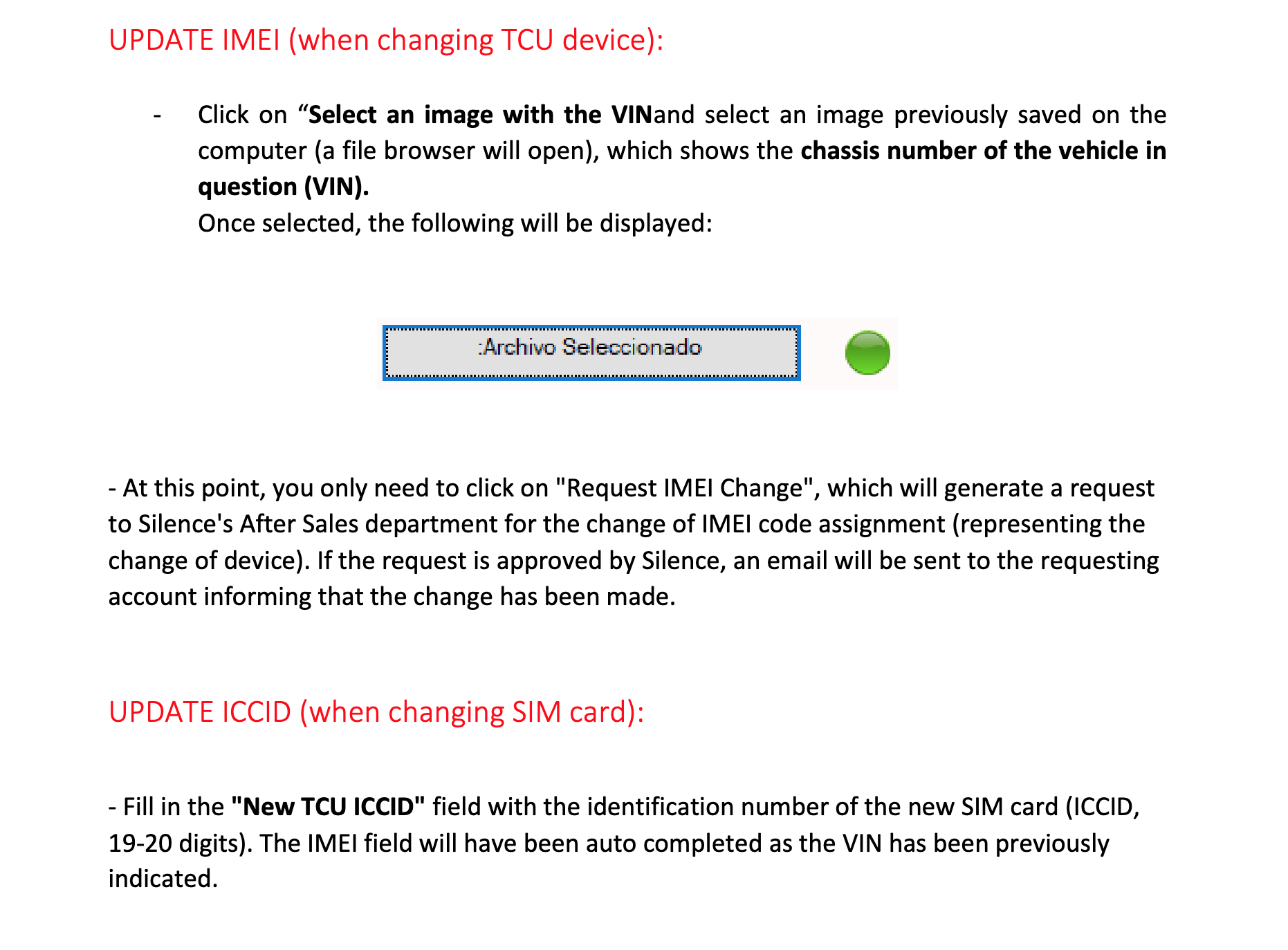

From the Silence Connectivity Diagnostics doku:

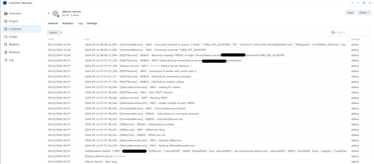

Hello everyone, I would like to announce that we have just released on GutHub the first public Alpha release of the project.
https://github.com/lorenzo-deluca/silen ... ate-server
If anyone wants to give it a try and send us feedback we are available! :)
