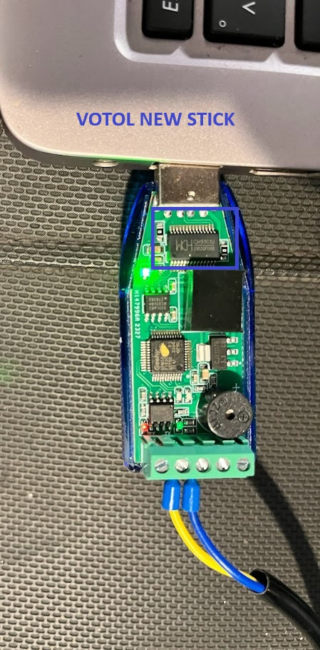

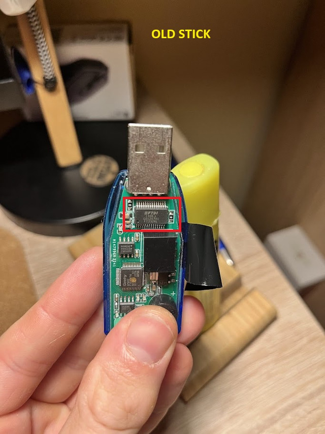

I also bought two sticks, one was “good” (the first one I bought now years ago from an Aliexpress link seen here on the forum) and the other one recently, actually change the serial chips between the two.
I attach “old” and “new” stick photos.
OLD
NEW
With both sticks I really tried a lot... I went a little “crazy”, and with neither of them I succeeded.
The thing I actually noticed is that when I do “RESET” connected to the scooter (which you rightly say not to do...) with both sticks, I hear the relay click and the controller reboots, “MCU TOUT” comes out on the display for a few seconds, evidently because the stick still has a wrong speed interfering with the CAN of the scooter, as you say.
This evening I will try again by doing as you say, configuring the controller unplugged from the scooter and plugging it in only afterwards. i will also pay attention to the change on PAGE3, do you use a specific version of the program? I have a v3.39 - 3.40 and one “patched” by an Indonesian guy, tried all 3 of course.
Also, when you plug it into the scooter is the scooter already on or do you turn it on later?
When should it automatically adjust the CAN speed?
Thanks again!

What I declare for sure: Neither the USB-serial converter chip (FDTI vs WCH 9101) nor the used windows driver has any effect for a working or not working connection.
