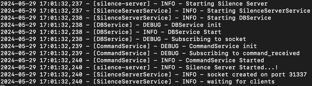

Thanks for the project! I cloned it on my Raspi, forwarded the port to it and configured the $IPAD and $PORT in the Astra module and also see the module sending the data to the correct ip and port, but the script output doesn't show any incoming traffic (should it do that?) I have a static public ip address.

SpeedCore hat geschrieben:
Mi 29. Mai 2024, 19:00
Good job ;)
yes, you should see a message like this:
" [SilenceServerService] - INFO - client ('scooter-ip', random-port) connected "
Are you sure you forwarded the port correctly? there are no firewalls in the way? Is the configured port on the module 31337?

My bad, had a typo in the port forwarding :roll:
Looking good now!

2024-05-29 21:20:39,316 - [SilenceServerService] - INFO - bridge mode, try to connect to Silence server
2024-05-29 21:20:39,333 - [SilenceServerService] - INFO - connected to silence
2024-05-29 21:20:39,348 - [SilenceServerService] - INFO - receive data bytearray(b'\x06')
2024-05-29 21:20:39,348 - [DBService] - DEBUG - Received message from S: bytearray(b'\x06')
2024-05-29 21:20:49,364 - [SilenceServerService] - INFO - login correct sending ack
2024-05-29 21:21:04,388 - [SilenceServerService] - INFO - sent ack to scooter
2024-05-29 21:21:19,614 - [SilenceServerService] - INFO - sent ack to scooter
2024-05-29 21:21:34,839 - [SilenceServerService] - INFO - sent ack to scooter
2024-05-29 21:21:50,066 - [SilenceServerService] - INFO - sent ack to scooter
2024-05-29 21:22:05,291 - [SilenceServerService] - INFO - sent ack to scooter
2024-05-29 21:22:20,517 - [SilenceServerService] - INFO - sent ack to scooter
2024-05-29 21:22:35,742 - [SilenceServerService] - INFO - sent ack to scooter
2024-05-29 21:22:50,968 - [SilenceServerService] - INFO - sent ack to scooter
2024-05-29 21:23:06,194 - [SilenceServerService] - INFO - sent ack to scooter
2024-05-29 21:23:15,353 - [SilenceServerService] - INFO - receive data bytearray(b'Z\x00b\x01\xb8\x00\x01\x00\x00\x00/S\x82C"\x00\x00\x00\x01\x00\x08>ZS\x82C!\x02\xfa\x9c\xf6\x00}\x06\x85\x00\x00\x03\n\x00\x00\x00\x00\x00\x00\x00\x00\x00\x01{N\x14\x14\x02%\x00\x00\x00\x00\x10o\x00\x00\x00\x00\x00\x00\x00C\x00\x00\x00\x00\x00$\xdd\x98\x00\x02\x13\xc6\x00"m\xf7\x15\x00\x00\x00(\xf9\x00\x00\x00\x00\x00\tr')
2024-05-29 21:23:15,353 - [DBService] - DEBUG - Received message from A: bytearray(b'Z\x00b\x01\xb8\x00\x01\x00\x00\x00/S\x82C"\x00\x00\x00\x01\x00\x08>ZS\x82C!\x02\xfa\x9c\xf6\x00}\x06\x85\x00\x00\x03\n\x00\x00\x00\x00\x00\x00\x00\x00\x00\x01{N\x14\x14\x02%\x00\x00\x00\x00\x10o\x00\x00\x00\x00\x00\x00\x00C\x00\x00\x00\x00\x00$\xdd\x98\x00\x02\x13\xc6\x00"m\xf7\x15\x00\x00\x00(\xf9\x00\x00\x00\x00\x00\tr')
2024-05-29 21:23:15,560 - [SilenceServerService] - INFO - received status from scooter
2024-05-29 21:23:15,560 - [messageParser] - DEBUG - Parse received message protocol Z from scooter: bytearray(b'Z\x00b\x01\xb8\x00\x01\x00\x00\x00/S\x82C"\x00\x00\x00\x01\x00\x08>ZS\x82C!\x02\xfa\x9c\xf6\x00}\x06\x85\x00\x00\x03\n\x00\x00\x00\x00\x00\x00\x00\x00\x00\x01{N\x14\x14\x02%\x00\x00\x00\x00\x10o\x00\x00\x00\x00\x00\x00\x00C\x00\x00\x00\x00\x00$\xdd\x98\x00\x02\x13\xc6\x00"m\xf7\x15\x00\x00\x00(\xf9\x00\x00\x00\x00\x00\tr')
2024-05-29 21:23:15,560 - [messageParser] - DEBUG - Message protocol Z parsed: {'status': {'value': None, 'MQTT_topic': 'status'}, 'movementAlarm': {'value': None, 'MQTT_topic': 'movementAlarm'}, 'batteryIn': {'value': None, 'MQTT_topic': 'batteryIn'}, 'astraBatterySOC': {'value': None, 'MQTT_topic': 'astraBatterySOC'}, 'latitude': {'value': None, 'MQTT_topic': 'latitude'}, 'longitude': {'value': None, 'MQTT_topic': 'longitude'}, 'batterySOC': {'value': None, 'MQTT_topic': 'SOCbatteria'}, 'batteryTempMax': {'value': None, 'MQTT_topic': 'BatteryTempMax'}, 'batteryTempMin': {'value': None, 'MQTT_topic': 'BatteryTempMin'}, 'batteryVoltage': {'value': None, 'MQTT_topic': 'VOLTbatteria'}, 'batteryCurrent': {'value': None, 'MQTT_topic': 'batteryCurrent'}, 'motorTemp': {'value': 'None', 'MQTT_topic': 'motorTemp'}, 'inverterTemp': {'value': 'None', 'MQTT_topic': 'inverterTemp'}, 'speed': {'value': 'None', 'MQTT_topic': 'speed'}, 'range': {'value': None, 'MQTT_topic': 'range'}, 'chargedEnergy': {'value': None, 'MQTT_topic': 'chargedEnergy'}, 'RegeneratedEnergy': {'value': None, 'MQTT_topic': 'RegeneratedEnergy'}, 'DischargedEnergy': {'value': None, 'MQTT_topic': 'DischargedEnergy'}, 'ambientTemp': {'value': 'None', 'MQTT_topic': 'ambientTemp'}, 'odo': {'value': None, 'MQTT_topic': 'odo'}, 'VIN': {'value': None, 'MQTT_topic': 'VIN'}, 'Cell1Voltage': {'value': None, 'MQTT_topic': 'Cell1Voltage'}, 'Cell2Voltage': {'value': None, 'MQTT_topic': 'Cell2Voltage'}, 'Cell3Voltage': {'value': None, 'MQTT_topic': 'Cell3Voltage'}, 'Cell4Voltage': {'value': None, 'MQTT_topic': 'Cell4Voltage'}, 'Cell5Voltage': {'value': None, 'MQTT_topic': 'Cell5Voltage'}, 'Cell6Voltage': {'value': None, 'MQTT_topic': 'Cell6Voltage'}, 'Cell7Voltage': {'value': None, 'MQTT_topic': 'Cell7Voltage'}, 'Cell8Voltage': {'value': None, 'MQTT_topic': 'Cell8Voltage'}, 'Cell9Voltage': {'value': None, 'MQTT_topic': 'Cell9Voltage'}, 'Cell10Voltage': {'value': None, 'MQTT_topic': 'Cell10Voltage'}, 'Cell11Voltage': {'value': None, 'MQTT_topic': 'Cell11Voltage'}, 'Cell12Voltage': {'value': None, 'MQTT_topic': 'Cell12Voltage'}, 'Cell13Voltage': {'value': None, 'MQTT_topic': 'Cell13Voltage'}, 'Cell14Voltage': {'value': None, 'MQTT_topic': 'Cell14Voltage'}}
2024-05-29 21:23:15,560 - [MQTTService] - DEBUG - Publishing scooter status: {'status': {'value': None, 'MQTT_topic': 'status'}, 'movementAlarm': {'value': None, 'MQTT_topic': 'movementAlarm'}, 'batteryIn': {'value': None, 'MQTT_topic': 'batteryIn'}, 'astraBatterySOC': {'value': None, 'MQTT_topic': 'astraBatterySOC'}, 'latitude': {'value': None, 'MQTT_topic': 'latitude'}, 'longitude': {'value': None, 'MQTT_topic': 'longitude'}, 'batterySOC': {'value': None, 'MQTT_topic': 'SOCbatteria'}, 'batteryTempMax': {'value': None, 'MQTT_topic': 'BatteryTempMax'}, 'batteryTempMin': {'value': None, 'MQTT_topic': 'BatteryTempMin'}, 'batteryVoltage': {'value': None, 'MQTT_topic': 'VOLTbatteria'}, 'batteryCurrent': {'value': None, 'MQTT_topic': 'batteryCurrent'}, 'motorTemp': {'value': 'None', 'MQTT_topic': 'motorTemp'}, 'inverterTemp': {'value': 'None', 'MQTT_topic': 'inverterTemp'}, 'speed': {'value': 'None', 'MQTT_topic': 'speed'}, 'range': {'value': None, 'MQTT_topic': 'range'}, 'chargedEnergy': {'value': None, 'MQTT_topic': 'chargedEnergy'}, 'RegeneratedEnergy': {'value': None, 'MQTT_topic': 'RegeneratedEnergy'}, 'DischargedEnergy': {'value': None, 'MQTT_topic': 'DischargedEnergy'}, 'ambientTemp': {'value': 'None', 'MQTT_topic': 'ambientTemp'}, 'odo': {'value': None, 'MQTT_topic': 'odo'}, 'VIN': {'value': None, 'MQTT_topic': 'VIN'}, 'Cell1Voltage': {'value': None, 'MQTT_topic': 'Cell1Voltage'}, 'Cell2Voltage': {'value': None, 'MQTT_topic': 'Cell2Voltage'}, 'Cell3Voltage': {'value': None, 'MQTT_topic': 'Cell3Voltage'}, 'Cell4Voltage': {'value': None, 'MQTT_topic': 'Cell4Voltage'}, 'Cell5Voltage': {'value': None, 'MQTT_topic': 'Cell5Voltage'}, 'Cell6Voltage': {'value': None, 'MQTT_topic': 'Cell6Voltage'}, 'Cell7Voltage': {'value': None, 'MQTT_topic': 'Cell7Voltage'}, 'Cell8Voltage': {'value': None, 'MQTT_topic': 'Cell8Voltage'}, 'Cell9Voltage': {'value': None, 'MQTT_topic': 'Cell9Voltage'}, 'Cell10Voltage': {'value': None, 'MQTT_topic': 'Cell10Voltage'}, 'Cell11Voltage': {'value': None, 'MQTT_topic': 'Cell11Voltage'}, 'Cell12Voltage': {'value': None, 'MQTT_topic': 'Cell12Voltage'}, 'Cell13Voltage': {'value': None, 'MQTT_topic': 'Cell13Voltage'}, 'Cell14Voltage': {'value': None, 'MQTT_topic': 'Cell14Voltage'}}
2024-05-29 21:23:15,561 - [MQTTService] - DEBUG - Publishing on topic [mySilence/35xxxx/status/motorTemp] value: None
2024-05-29 21:23:15,561 - [MQTTService] - DEBUG - Publishing on topic [mySilence/35xxxx/status/inverterTemp] value: None
2024-05-29 21:23:15,561 - [MQTTService] - DEBUG - Publishing on topic [mySilence/35xxxx/status/speed] value: None
2024-05-29 21:23:15,562 - [MQTTService] - DEBUG - Publishing on topic [mySilence/35xxxx/status/ambientTemp] value: None
2024-05-29 21:23:15,562 - [MQTTService] - DEBUG - Publishing on topic [mySilence/35xxxxx/status/last-update] value: 1717010595.562439
2024-05-29 21:23:15,562 - [SilenceServerService] - INFO - sent to silence
2024-05-29 21:23:15,578 - [SilenceServerService] - INFO - receive data bytearray(b'\x06')
2024-05-29 21:23:15,578 - [DBService] - DEBUG - Received message from S: bytearray(b'\x06')
2024-05-29 21:23:15,785 - [SilenceServerService] - INFO - sent to scooter the data from silence bytearray(b'\x06')
2024-05-29 21:23:21,195 - [SilenceServerService] - INFO - sent ack to scooter
2024-05-29 21:23:36,421 - [SilenceServerService] - INFO - sent ack to scooter
2024-05-29 21:23:51,647 - [SilenceServerService] - INFO - sent ack to scooter
2024-05-29 21:24:06,873 - [SilenceServerService] - INFO - sent ack to scooter
2024-05-29 21:24:22,099 - [SilenceServerService] - INFO - sent ack to scooter
2024-05-29 21:24:37,324 - [SilenceServerService] - INFO - sent ack to scooter
2024-05-29 21:24:52,551 - [SilenceServerService] - INFO - sent ack to scooter
2024-05-29 21:25:07,777 - [SilenceServerService] - INFO - sent ack to scooter
2024-05-29 21:25:23,003 - [SilenceServerService] - INFO - sent ack to scooter
2024-05-29 21:25:38,230 - [SilenceServerService] - INFO - sent ack to scooter
2024-05-29 21:25:53,456 - [SilenceServerService] - INFO - sent ack to scooter
2024-05-29 21:25:59,065 - [SilenceServerService] - INFO - receive data bytearray(b'$STMS')
2024-05-29 21:25:59,066 - [DBService] - DEBUG - Received message from S: bytearray(b'$STMS')
2024-05-29 21:25:59,072 - [SilenceServerService] - INFO - sent to scooter the data from silence bytearray(b'$STMS')
2024-05-29 21:26:00,675 - [SilenceServerService] - INFO - receive data bytearray(b'$STMS,0,78,20,20,549,0,4207,0,0,0,0,0,67,0,2416024,136134,2256375,21,08xxxxx,+8xxxxxxx,UCYS01300xxxxxxx\r\n')
2024-05-29 21:26:00,676 - [DBService] - DEBUG - Received message from A: bytearray(b'$STMS,0,78,20,20,549,0,4207,0,0,0,0,0,67,0,2416024,136134,2256375,21,08xxxxxx,+8xxxxxxx,UCYS01300xxxxxx\r\n')
2024-05-29 21:26:00,882 - [SilenceServerService] - INFO - received status from scooter
2024-05-29 21:26:00,882 - [messageParser] - DEBUG - Parse received message protocol astra from scooter: bytearray(b'$STMS,0,78,20,20,549,0,4207,0,0,0,0,0,67,0,2416024,136134,2256375,21,08xxxxxxx,+8xxxxx,UCYS01300xxxxx\r\n')
2024-05-29 21:26:00,882 - [messageParser] - DEBUG - Message protocol astra parsed: {'status': {'value': None, 'MQTT_topic': 'status'}, 'movementAlarm': {'value': None, 'MQTT_topic': 'movementAlarm'}, 'batteryIn': {'value': None, 'MQTT_topic': 'batteryIn'}, 'astraBatterySOC': {'value': None, 'MQTT_topic': 'astraBatterySOC'}, 'latitude': {'value': None, 'MQTT_topic': 'latitude'}, 'longitude': {'value': None, 'MQTT_topic': 'longitude'}, 'batterySOC': {'value': None, 'MQTT_topic': 'SOCbatteria'}, 'batteryTempMax': {'value': None, 'MQTT_topic': 'BatteryTempMax'}, 'batteryTempMin': {'value': None, 'MQTT_topic': 'BatteryTempMin'}, 'batteryVoltage': {'value': None, 'MQTT_topic': 'VOLTbatteria'}, 'batteryCurrent': {'value': None, 'MQTT_topic': 'batteryCurrent'}, 'motorTemp': {'value': 'None', 'MQTT_topic': 'motorTemp'}, 'inverterTemp': {'value': 'None', 'MQTT_topic': 'inverterTemp'}, 'speed': {'value': 'None', 'MQTT_topic': 'speed'}, 'range': {'value': None, 'MQTT_topic': 'range'}, 'chargedEnergy': {'value': None, 'MQTT_topic': 'chargedEnergy'}, 'RegeneratedEnergy': {'value': None, 'MQTT_topic': 'RegeneratedEnergy'}, 'DischargedEnergy': {'value': None, 'MQTT_topic': 'DischargedEnergy'}, 'ambientTemp': {'value': 'None', 'MQTT_topic': 'ambientTemp'}, 'odo': {'value': None, 'MQTT_topic': 'odo'}, 'VIN': {'value': None, 'MQTT_topic': 'VIN'}, 'Cell1Voltage': {'value': None, 'MQTT_topic': 'Cell1Voltage'}, 'Cell2Voltage': {'value': None, 'MQTT_topic': 'Cell2Voltage'}, 'Cell3Voltage': {'value': None, 'MQTT_topic': 'Cell3Voltage'}, 'Cell4Voltage': {'value': None, 'MQTT_topic': 'Cell4Voltage'}, 'Cell5Voltage': {'value': None, 'MQTT_topic': 'Cell5Voltage'}, 'Cell6Voltage': {'value': None, 'MQTT_topic': 'Cell6Voltage'}, 'Cell7Voltage': {'value': None, 'MQTT_topic': 'Cell7Voltage'}, 'Cell8Voltage': {'value': None, 'MQTT_topic': 'Cell8Voltage'}, 'Cell9Voltage': {'value': None, 'MQTT_topic': 'Cell9Voltage'}, 'Cell10Voltage': {'value': None, 'MQTT_topic': 'Cell10Voltage'}, 'Cell11Voltage': {'value': None, 'MQTT_topic': 'Cell11Voltage'}, 'Cell12Voltage': {'value': None, 'MQTT_topic': 'Cell12Voltage'}, 'Cell13Voltage': {'value': None, 'MQTT_topic': 'Cell13Voltage'}, 'Cell14Voltage': {'value': None, 'MQTT_topic': 'Cell14Voltage'}}
2024-05-29 21:26:00,882 - [MQTTService] - DEBUG - Publishing scooter status: {'status': {'value': None, 'MQTT_topic': 'status'}, 'movementAlarm': {'value': None, 'MQTT_topic': 'movementAlarm'}, 'batteryIn': {'value': None, 'MQTT_topic': 'batteryIn'}, 'astraBatterySOC': {'value': None, 'MQTT_topic': 'astraBatterySOC'}, 'latitude': {'value': None, 'MQTT_topic': 'latitude'}, 'longitude': {'value': None, 'MQTT_topic': 'longitude'}, 'batterySOC': {'value': None, 'MQTT_topic': 'SOCbatteria'}, 'batteryTempMax': {'value': None, 'MQTT_topic': 'BatteryTempMax'}, 'batteryTempMin': {'value': None, 'MQTT_topic': 'BatteryTempMin'}, 'batteryVoltage': {'value': None, 'MQTT_topic': 'VOLTbatteria'}, 'batteryCurrent': {'value': None, 'MQTT_topic': 'batteryCurrent'}, 'motorTemp': {'value': 'None', 'MQTT_topic': 'motorTemp'}, 'inverterTemp': {'value': 'None', 'MQTT_topic': 'inverterTemp'}, 'speed': {'value': 'None', 'MQTT_topic': 'speed'}, 'range': {'value': None, 'MQTT_topic': 'range'}, 'chargedEnergy': {'value': None, 'MQTT_topic': 'chargedEnergy'}, 'RegeneratedEnergy': {'value': None, 'MQTT_topic': 'RegeneratedEnergy'}, 'DischargedEnergy': {'value': None, 'MQTT_topic': 'DischargedEnergy'}, 'ambientTemp': {'value': 'None', 'MQTT_topic': 'ambientTemp'}, 'odo': {'value': None, 'MQTT_topic': 'odo'}, 'VIN': {'value': None, 'MQTT_topic': 'VIN'}, 'Cell1Voltage': {'value': None, 'MQTT_topic': 'Cell1Voltage'}, 'Cell2Voltage': {'value': None, 'MQTT_topic': 'Cell2Voltage'}, 'Cell3Voltage': {'value': None, 'MQTT_topic': 'Cell3Voltage'}, 'Cell4Voltage': {'value': None, 'MQTT_topic': 'Cell4Voltage'}, 'Cell5Voltage': {'value': None, 'MQTT_topic': 'Cell5Voltage'}, 'Cell6Voltage': {'value': None, 'MQTT_topic': 'Cell6Voltage'}, 'Cell7Voltage': {'value': None, 'MQTT_topic': 'Cell7Voltage'}, 'Cell8Voltage': {'value': None, 'MQTT_topic': 'Cell8Voltage'}, 'Cell9Voltage': {'value': None, 'MQTT_topic': 'Cell9Voltage'}, 'Cell10Voltage': {'value': None, 'MQTT_topic': 'Cell10Voltage'}, 'Cell11Voltage': {'value': None, 'MQTT_topic': 'Cell11Voltage'}, 'Cell12Voltage': {'value': None, 'MQTT_topic': 'Cell12Voltage'}, 'Cell13Voltage': {'value': None, 'MQTT_topic': 'Cell13Voltage'}, 'Cell14Voltage': {'value': None, 'MQTT_topic': 'Cell14Voltage'}}
2024-05-29 21:26:00,882 - [MQTTService] - DEBUG - Publishing on topic [mySilence/35xxxx/status/motorTemp] value: None
2024-05-29 21:26:00,883 - [MQTTService] - DEBUG - Publishing on topic [mySilence/35xxxx/status/inverterTemp] value: None
2024-05-29 21:26:00,883 - [MQTTService] - DEBUG - Publishing on topic [mySilence/35xxxx/status/speed] value: None
2024-05-29 21:26:00,883 - [MQTTService] - DEBUG - Publishing on topic [mySilence/35xxxxx/status/ambientTemp] value: None
2024-05-29 21:26:00,884 - [MQTTService] - DEBUG - Publishing on topic [mySilence/35xxxxx/status/last-update] value: 1717010760.8841224
2024-05-29 21:26:00,884 - [SilenceServerService] - INFO - sent to silence
2024-05-29 21:26:08,497 - [SilenceServerService] - INFO - sent ack to scooter
2024-05-29 21:26:23,722 - [SilenceServerService] - INFO - sent ack to scooter
2024-05-29 21:26:38,948 - [SilenceServerService] - INFO - sent ack to scooter
2024-05-29 21:26:54,173 - [SilenceServerService] - INFO - sent ack to scooter
2024-05-29 21:27:09,399 - [SilenceServerService] - INFO - sent ack to scooter
2024-05-29 21:27:24,626 - [SilenceServerService] - INFO - sent ack to scooter
2024-05-29 21:27:39,852 - [SilenceServerService] - INFO - sent ack to scooter
2024-05-29 21:27:55,078 - [SilenceServerService] - INFO - sent ack to scooter
2024-05-29 21:28:10,305 - [SilenceServerService] - INFO - sent ack to scooter
2024-05-29 21:28:15,315 - [SilenceServerService] - INFO - receive data bytearray(b'Z\x00b\x01\xb9\x00\x01\x00\x00\x00/S\x82DN\x00\x00\x00\x01\x00\x08>ZS\x82DM\x02\xfa\x9c\xfe\x00}\x06z\x00\x00\xa9\n\x00\x00\x00\x00\x00\x00\x00\x00\x00\x01mN\x14\x14\x02%\x00\x00\x00\x00\x10o\x00\x00\x00\x00\x00\x00\x00C\x00\x00\x00\x00\x00$\xdd\x98\x00\x02\x13\xc6\x00"m\xf7\x15\x00\x00\x00(\xf9\x00\x00\x00\x00\x00;t')
2024-05-29 21:28:15,315 - [DBService] - DEBUG - Received message from A: bytearray(b'Z\x00b\x01\xb9\x00\x01\x00\x00\x00/S\x82DN\x00\x00\x00\x01\x00\x08>ZS\x82DM\x02\xfa\x9c\xfe\x00}\x06z\x00\x00\xa9\n\x00\x00\x00\x00\x00\x00\x00\x00\x00\x01mN\x14\x14\x02%\x00\x00\x00\x00\x10o\x00\x00\x00\x00\x00\x00\x00C\x00\x00\x00\x00\x00$\xdd\x98\x00\x02\x13\xc6\x00"m\xf7\x15\x00\x00\x00(\xf9\x00\x00\x00\x00\x00;t')
2024-05-29 21:28:15,521 - [SilenceServerService] - INFO - received status from scooter
2024-05-29 21:28:15,521 - [messageParser] - DEBUG - Parse received message protocol Z from scooter: bytearray(b'Z\x00b\x01\xb9\x00\x01\x00\x00\x00/S\x82DN\x00\x00\x00\x01\x00\x08>ZS\x82DM\x02\xfa\x9c\xfe\x00}\x06z\x00\x00\xa9\n\x00\x00\x00\x00\x00\x00\x00\x00\x00\x01mN\x14\x14\x02%\x00\x00\x00\x00\x10o\x00\x00\x00\x00\x00\x00\x00C\x00\x00\x00\x00\x00$\xdd\x98\x00\x02\x13\xc6\x00"m\xf7\x15\x00\x00\x00(\xf9\x00\x00\x00\x00\x00;t')
2024-05-29 21:28:15,522 - [messageParser] - DEBUG - Message protocol Z parsed: {'status': {'value': None, 'MQTT_topic': 'status'}, 'movementAlarm': {'value': None, 'MQTT_topic': 'movementAlarm'}, 'batteryIn': {'value': None, 'MQTT_topic': 'batteryIn'}, 'astraBatterySOC': {'value': None, 'MQTT_topic': 'astraBatterySOC'}, 'latitude': {'value': None, 'MQTT_topic': 'latitude'}, 'longitude': {'value': None, 'MQTT_topic': 'longitude'}, 'batterySOC': {'value': None, 'MQTT_topic': 'SOCbatteria'}, 'batteryTempMax': {'value': None, 'MQTT_topic': 'BatteryTempMax'}, 'batteryTempMin': {'value': None, 'MQTT_topic': 'BatteryTempMin'}, 'batteryVoltage': {'value': None, 'MQTT_topic': 'VOLTbatteria'}, 'batteryCurrent': {'value': None, 'MQTT_topic': 'batteryCurrent'}, 'motorTemp': {'value': 'None', 'MQTT_topic': 'motorTemp'}, 'inverterTemp': {'value': 'None', 'MQTT_topic': 'inverterTemp'}, 'speed': {'value': 'None', 'MQTT_topic': 'speed'}, 'range': {'value': None, 'MQTT_topic': 'range'}, 'chargedEnergy': {'value': None, 'MQTT_topic': 'chargedEnergy'}, 'RegeneratedEnergy': {'value': None, 'MQTT_topic': 'RegeneratedEnergy'}, 'DischargedEnergy': {'value': None, 'MQTT_topic': 'DischargedEnergy'}, 'ambientTemp': {'value': 'None', 'MQTT_topic': 'ambientTemp'}, 'odo': {'value': None, 'MQTT_topic': 'odo'}, 'VIN': {'value': None, 'MQTT_topic': 'VIN'}, 'Cell1Voltage': {'value': None, 'MQTT_topic': 'Cell1Voltage'}, 'Cell2Voltage': {'value': None, 'MQTT_topic': 'Cell2Voltage'}, 'Cell3Voltage': {'value': None, 'MQTT_topic': 'Cell3Voltage'}, 'Cell4Voltage': {'value': None, 'MQTT_topic': 'Cell4Voltage'}, 'Cell5Voltage': {'value': None, 'MQTT_topic': 'Cell5Voltage'}, 'Cell6Voltage': {'value': None, 'MQTT_topic': 'Cell6Voltage'}, 'Cell7Voltage': {'value': None, 'MQTT_topic': 'Cell7Voltage'}, 'Cell8Voltage': {'value': None, 'MQTT_topic': 'Cell8Voltage'}, 'Cell9Voltage': {'value': None, 'MQTT_topic': 'Cell9Voltage'}, 'Cell10Voltage': {'value': None, 'MQTT_topic': 'Cell10Voltage'}, 'Cell11Voltage': {'value': None, 'MQTT_topic': 'Cell11Voltage'}, 'Cell12Voltage': {'value': None, 'MQTT_topic': 'Cell12Voltage'}, 'Cell13Voltage': {'value': None, 'MQTT_topic': 'Cell13Voltage'}, 'Cell14Voltage': {'value': None, 'MQTT_topic': 'Cell14Voltage'}}
2024-05-29 21:28:15,522 - [MQTTService] - DEBUG - Publishing scooter status: {'status': {'value': None, 'MQTT_topic': 'status'}, 'movementAlarm': {'value': None, 'MQTT_topic': 'movementAlarm'}, 'batteryIn': {'value': None, 'MQTT_topic': 'batteryIn'}, 'astraBatterySOC': {'value': None, 'MQTT_topic': 'astraBatterySOC'}, 'latitude': {'value': None, 'MQTT_topic': 'latitude'}, 'longitude': {'value': None, 'MQTT_topic': 'longitude'}, 'batterySOC': {'value': None, 'MQTT_topic': 'SOCbatteria'}, 'batteryTempMax': {'value': None, 'MQTT_topic': 'BatteryTempMax'}, 'batteryTempMin': {'value': None, 'MQTT_topic': 'BatteryTempMin'}, 'batteryVoltage': {'value': None, 'MQTT_topic': 'VOLTbatteria'}, 'batteryCurrent': {'value': None, 'MQTT_topic': 'batteryCurrent'}, 'motorTemp': {'value': 'None', 'MQTT_topic': 'motorTemp'}, 'inverterTemp': {'value': 'None', 'MQTT_topic': 'inverterTemp'}, 'speed': {'value': 'None', 'MQTT_topic': 'speed'}, 'range': {'value': None, 'MQTT_topic': 'range'}, 'chargedEnergy': {'value': None, 'MQTT_topic': 'chargedEnergy'}, 'RegeneratedEnergy': {'value': None, 'MQTT_topic': 'RegeneratedEnergy'}, 'DischargedEnergy': {'value': None, 'MQTT_topic': 'DischargedEnergy'}, 'ambientTemp': {'value': 'None', 'MQTT_topic': 'ambientTemp'}, 'odo': {'value': None, 'MQTT_topic': 'odo'}, 'VIN': {'value': None, 'MQTT_topic': 'VIN'}, 'Cell1Voltage': {'value': None, 'MQTT_topic': 'Cell1Voltage'}, 'Cell2Voltage': {'value': None, 'MQTT_topic': 'Cell2Voltage'}, 'Cell3Voltage': {'value': None, 'MQTT_topic': 'Cell3Voltage'}, 'Cell4Voltage': {'value': None, 'MQTT_topic': 'Cell4Voltage'}, 'Cell5Voltage': {'value': None, 'MQTT_topic': 'Cell5Voltage'}, 'Cell6Voltage': {'value': None, 'MQTT_topic': 'Cell6Voltage'}, 'Cell7Voltage': {'value': None, 'MQTT_topic': 'Cell7Voltage'}, 'Cell8Voltage': {'value': None, 'MQTT_topic': 'Cell8Voltage'}, 'Cell9Voltage': {'value': None, 'MQTT_topic': 'Cell9Voltage'}, 'Cell10Voltage': {'value': None, 'MQTT_topic': 'Cell10Voltage'}, 'Cell11Voltage': {'value': None, 'MQTT_topic': 'Cell11Voltage'}, 'Cell12Voltage': {'value': None, 'MQTT_topic': 'Cell12Voltage'}, 'Cell13Voltage': {'value': None, 'MQTT_topic': 'Cell13Voltage'}, 'Cell14Voltage': {'value': None, 'MQTT_topic': 'Cell14Voltage'}}
2024-05-29 21:28:15,522 - [MQTTService] - DEBUG - Publishing on topic [mySilence/35xxxxx/status/motorTemp] value: None
2024-05-29 21:28:15,523 - [MQTTService] - DEBUG - Publishing on topic [mySilence/35xxxxxstatus/inverterTemp] value: None
2024-05-29 21:28:15,523 - [MQTTService] - DEBUG - Publishing on topic [mySilence/35xxxxx/status/speed] value: None
2024-05-29 21:28:15,523 - [MQTTService] - DEBUG - Publishing on topic [mySilence/35xxxxx/status/ambientTemp] value: None
2024-05-29 21:28:15,524 - [MQTTService] - DEBUG - Publishing on topic [mySilence/35xxxxx/status/last-update] value: 1717010895.5240157
2024-05-29 21:28:15,524 - [SilenceServerService] - INFO - sent to silence
2024-05-29 21:28:15,925 - [SilenceServerService] - INFO - receive data bytearray(b'\x06')
2024-05-29 21:28:15,925 - [DBService] - DEBUG - Received message from S: bytearray(b'\x06')
Maybe there is a problem with the parser.
