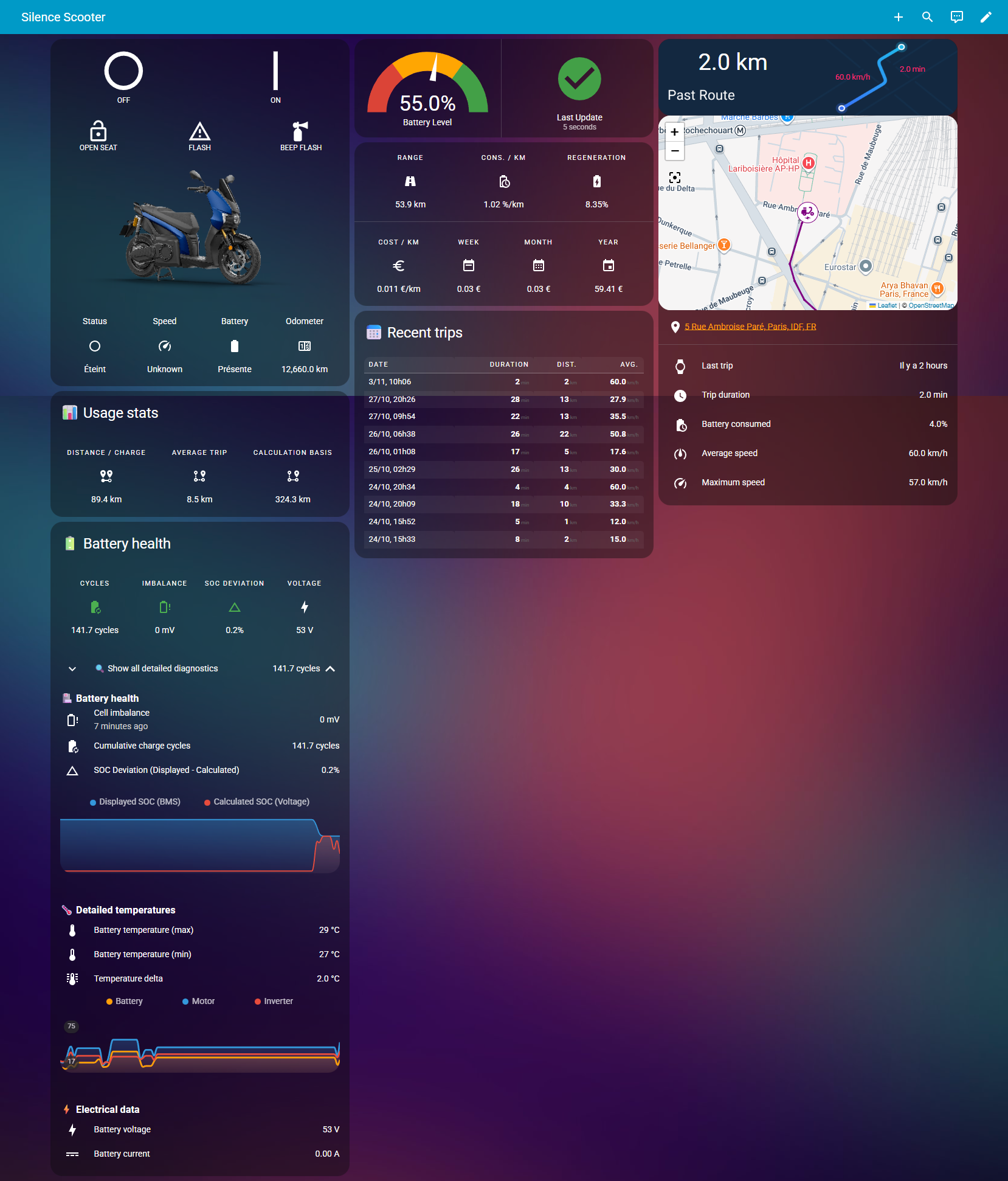

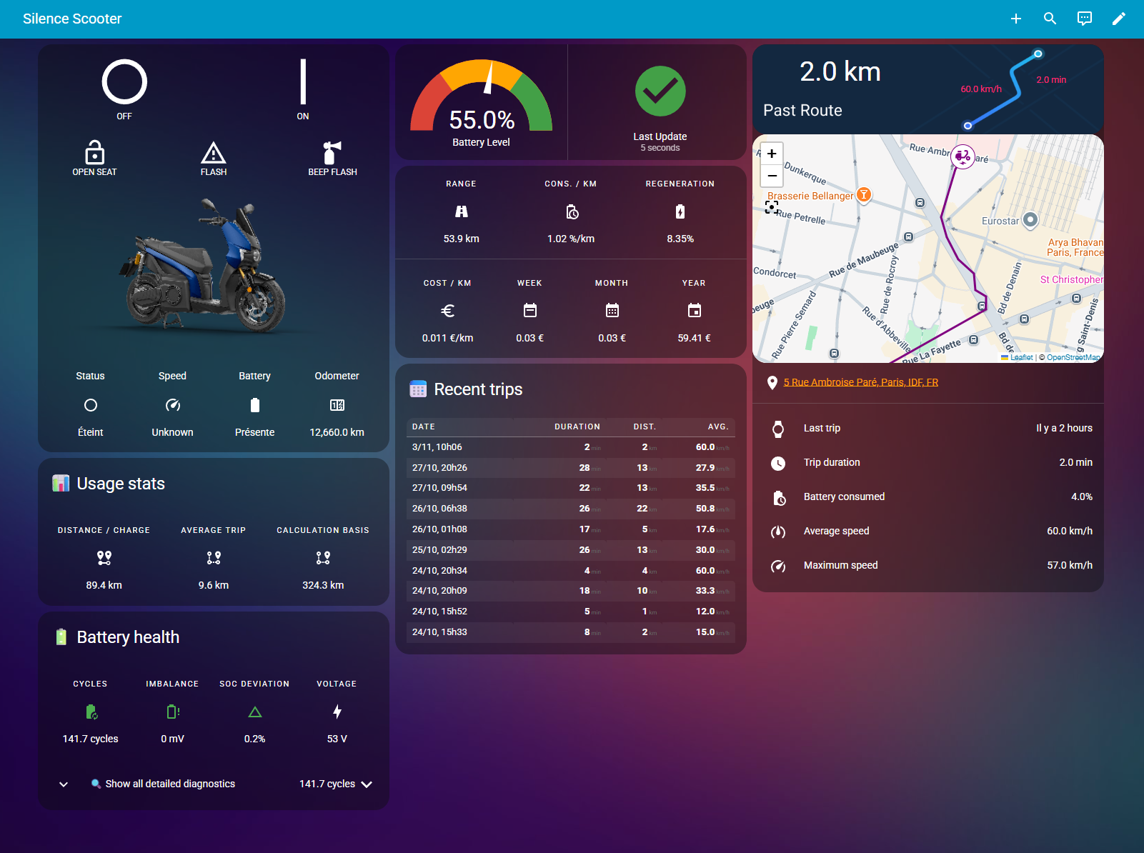

Hi everyone!
I'm excited to share with the community a brand new Home Assistant custom integration for our Silence/SEAT MÓ scooters!
Silence Scooter - Home Assistant Integration
This integration is built on top of the Silence Private Server and transforms your scooter into a true smart home device with advanced features.
First of all, I want to warmly thank @lorenzo-deluca for the incredible work on the Silence Private Server!
Without this amazing foundation, none of this would have been possible. Your dedication to reverse-engineering the Astra module and creating such a solid MQTT bridge is absolutely remarkable. The entire Silence community owes you a huge debt of gratitude!
Key Features
• Automatic trip tracking with intelligent pause detection
• Detailed metrics: distance, duration, average/max speed, battery consumption
• Energy cost calculation with daily/weekly/monthly/yearly utility meters
• Complete trip history with persistent storage
• Battery health monitoring and efficiency statistics
• Watchdog protection to handle connectivity loss (underground parking, etc.)
Compatible Models
• Silence S01 (50cc and 125cc equivalent)
• SEAT MÓ eScooter 50
• SEAT MÓ eScooter 125
All models equipped with the Astra telemetry module are fully supported!
Installation
The integration is HACS compatible for easy installation:
- Open HACS in your Home Assistant instance
- Go to "Integrations"
- Click the three dots menu → "Custom repositories"
- Add repository URL: https://github.com/noiwid/silence-scooter-homeassistant
- Select category: "Integration"
- Click "Install"
- Restart Home Assistant
Links
• GitHub Repository: https://github.com/noiwid/silence-scooter-homeassistant
• Complete documentation with dashboard screenshots
• Lovelace dashboard examples included
• Compatible with Home Assistant 2024.11.0+
Dashboard Preview
Screenshots:
Credits
Once again, a massive thank you to Lorenzo Deluca for making all of this possible with the Silence Private Server. Your work is truly inspiring!
Feel free to ask questions, report issues, or suggest improvements! I'm looking forward to hearing your feedback!
Cheers to the Silence scooter community!
