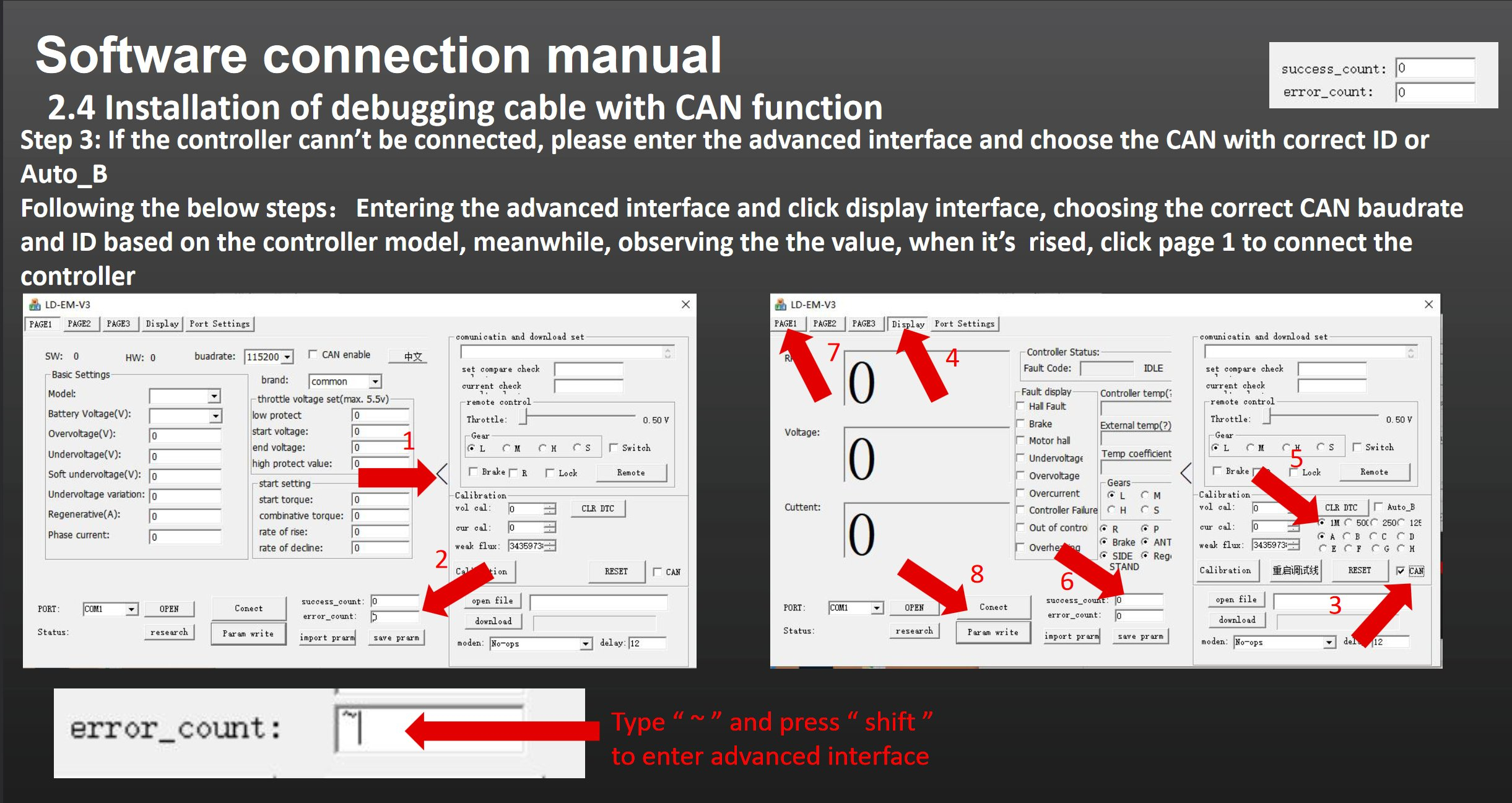

I'm VERY HAPPY for you! so there is hope for us all! :D
I tried again by waiting between clicks as you did but still nothing... however I discovered something interesting by reading a Votol manual, here is the slide.
I tried this with my Scooter by listening to the serial communication and actually staying on the DISPLAY page and changing the Baud, Auto_Baud and speed parameters sends a different command to the key. does the DISPLAY page work for you?

Lorenzo, you have my mail address. May you sent me the all pictures in this thread you uploaded @ibb.co? I'd like to have them in the forum's database 'cause external links often break after months or years. There's no need to upload them to any picture hoster.
Esp. the last picture should have a better resolution. :-)
At a first view it's interesting that they do not recommend to activate Auto_B settings, which is IMO essential for a working stick.
edit: Look at step 2: "~" followed by <SHIFT> (!) opens the secret menu without the need to switch to the ENG keyboard setting.!
Mit dieser Tastenfolge benötigt man den Umweg über die englische Tastatur nicht mehr!

In the slide it says "observing the value, when it's rised" but in my case that value has never changed during the process of reviving the sticks. Only when everything was done and I was reconnecting with the revived stick the value counted up. Maybe there's something happening in the background but that probably won't reflect in the "success_count" if you use "Auto_B" so you have to wait that time until you continue..? Just a thought...

lorenzo.deluca hat geschrieben:
So 22. Sep 2024, 11:46
If you're talking about seeing real-time data on the "DISPLAY" page, that doesn't work for me.

Try unchecking :!: the CAN checkbox near the communication speed on PAGE1, then reset the speed to 115k before connecting the scooter. Then change to DISPLAY. Success counter should rise rapidly and live data will appear. With CAN checked, I have no life data, too.

That worked. I see real-time data with unchecked CAN option :)
